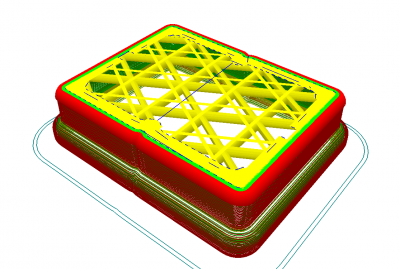

So: it prints!
Quality is really impressive, I bet they also changed some other stuff compared to the normal Cura.
I'm trying the 3D infill, it's like seeing crystals growing inside your print.
It's mesmerizing!
It's mesmerizing!

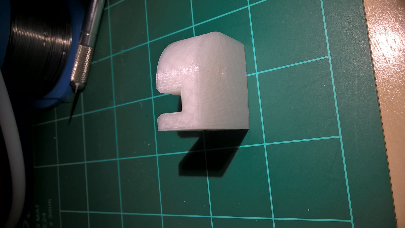

First print is out.
Printed with natural PLA 1.75mm at 210C with 3D infill and 0.2 layer height with a 0.4mm Ruby Nozzle.
It looks like a bee-hive...on all sides :O
The part feels extremely strong even on small bits.
There's a bit of warping on the base, but that's cause I'm still tuning the printer (and I don't have a hot bed).
It'll be fixed with tomorrow's series of tweaks.
Here's two pics taken with my mobile:

I must say 3D infill sound like a really quick hack to do in the CuraEngine. It could be nice to have but I don't think it's the most important feature to implement.
Looking at the layerview the implementation of this by Type A machines seems to be a mess.

The 3D Infill looks nice (even if it is obviosly not a stable implementation after looking carefully in the layerviews where random errors occur multiple times), i am printing a first print with it now, but what use does those other types of infill really have? The Gradient ones looked like crap to me, should have much less strength than just a regular low infill since it does not connect well at any layer at all?

Also the infill seems like a quite buggy hack, step trough the layers with 3D infill carefully in layer view, and you will see that you got random "layer shifting" of the infill wich compromises the infill strength quite often (or is this a feature?):
