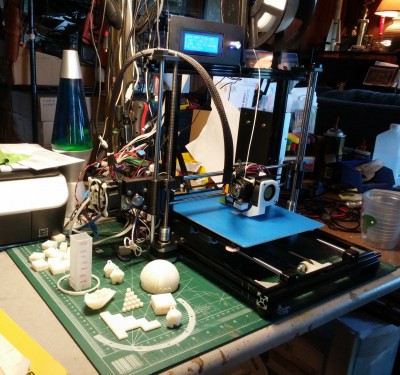

Latest calibration object farm and mine printing the 20mm-box from the Essential Calibration set:
http://www.thingiverse.com/thing:5573
Your on the right track, good luck!
