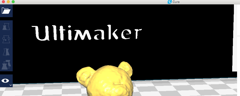

Drawing artifacts. Typically the 'Ultimaker' backround will go black for a split second when you change a parameter or hover something, giving a 'screen flash effect'.nallath wrote:I don't really understand what you mean by this. Could you be more specific what you don't like / mean?Amedee wrote: The UI is 'flashing' a lot for no reason, this is very disturbing
It is not the only part going 'black' at random, but that one I can reproduce easily

Those are graphic driver issues.Amedee wrote: Drawing artifacts. Typically the 'Ultimaker' backround will go black for a split second when you change a parameter or hover something, giving a 'screen flash effect'.
Re: Cura 2.1 open beta
That's an easy answernallath wrote:Those are graphic driver issues.
When I have a problem on 2 different platforms with a specific product and not with anything else, I wouldn't put that on the graphic driver side

I also faced this behavior on my Win64 Dell notebook...Amedee wrote:That's an easy answernallath wrote:Those are graphic driver issues.
I used the easy answer as we had exactly the same problem on one of our testing machines, where updating the drivers helped. You guys are right that just because it fixed it there, doesn't mean its always the solution.
The Max/OSX golden cage is far from being perfect, but when you encounter such issue on 2 different machine type and 2 different OSX versions, it is very unlikely that it could be the driver. I would think more of an issue of the graphic libraries (Qt?) on Mac...
... but then if it reproduces on Windows as well...
