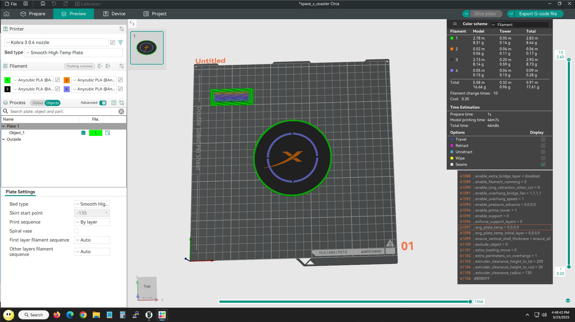

Here we have a Painted object shown in the photo below.
If the Painted is in Object mode then they will have a place to select/change the filament.
Painted Object
Else if they do not have, then the filament will not change in this global mode.

I found a work around.
If you load your model into Bambu Studio create all the Painted surfaces and save to 3MF file
Reload model into Orca Slicer 2.3.0-RC change to your Kobra 3 and filament profiles slice and save to USB flash drive then print with Kobra 3.
