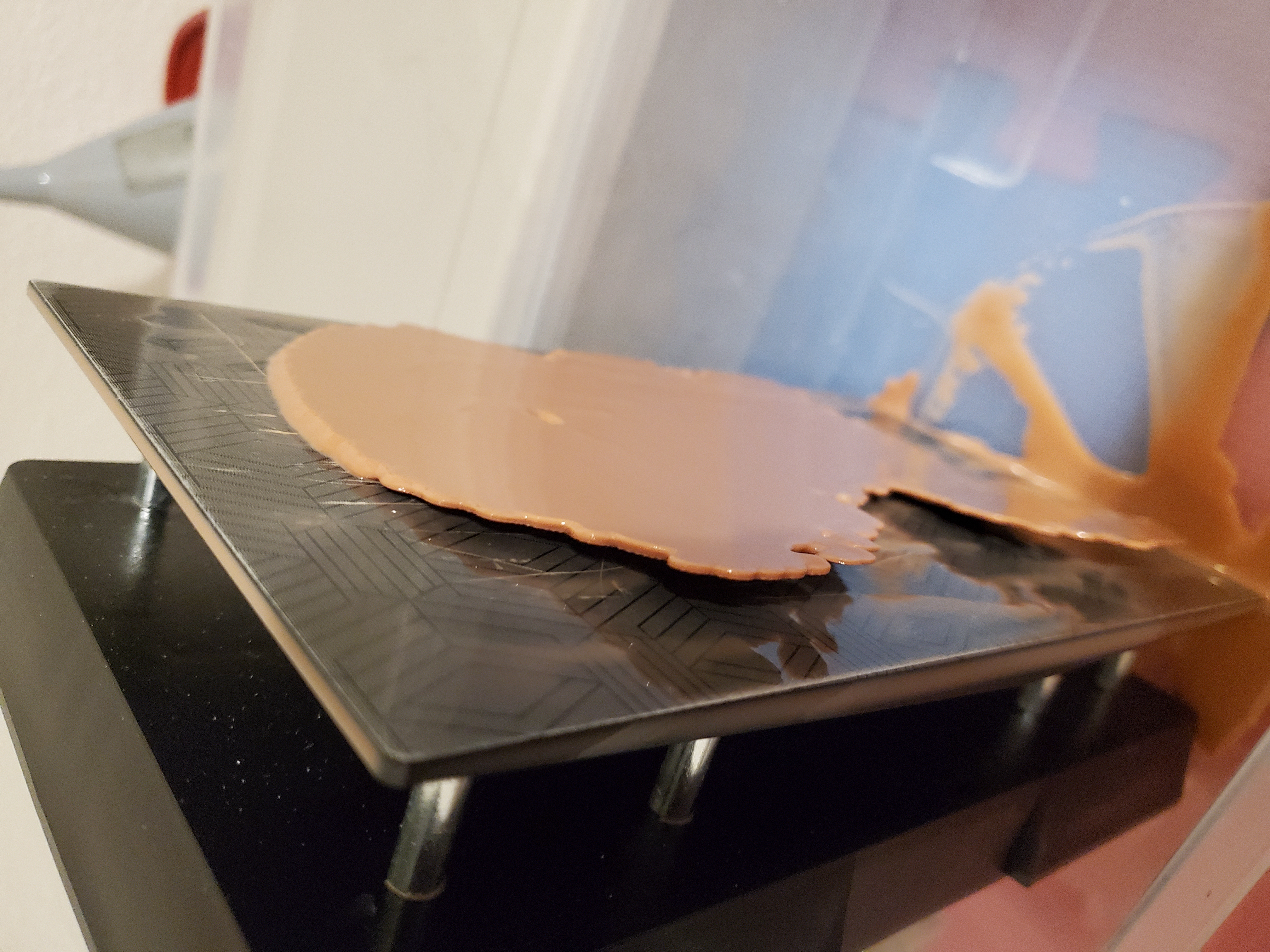

hey,
i'm using Elegoo 8k Red Clay Resin that keeps peeling off the plate. The only thing i can think of is the Temp. Mid 60's
Could temp really make that happen?
Standard Elegoo Resin no problem btw
Slow Speed
Mars Ultra 4
Layer Height .040
Exposure 3.5
Bottom Layer Count 5
Bottom Exposure 60
bottom and Lift Distance 4-6
Slow Speed
Mars Ultra 4
Layer Height .040
Exposure 3.5
Bottom Exposure 60

It could be the temperature, I've had problems when the printer was cold. I think they say it should be at least 20°C.

thanks Lez0,
it's gotta be right? 60 bottom exposure should secure anything.

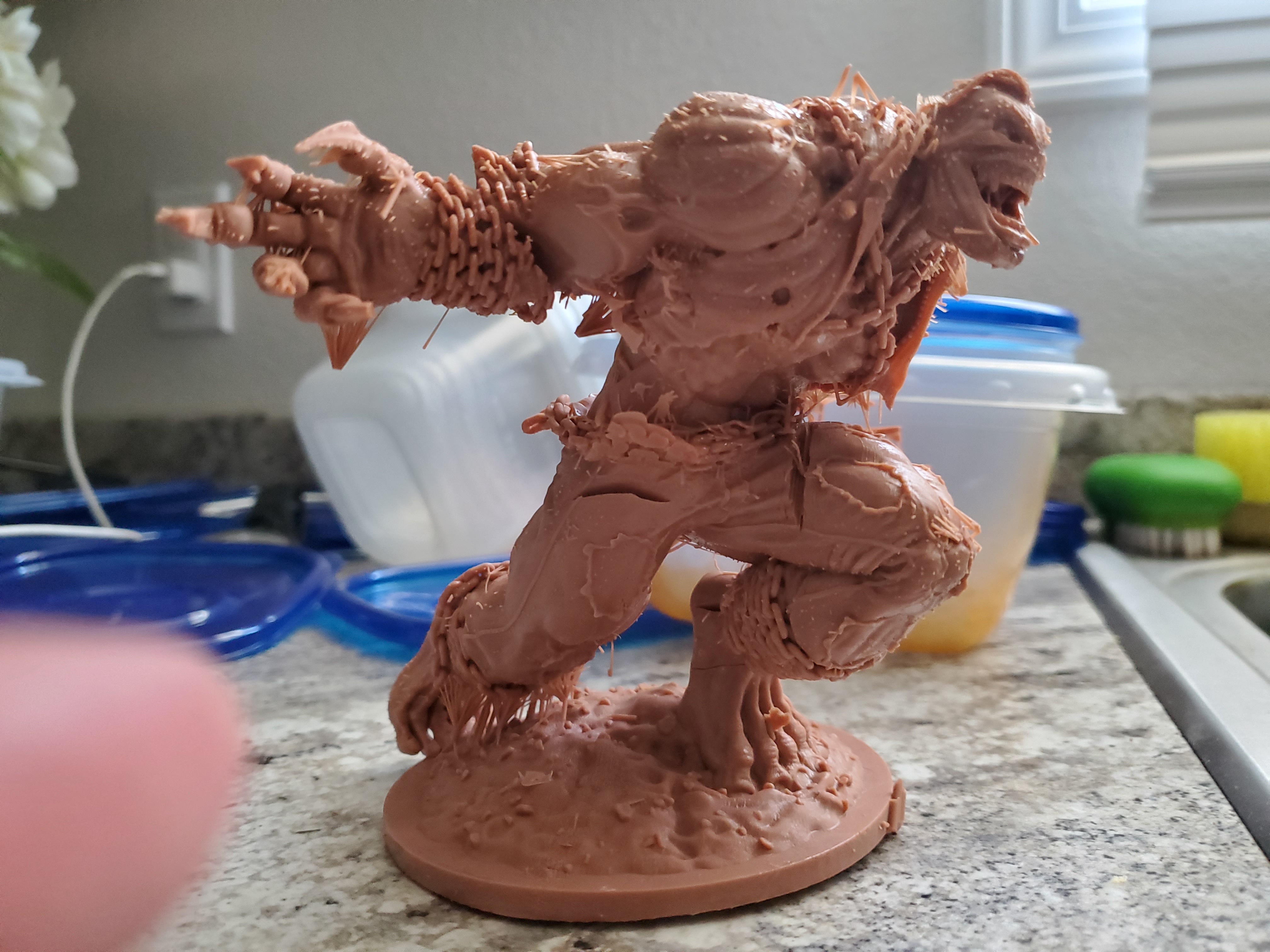

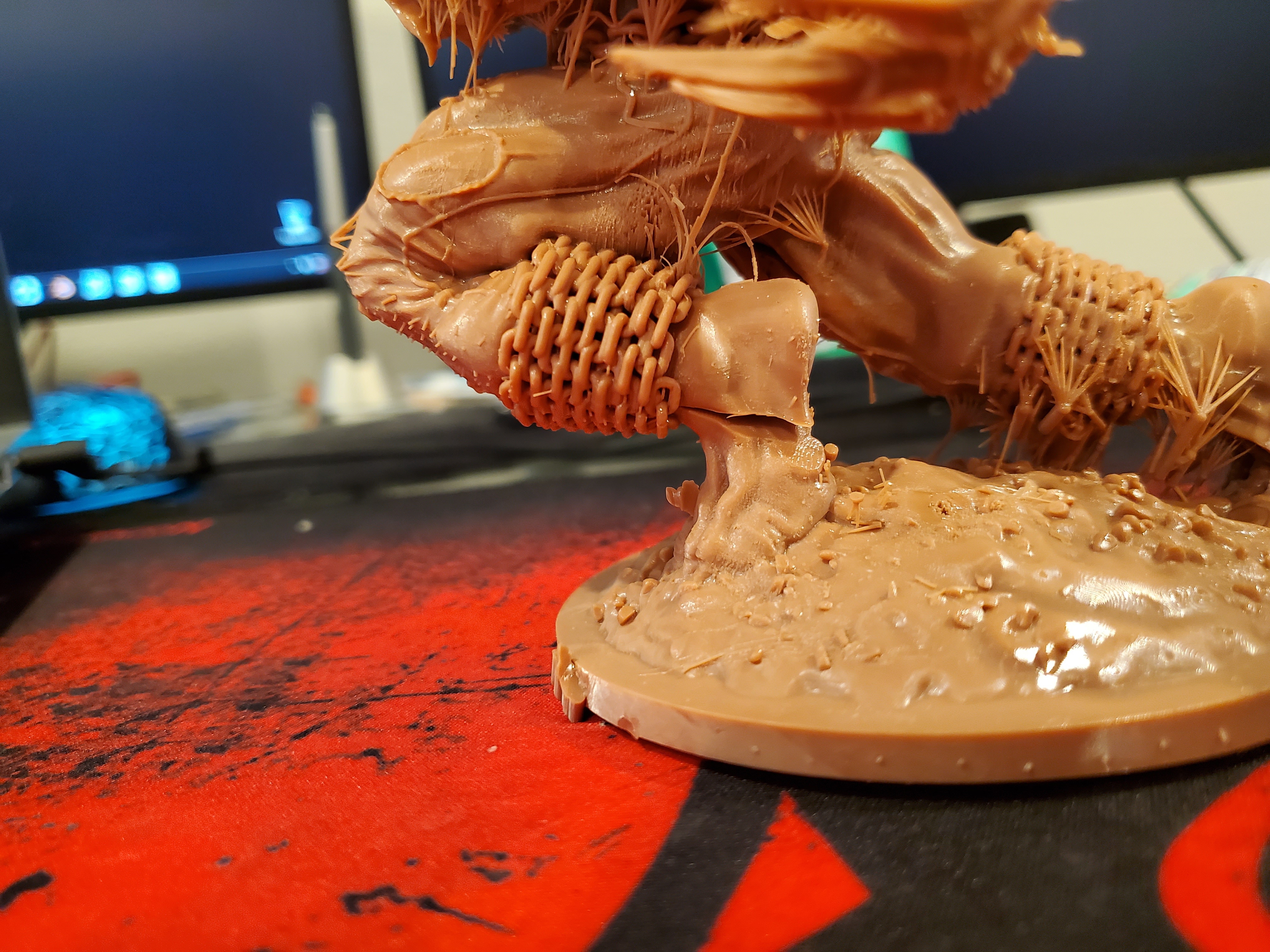

tried it again, with a different Model at 19.4 degrees Celsius/67 degrees F. and i upped the bottom exposure to 75
Got Exactly the same result. the Pics also show the rear side of the Model is always where it's peeling off
Slow Speed
Mars Ultra 4
Layer Height .040
Exposure 3.5
Bottom Exposure 75

- Posts: 457
Re: 8k Elegoo Resin won't stick to the plate
Is it only with this part you have problems.
You say you printed this part with Elegoo standard resin OK?
Do you have an image of the model?
