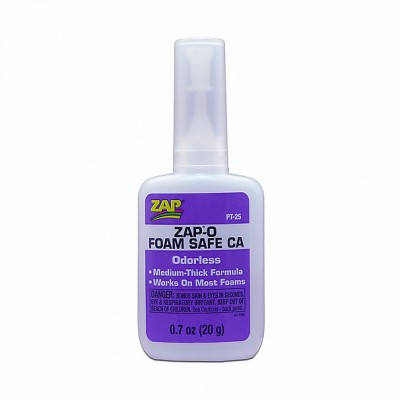

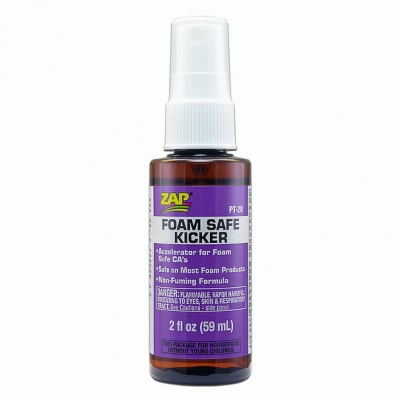

Re: What to use to glue/chemical weld different filament types
We always glue PLA, PLA/PHA, nGEN with CA glue. It still works when you mix these types.
I like the 'Purple' one from Zap (Both CA glue and accelerator) because these are less 'aggressive' (foam-safe) and are odorless.
All our gasometer was glued with it.

Great, and I can buy it in Sweden. I will put this on my list to try asapAmedee wrote:I like the 'Purple' one from Zap (Both CA glue and accelerator) because these are less 'aggressive' (foam-safe) and are odorless.
(I found some hints to other types of glue but those were banned in Sweden.)

The CA glue and Kickstarter is good stuff....used it to put together my (ABS) Stormtrooper armor (Have to glue trim pieces and snap plates)

@nilrog: How much is the Zap Purple in Sweden and where do you get it from there?
