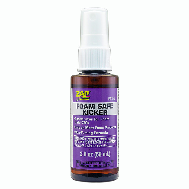

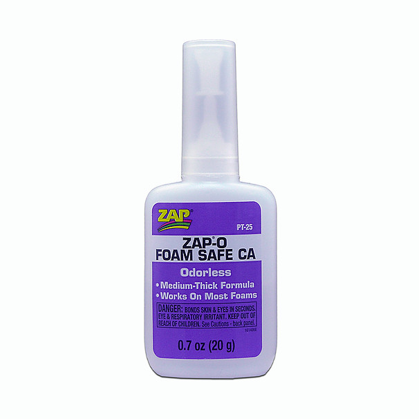

We always glue PLA, PLA/PHA, nGEN with CA glue. It still works when you mix these types.
I like the 'Purple' one from Zap (Both CA glue and accelerator) because these are less 'aggressive' (foam-safe) and are odorless.
All our gasometer was glued with it.
Purple CA
Purple CA
Purple Accelerator
Purple Accelerator

Amedee wrote:I like the 'Purple' one from Zap (Both CA glue and accelerator) because these are less 'aggressive' (foam-safe) and are odorless.
Great, and I can buy it in Sweden. I will put this on my list to try asap :)
