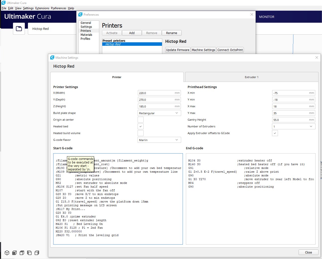

Posts: 1480
Re: Cura Machine Settings G-Codes
In Cura Click on Preferences select Printers
Select Machine Settings.
You will see the settings used in my Hictop 3D Printers
Below is the code line you want.
Code: Select all
G1 X0 Y270                      ;move extruder to rear left, Model to front.
Posts: 1480
I should have noted that not all Hictop 3D Printers have the 220 X 270 Bed surface.
