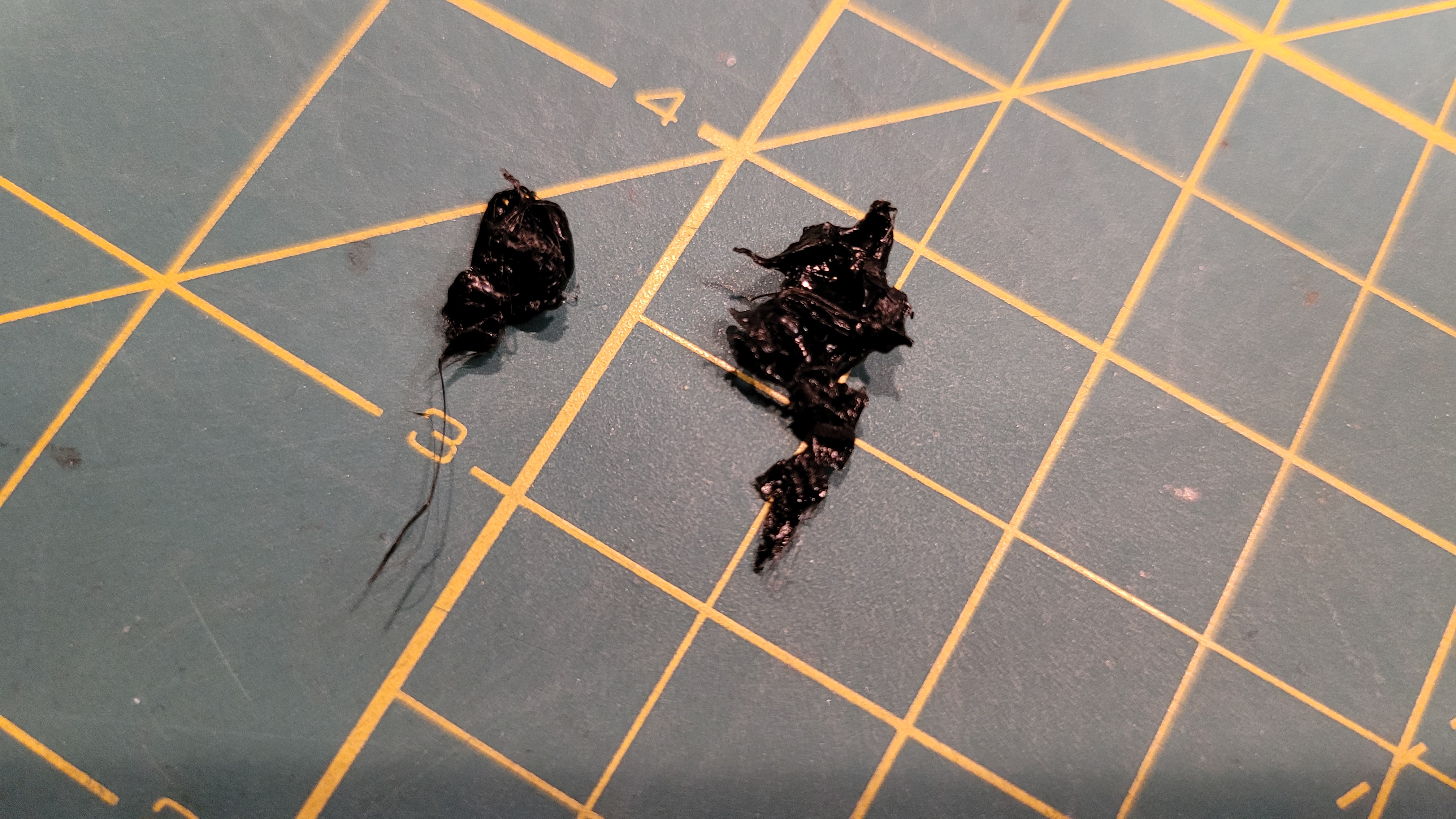

I recently replaced my stock Ender 3 Pro hotend with an all metal one. I'm noticing an anomaly that did not exist before and wondering what is possibly causing it. After about 20 minutes of printing I notice a glob of melted filament that gathers around the nozzle and ultimately will break loose, or parts of may lodge in my print. For the most part, they are just a nuisance. Once one breaks free another one will start to form and the cycle continues. The new hotend is using a metal nozzle, while my original nozzle was brass. I'd like to know what's likely causing this and correct it. See image of a typical glob - normally about the size of my pinky nail.

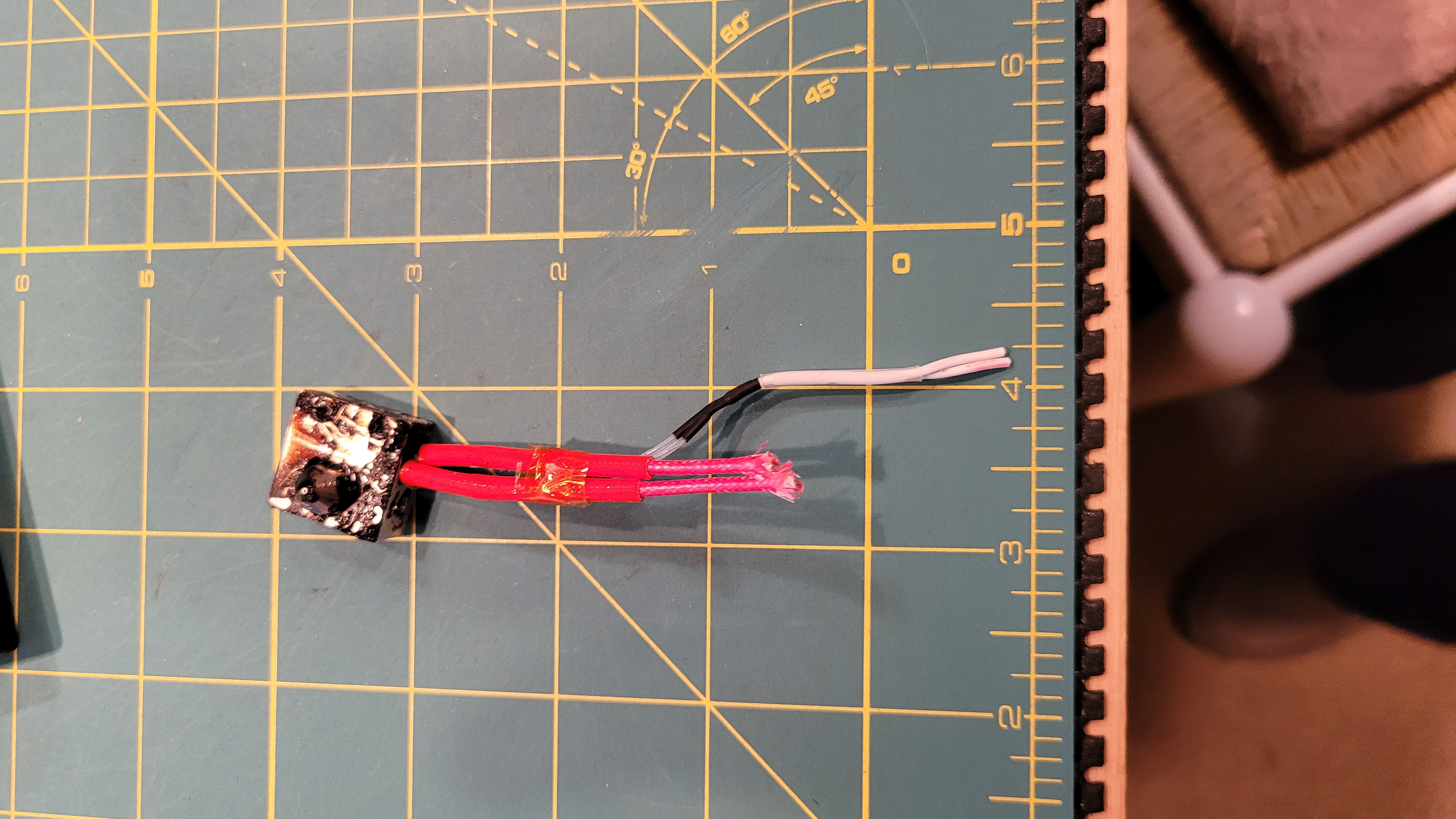

After I thought this was fixed, I still had issues. I removed the hot end and the heater block and what a surprise! I cleaned it up a bit, but in the end I decided to replace my heater block, heating element, heat brake, thermistor and nozzle(I had several). I was able to salvage the heat-sink. When I originally upgrade to the MicroSwiss hotend, I had meticulously installed everything per the instructions. I guess not meticulously enough.
