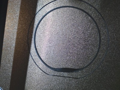

I'm trying to print some vessels, basically a cup to make a silicone mold for concrete reproductions. First layer is being wonky at one side. I tried several variations of the stl and they all did the same thing.

That's very interestng that one side is flattening out. Check the belts? Something is up in the motion system

Thanks for the help. One of the wheels under the build plate was a little loose. I tightened it up and no more wobbly board. Seems to have fixed the problem.
