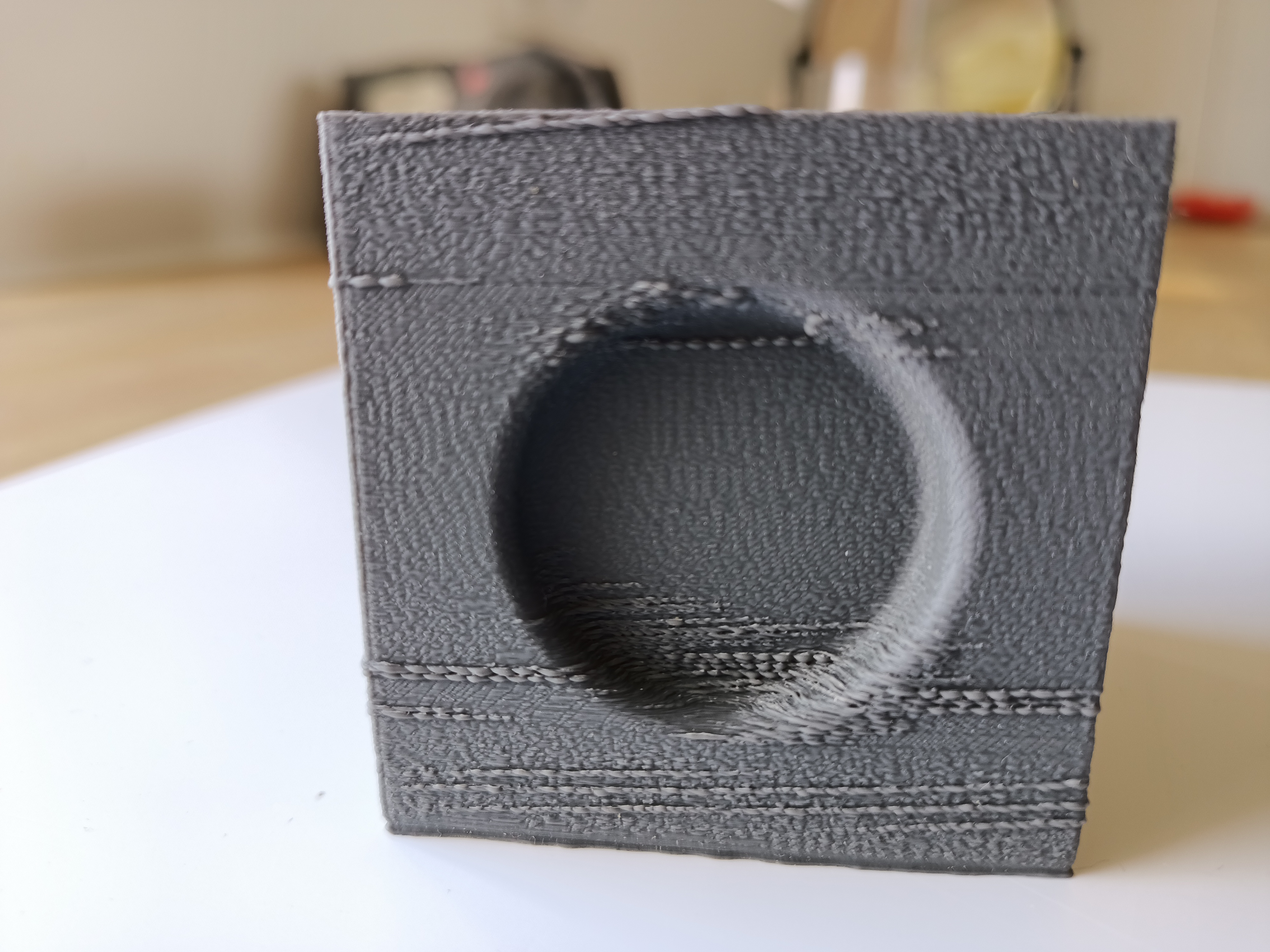

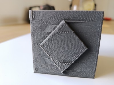

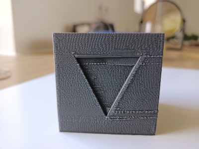

Suddenly, without any reason, my prints started to look terrible.
I do not recall to change anything in my Cura setup. Already have tried different filaments and speeds...
Can you recognize the problem from the attached pictures?

If I have a problem I always check to see if the nozzle is blocked, try changing it to see.

Hi Lez and thanks ...
The nozzle is clean, I just have put one...

Check your esteps then work up to flow settings
https://mattshub.com/blogs/blog/extruder-calibration
