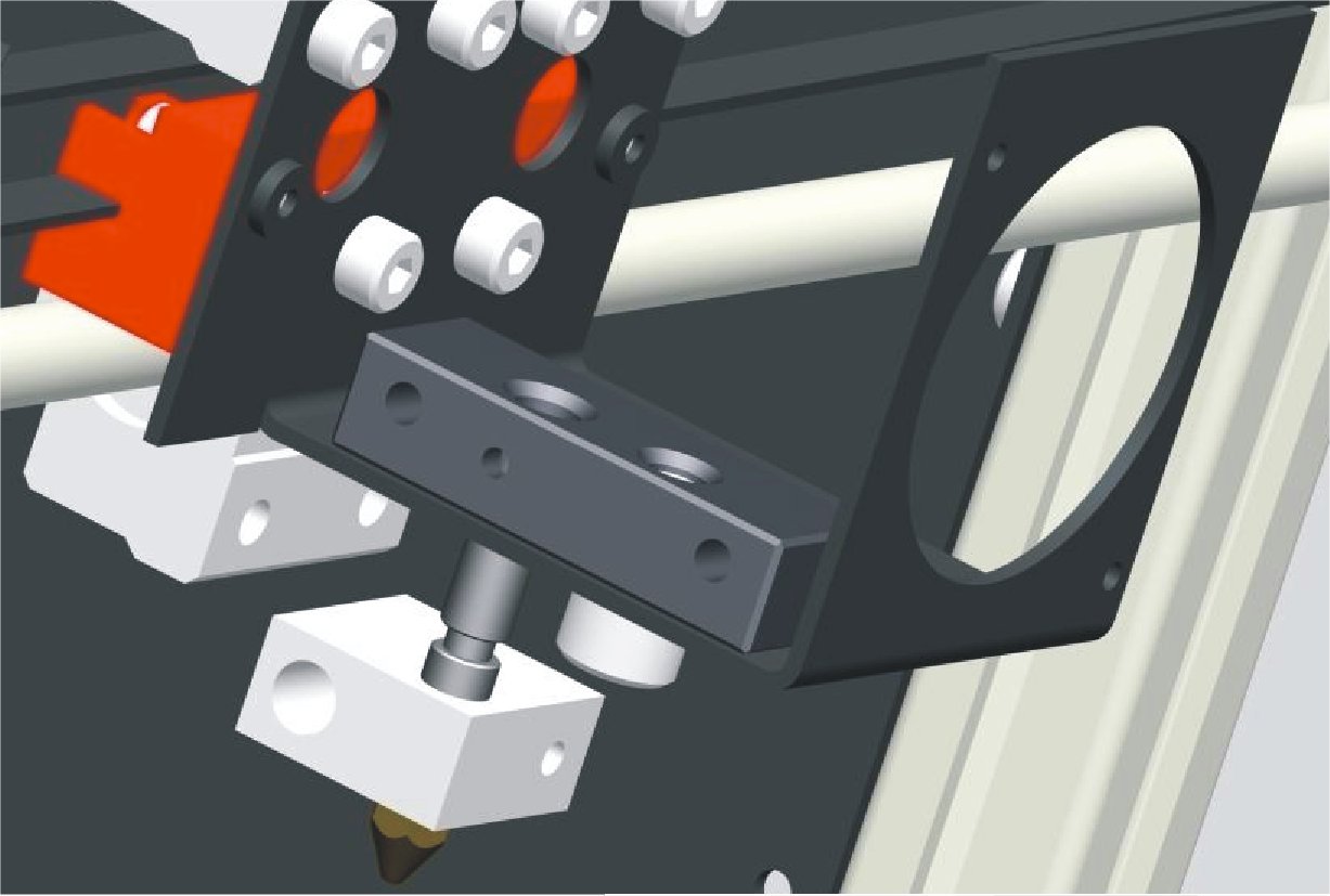

Thinking that with my modified Duct and cooling 2 fin heat sink on the PTFE throat I could remove the left side fan and heat sink.
I believe the Front Fan an duct should cool more than enough
The Image Below shows the perfect location to mount a 3D / BL Tough on the stepper motor mount Aluminum hotend upper chamber.
