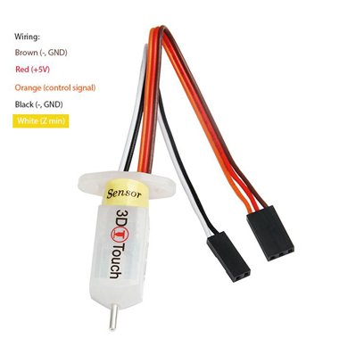

3-pin: Brown (-, GND), Red (+5V), Orange (control signal) (Z-Max)
2-pin: Black (-, GND), White (Z min)
3D Touch.jpg (16.16 KiB) Viewed 38745 times
Making sure the pin configuration is correct.
Connect the 3 pin wire to the Z max pin.
Connect the 2 pin wire to the Z min pin.
Marlin Code Changes

Roberts_Clif wrote: September 8th, 2020, 9:39 am 3-pin: Brown (-, GND), Red (+5V), Orange (control signal) (Z-Max)
Marlin Code Changes

Ordered a single unit will test to see if my pins are correct. Using my MPCNC with an Arduino Mega and Ramps 1.6
Posts: 1494
Re: 3D Touch for Hictop
Today the 3D Touch showed up, quickly opened to take a quick look see what my money had purchased.
It looks pretty good, came with packaged like a Cadillac mounting a pair of screws four 3 pin, two 2 pin housings and pins
plus male pins for extending the wire harnesses.
It was at this time I decided to power it up and let it do a self test using a variable power supply adjusted to 5volts,
it failed the test with light flashing and blinking non stop the pin refused any movement except to flutter uncontrollably
and never successfully completed any part of the self test. It was as though it was struggling to operating with reduced power.
So I downloaded the online manual from geeetech.com. Verifying that the supply voltage needed was indeed 5volt @ 300mA max current.
3D Touch.jpg (16.16 KiB) Viewed 38580 times
I decided to try to adjust the supply voltage just a little to 5.6 Volts input now it started to act like it was designed,
although the supply voltage was no longer at the recommended voltage of 5volts. This is OK as I have some adjustable
DC to DC Step Down Adjustable Buck Converter Power Modules.
