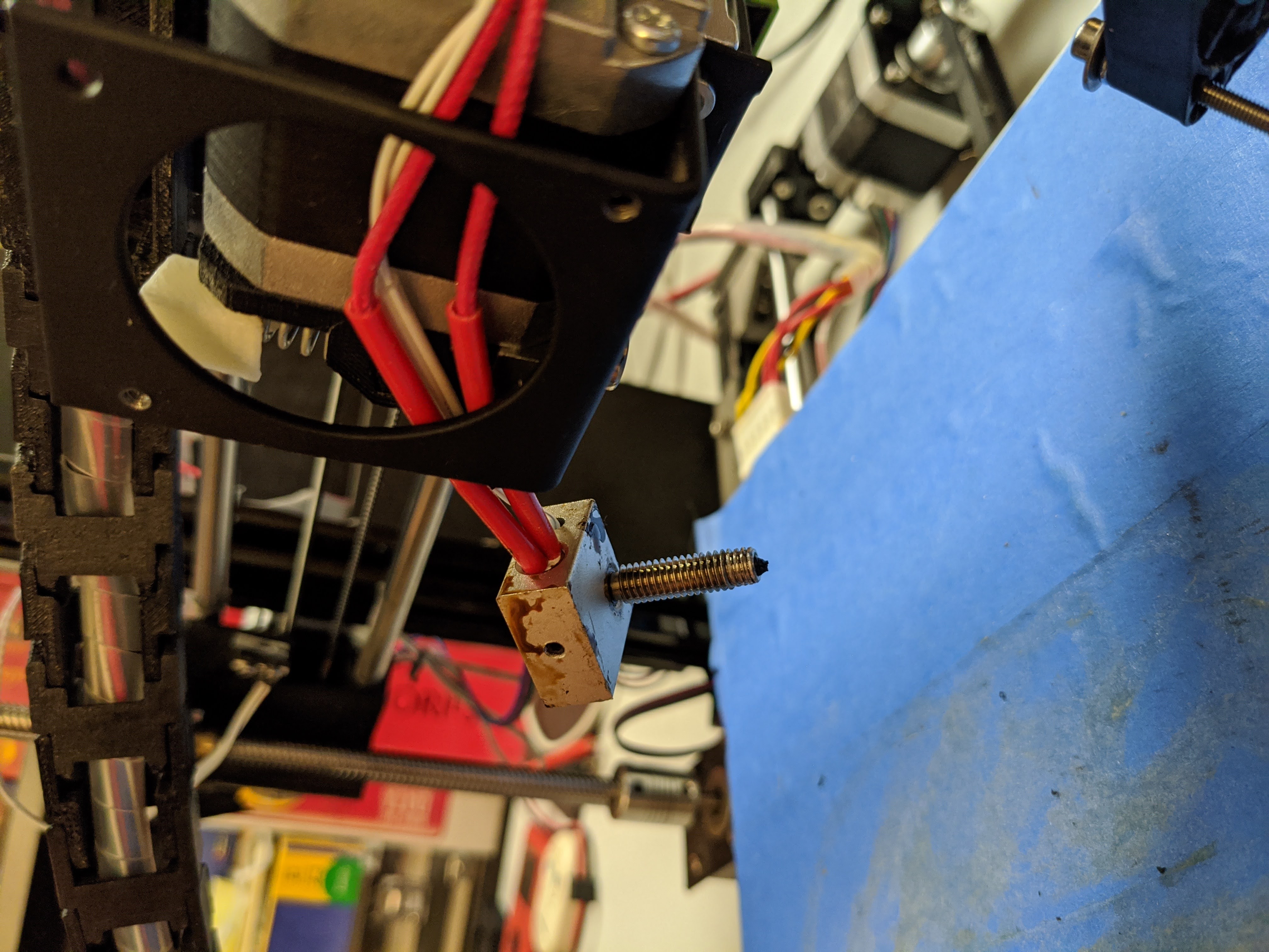

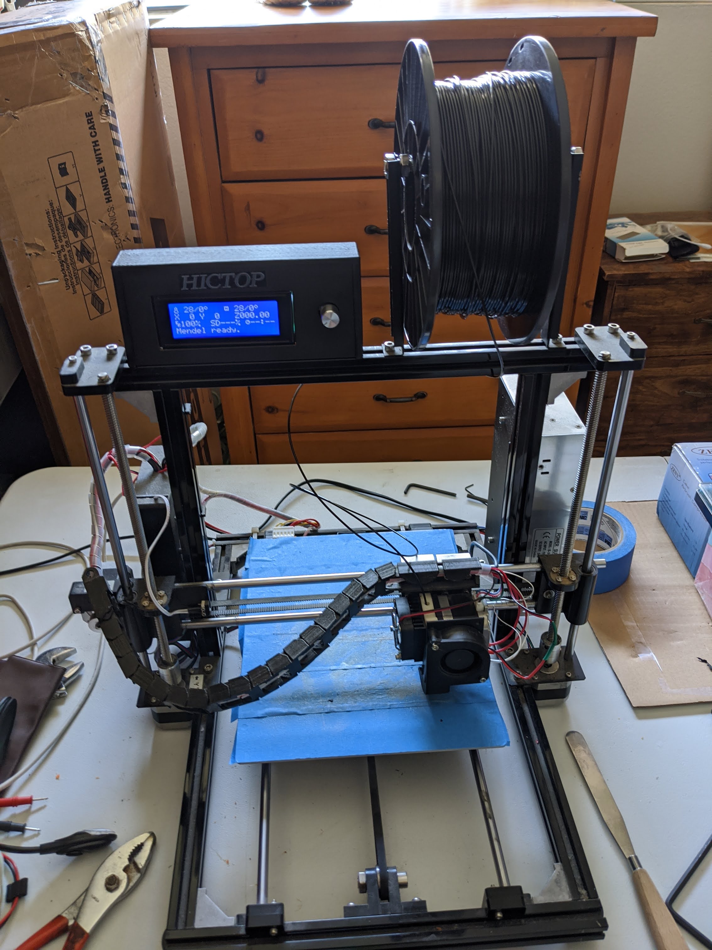

Got a used 3D printer from a friend, have yet to get it to work well, usually it doesn't work at all. Tried switching to fresher filament but it clogged my "nozzle". I can remove the heating element and thermoresister but the nozzle/heating block/threaded guide tube are inseparable (I've stripped the tube and nozzle a bit trying to separate them. Tried heating with a lighter and got some of the black filament to melt and drip out. Soaked overnight in acetone and when I reattached and heated to 240C a little more black filament came through nozzle and some out back of tube. Tried printing but only getting small amounts of very sporadic filament flowing through, I'm not sure these parts are salvageable. Any ideas on how I could clean them? I'm very new to 3D printing and very unsure of the nomenclature, where could I find replacement parts for these (Hictop 3DP12 I think). Maybe this would be a good chance to install a double or triple extruder?
On a separate note I tried upgrading Marlin, but had a problem with the Z axis. It sounded horrible, I got the impression that a software error had the limit switches trying to stop every z motion (no problems with X and Y). Was upgraded with magnetic limit switch on Z so maybe I need some special code for that? Still using the stock Marlin from Hictop website....

Though Looking at your Photo's it appears you have a Clogged 3D Printer M6*26mm Nozzle Throat.

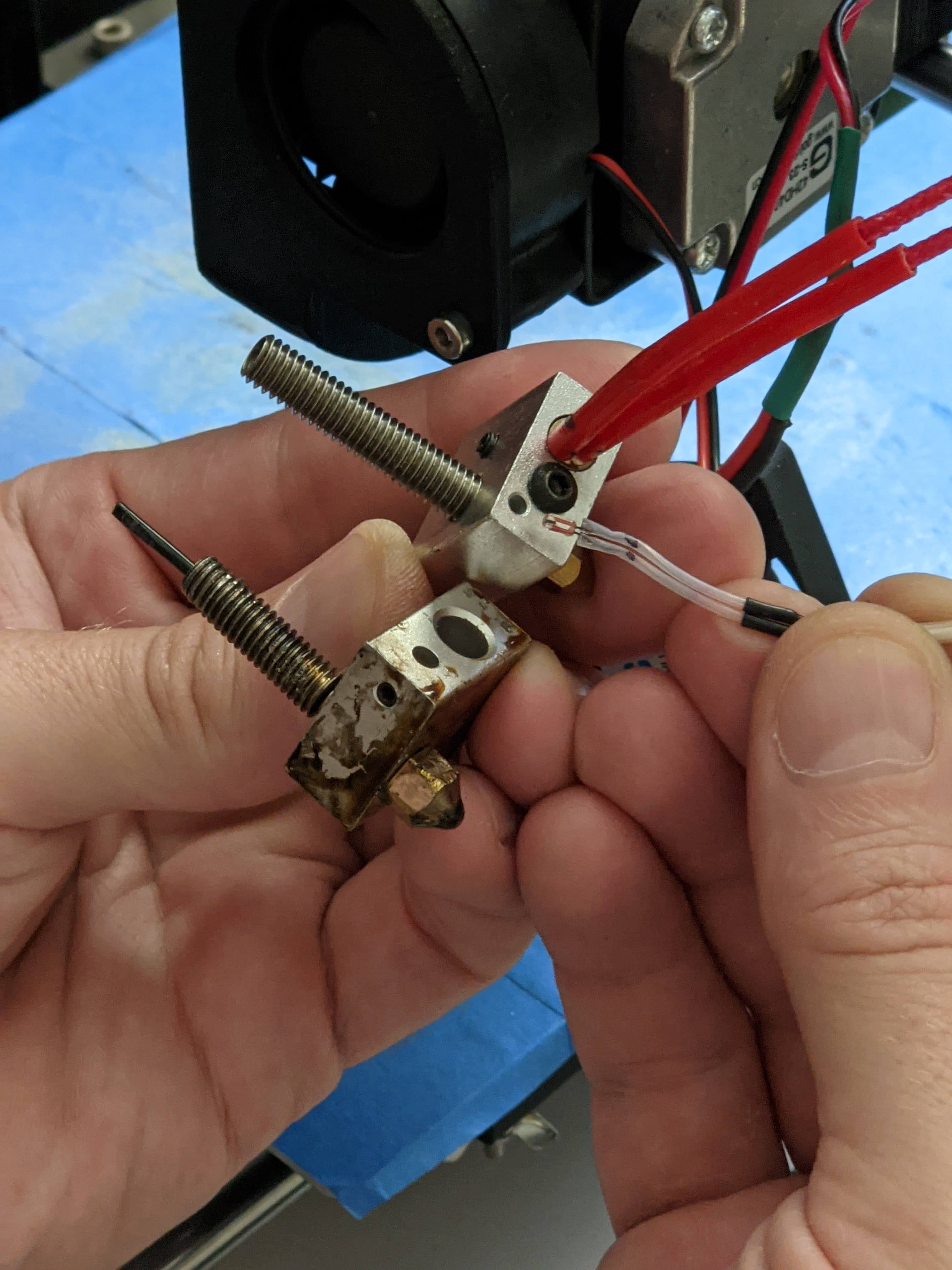

Thanks for the clue to the correct part names! I needed a little more than just the throat so I ordered this: https://www.aliexpress.com/item/3297003 ... GHO1b&mp=1 Ebay wasn't significantly faster and Ali is cheaper! Will give me time to build the ikea table enclosure

Well I wish I had an industrial oven, how are you using the soldering iron to fix it LePaul?
Just got the new heat blocks which are pretty close, except on the old block there was a large hole for the thermosister and a small set screw on the adjacent side. The new one is puzzling me, I think the thermosister is supposed to go in the small hole and the big black thing is a set screw and I just need a different hex in order to be able to adjust it? I can't quite figure it out, they both look like dead end hole, I can kinda just let the thermosister sit in the smaller hole, but it will easily fall out and that would be bad... Help?

Loosen the hex screw, insert the thermister into smaller hole route the wires one each side of the set screw and snug set screw.
The thermister should be bottomed out in the small hole, while the set screw holds the thernister wires as to not allow the thernister movement.

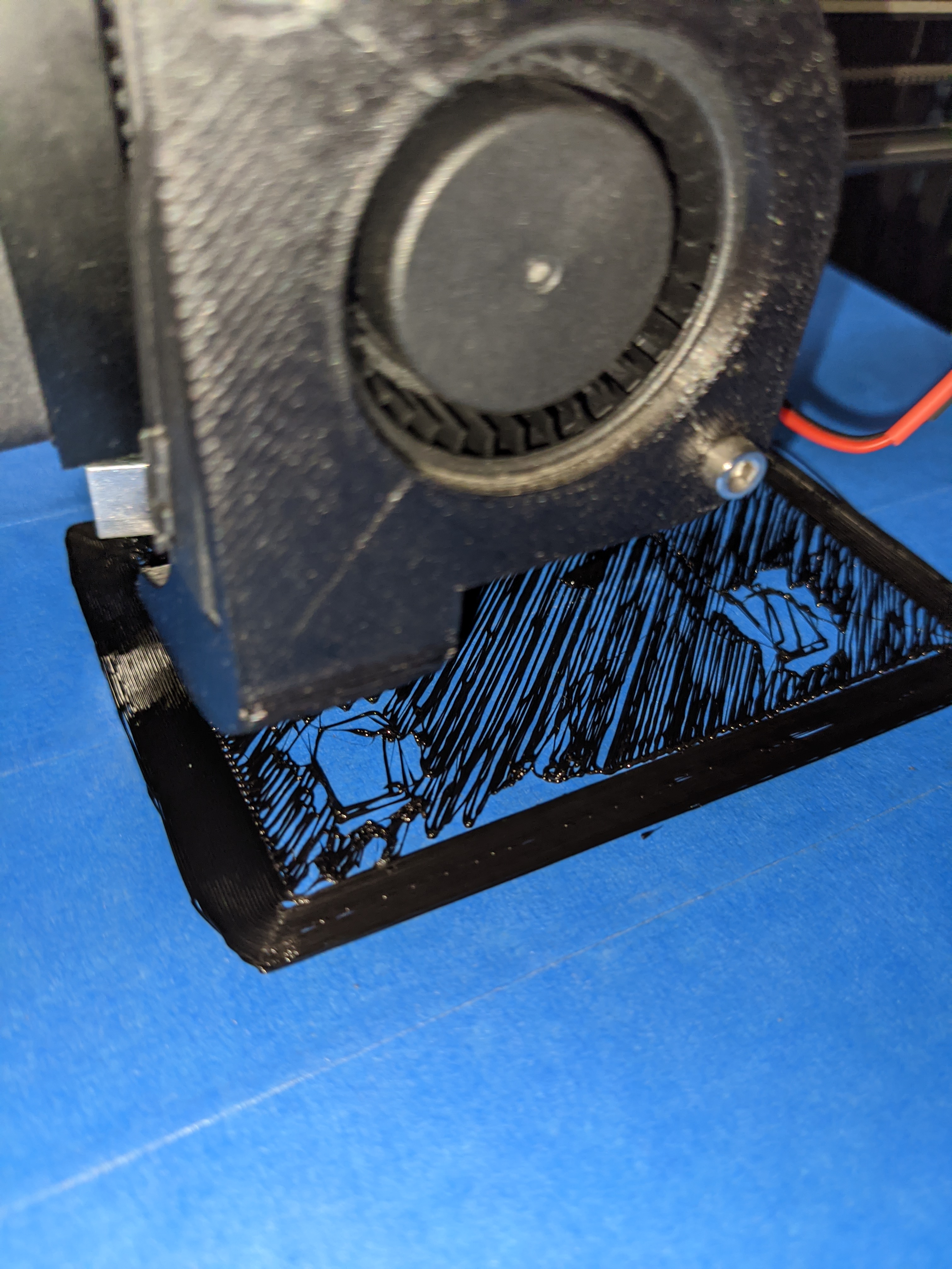

Well thanks for the help! I'm now printing again. New throats were longer then the previous ones so I wedged a random part under the motor because the z limit didn't have enough range to compensate. Now I'm back to figuring out how to make a print work. My first layers don't stick well and my prints lift after about an hour, ruining anything but a tiny print. My skirt is ok except for very round corners and barely sticking ( hairspray seems to work a little better than glue sticks) but the first layer of my print inside the skirt is jagged lines instead of solid (extrusion too slow?) I think I've got to optimize everything but I don't know how to organize and where to begin. Is there a guide your guys could refer me to for an organized way too optimize printing? Do you always have to optimize everything for every spool, or every single time you change spools?
Thanks for the help, it's still an uphill battle with this thing, but at least I've won one battle...

That looks like a first layer height adjustment issue. The layer height test prints that I do prints a box in each corner, then fills it in with lines. If the print head is at the perfect height, the lines blend together and it ends up with the bottom as smooth as glass. With the head too high, I get lines similar to yours.

It does help. Turns out I'm actually much more naive than I thought. Turns out the problem was a lot to do with z not being close enough as pointed out (took me a while to get there though...) Now instead of a spacer and a rickshift print head I just added a z offset into the g code for the longer nozzle (3mm!) Next I figured out that my print head wasn't tight enough and molten globs were randomly oozing around, I think tightening while hot is working ok... Print I have going now is for the top hinges for the ikea lak enclosure... Looks like my bed isn't entirely level (should have been suspicious-er when one of my hot bed leveling wing nuts fell off). So at least one of the prints of going to be poor, but the magnetic hinges are passable... So, progress... Slowly...
