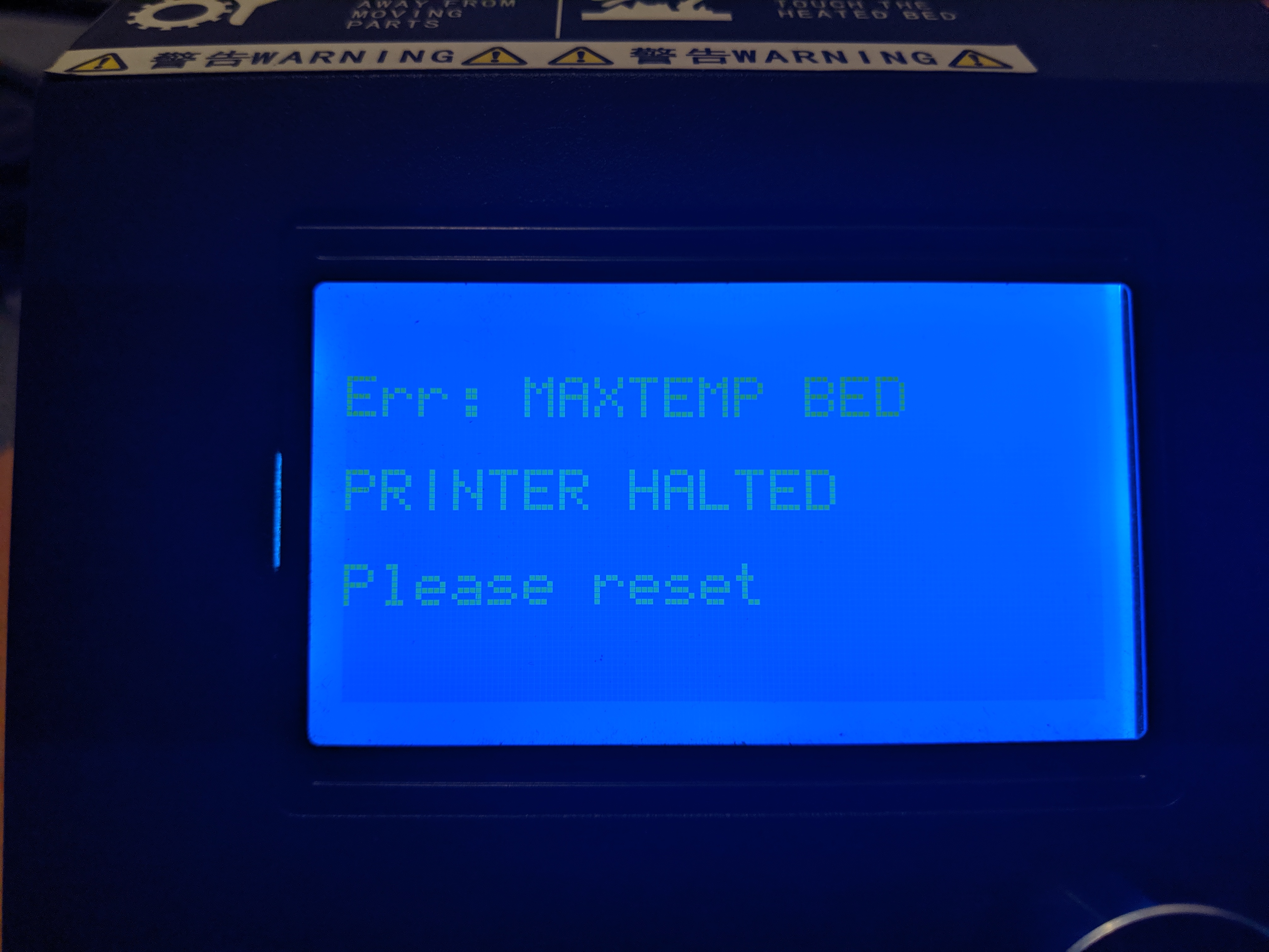

Hi All,
I have a CR10 S5 and i'm having trouble with the bed temp. The bed temp always reads as 236 degrees even when target is set to 0. I have even unplugged everything from the controller so it is not connected to the printer at all and it still thinks the temp is 236. Andy time I try to preheat it, or move any axis is get a MAXTEMP BED error.
I have tried re flashing the firmware with two different versions but to no avail. Is my board dead?
MAXTEMP BED Error

I have posted an example of Open and Shorted temps before here
Your photos shows it thinks you have a low resistance thermister across the bed Thermister connectors pins.
Or
You have chosen the wrong thermister firmware settings.
Or
It could also be a bad pull-up resistor shorted capacitor in the Thermister input circuit.
Or
A any kind of a lower resistant short in this circuit.
Or
Or
Or

Hi,
I have removed the board from the control box and unplugged everything except the LCD and power in, I have also connected it to a different power supply to take out as many variables as possible.
I just flashed the firmware using TH3D Unified Firmware Package and it is definitely set as the right board. Still getting the same fault although it now shows 221 instead of 236
The board itself looks okay, do bent or damaged capacitors or pins.
I think it must be a fault with the board.
