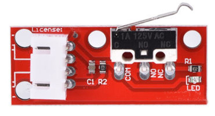

Using these End Stop Switches.

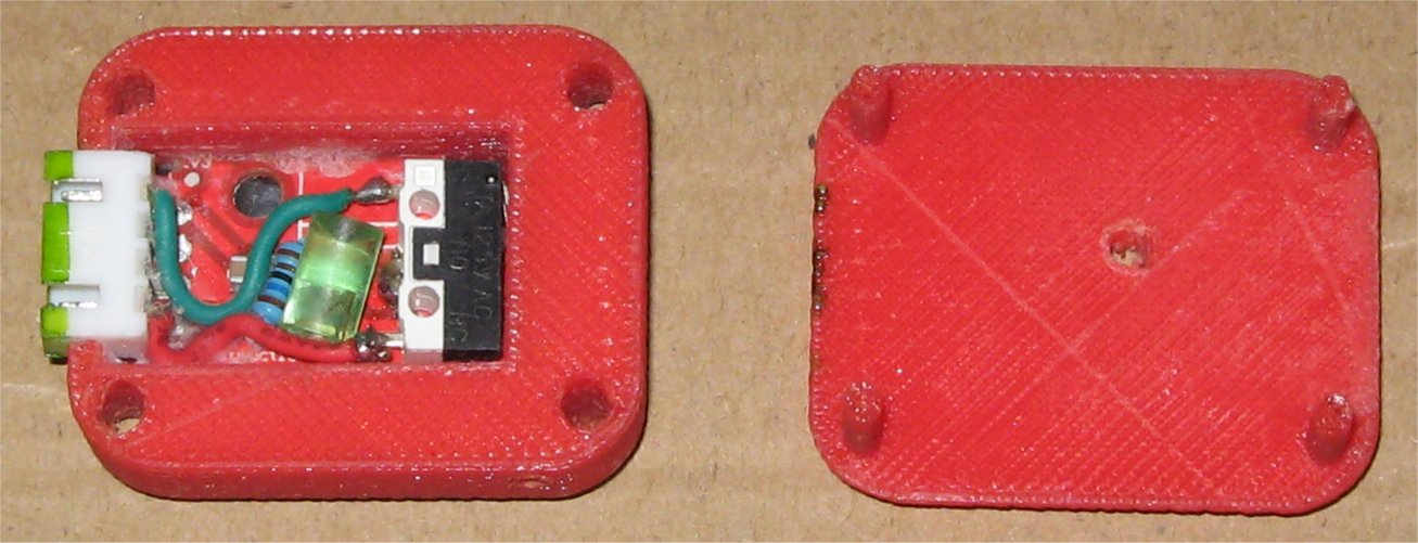

I have already made a Filament Run-Out Sensor from the top switch. This requires some work to reduce the size and rewire the LED.

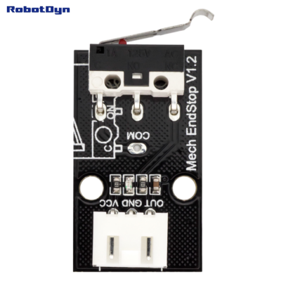

I have purchased the RobotDyn End-Stop switches this will still require some modification to reach a usable size.
Though I still want a smaller Filament Run-out Switch Assembly than the one I have already made below.

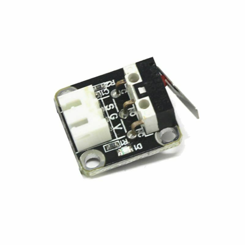

I will be ordering the Smallest End-stop switch with an LED Below.

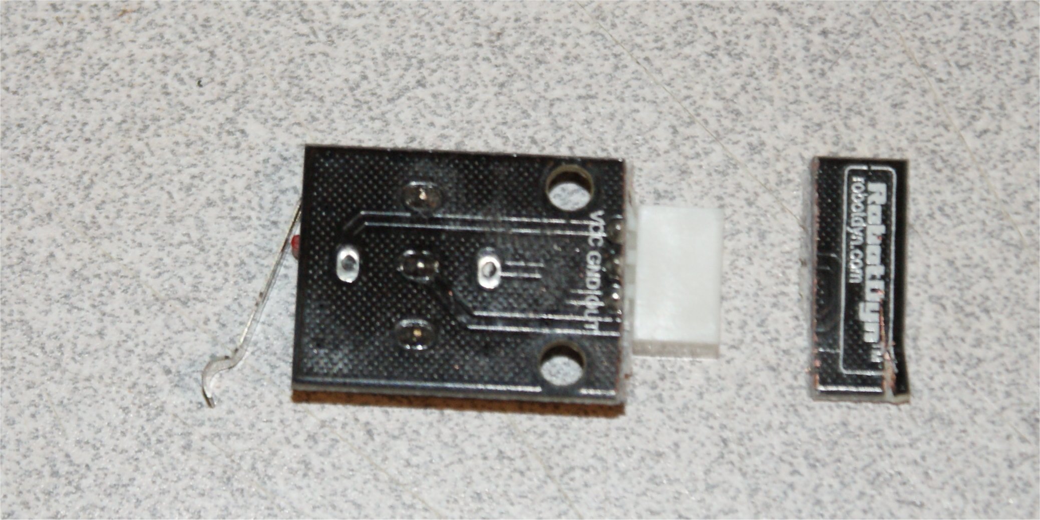

I decided that sense I have a bunch of the RobotDyn that I will design a case for the end-stop switch for use as a Filament Run-Out Switch.
Part one trim back PCB behind soldered connector. Then Solder wire from center of switch to GND terminals to restore trace.

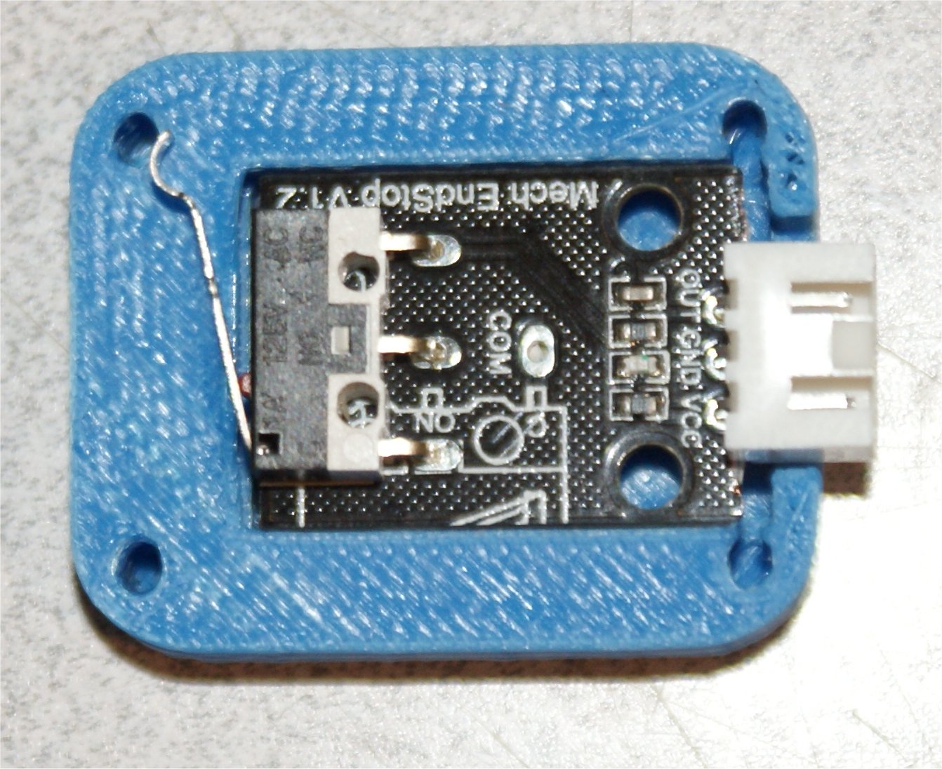

Now to redesign the case image posted in previous post to fit RobotDyn End-stop Switch.
1st Case model fitting looks good, though I need to enlarge the model to get the hole size rather than enlarging the hole to fit the Switch into.
Will think about this then make another adjustment.

Attached is the first draft model of the filament run-out switch, I did not include a hole for the led in this draft model.
The circuit board fits into the model very securely and allows the LED end-stop switch to work very smoothly.

Today I finished the smallest end-stop switch using the Ender 3 limit switch
attached is my Design for the filament run-out switch using the Ender 3 limit switch above.
I did not place the LED light hole as many different Ender 3 limit switches exist.
