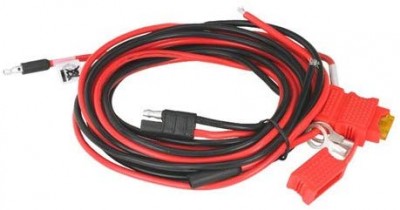

Then the wires from the supply to the controller were underrated so used a Motorola business radio wire.
Now if I would have wired my 3D Printer with the wires supplied there most likely would have been a meltdown.
