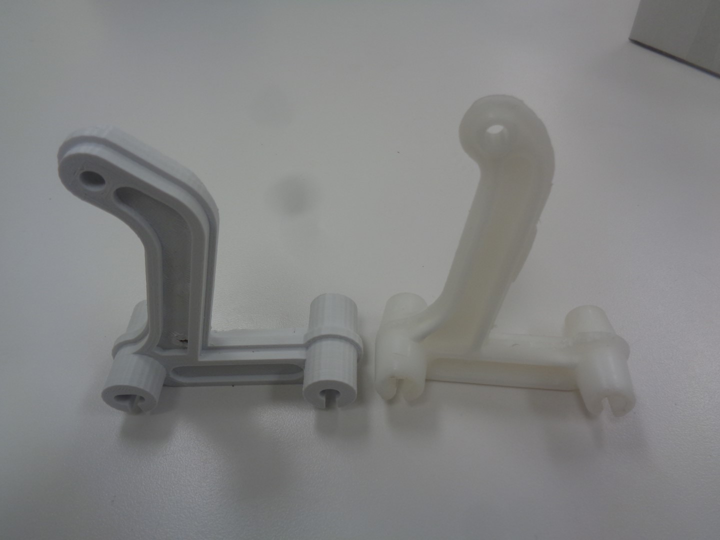

Hello Everyone,
I am new here and new to 3D printing. I am looking to get into it as a commercial kind of application, and the first idea I had was to print belt pegs for our commercial dishwasher.
https://www.partstown.com/stero-dishwasher/soc59-5631
That is the original, I've done a model for it and printed one with a co-workers printer, they used ABS with about 10-15% infill, it's a Monoprice Ultimate Printer, I am planning on getting an Ultimate 2 for this project.
The Ultimate 2 can reach nozzle temps of 250*C and bed temp of 100*C.
I'm thinking of using PETG as it has a higher melting, glass transition and heat deflection temp than most other materials and it is also food safe which is good for what I need. The absolute highest temp the machine can hit is 200*F water temp, so it's rarely going to make the surface temp reach that, it will probably hit a max of 170-180*F.
What do you guys think?

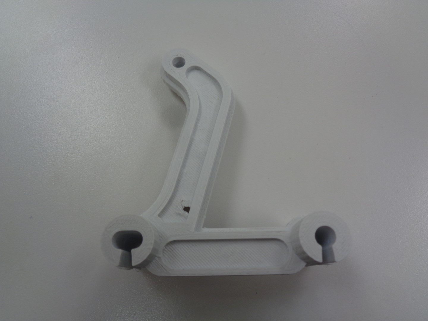

I like your Idea of the printing of the Dishwasher Belt Pegs.
I Printed a part for a Gutter Hanger. The difference is the part needed for my gutters is obsolete .
Shown below
Shown below
Re: Printing Dishwasher Belt Pegs
That's cool, what's it made of?
The one shown in the previous Post image was printed with ABS.
Though I have printed them in PLA and ABS, then can see for myself which lasts longer and is stronger.
I designed it in ThinkerCad before learning to use Fusion 360 Free for Hobbiest.
It works the way it is designed but still needs a few tweaks to be perfect needs to be 1/8" shorter.

I printed a Peg out of PETG and it survived the temperature just fine.
Now I'm trying to figure out how to make it snap on without breaking the snap on mounts.
