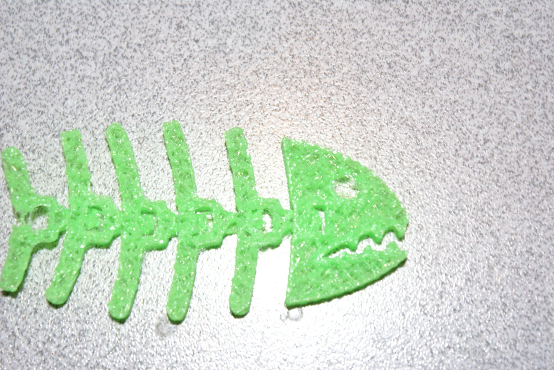

Here is a few reasons why this could happen.
Under extrusion
- the extruder could have became clogged
- the sliced model could have been sliced at the wrong filament diameter
" I have had this happen
" it makes the model look like Swiss cheese if you slice with 3mm filament and print with 1.75mm filament
An example of a Swiss cheese print
Under extrusion
