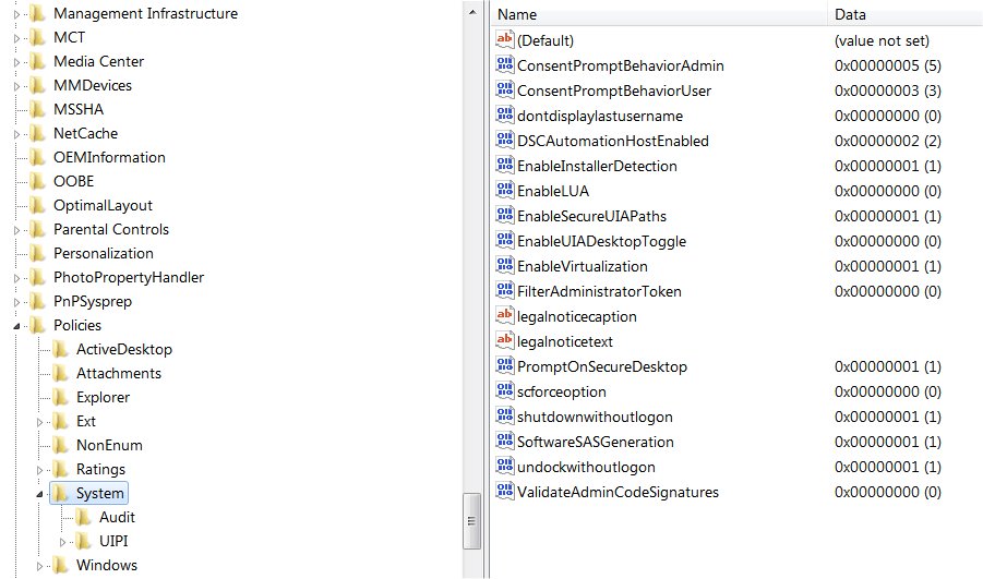

HKEY_LOCAL_MACHINE\SOFTWARE\Microsoft\Windows\CurrentVersion\Policies\System\EnableLUA exists
EnableLUA exists on system, and it is 0

Roberts_Clif wrote: June 11th, 2019, 7:20 amEnableLUA exists on system, and it is 0
Wow, that’s bad for me. The behavior on the other system was:
  1. Thumbnails didn’t work. Triple-checked all registry keys etc.
  2. User turned UAC on. Thumbnails started working.
  3. User turned UAC off. Thumbnails stopped working.
  4. According to Process Monitor, the HKEY_CURRENT_USER\Software\Classes registry branch was not mapped into HKEY_CLASSES_ROOT as soon as EnableLUA was on. This prevented Explorer from finding the STL preview handler key, although it appeared to be correct in regedit.
  5. Installing the thumbnails for all users on the machine (msiexec /i "Papas Best STL Thumbnails.msi" MSIINSTALLPERUSER="") fixed the problem.
This means they shouldn’t be working with UAC off as long as you don’t perform an all-users installation with the magic msiexec spell. Dang. I guess instead of ripping registry implementation details apart for another week, I should just say “if it works with UAC disabled, good for you; if it doesn’t, I have no clue“ :(
