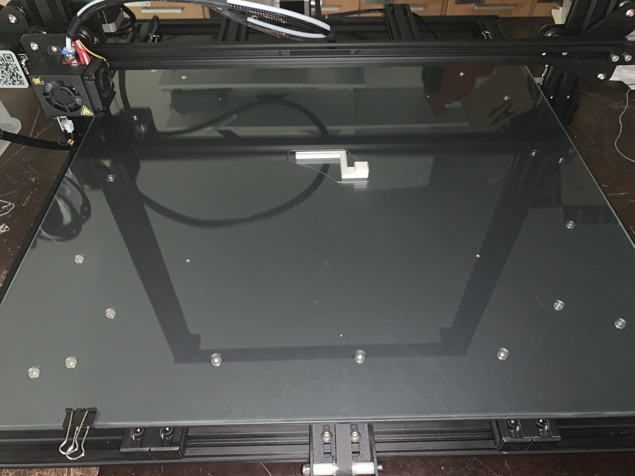

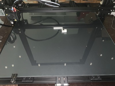

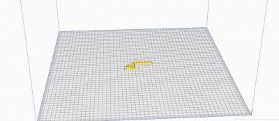

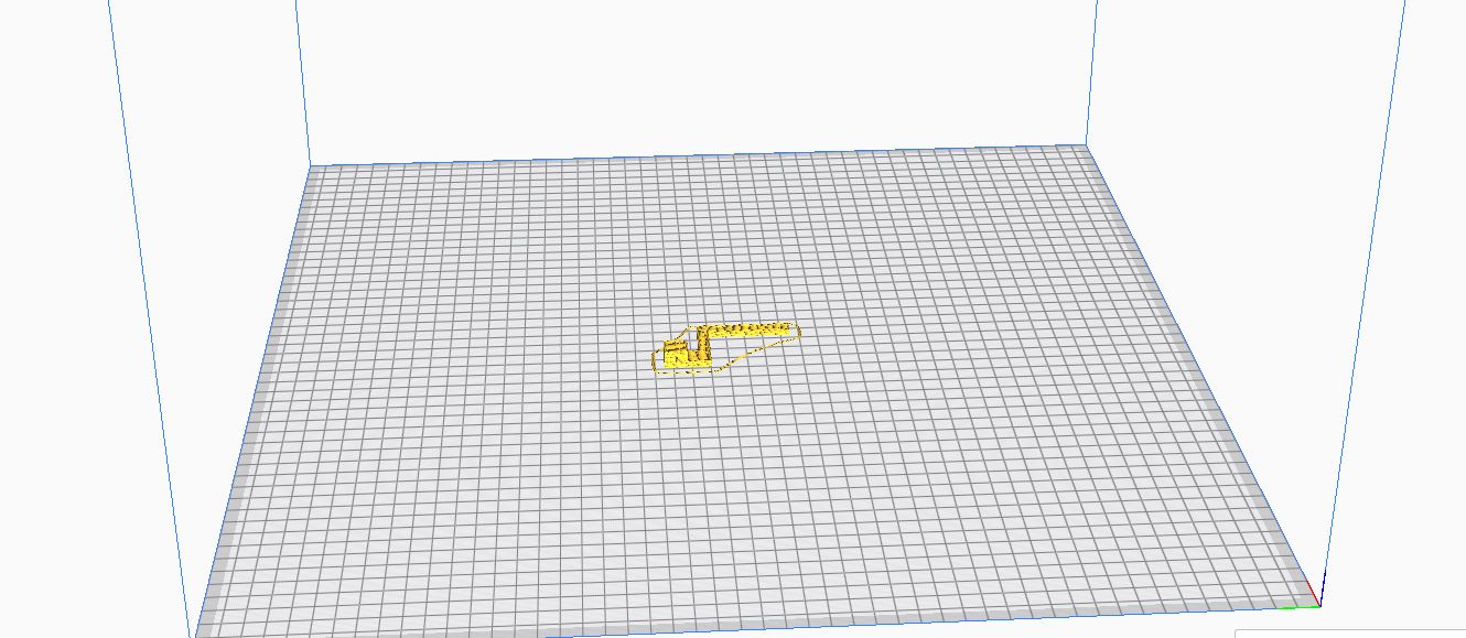

Hi,
I have included the pictures of Cura and what the 3D printer actually prints. I'm have not been able to look into the document from the another reply. Looking at this now though. But thought I would get this up for review.
Thank you!
Rob
