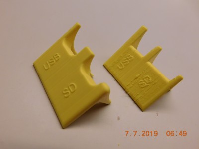

I made up a bracket in Fusion 360 for protecting the USB and SD-card on a CR10s PRO.
The first print looked very nice but the dimemsions had to be a little different.
I made the changes in the dimensions and did another print and it looked like _BEEP_ !
I even made a new drawing from scratch with the correct dimensions but same very bad print !
See the attached picture ...
I ONLY changed the dimensions between the two prints - the one to the left is OK, the one to the right is just garbage !
What is wrong ?
Suddenly very bad printing ??

You may need to run it through a program that cleans up the mesh. Or your temp or layer height is off.
Re: Suddenly very bad printing ??
I think you missed, that ONLY the dimensions has changed between the two printouts - NO change in settings at all !
What is this "mesh cleaning" program ?

Is your nozzle blocked?
No, but I found the fault - the feeder wheel was loosy goosy and nearly falling of so not enough filament was fed into the extruder
Oh, it's way worse than I first thought !
This banking noise kept on !
I then disassambled the hot end ... and there is was ... it was NOT and has NEVER been assembled correctly - where is the QC at Creality ... I beleave NON excisting !
The filament hose ended 15mm abowe the nozzle and there was that huge block of plastic half of it in the COLD end of the heat brake and the other half in the heat element and nozzle !
I took it all apart and cleaned it and now it's running like a charm

This is a strange question but the two USB SD models do not even look like the same.
You must have two different models. The left Model has larger protrusions on the Z-Axis than the Right model.
It also appears that the Left model has a more rounded shape while the Right model is more square.
It also appears that may be using a different layer height on each model.
What setting are you using on each, which slicer are you using for the models.
Example filament, Layer height, Nozzle temp, Print Speed, ect...
