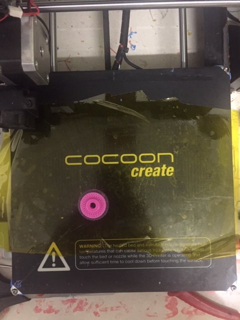

Thanks for clarifying that. I have it going to almost the middle now after going to the Home position.
I got it moving to almost the middle of the bed bu unchecking Origin at Centre in Machine Settings.
So nearly there. I'll put the photo of the position here when the print finishes.

Thanks for the Start G-code and the information. I now have it going to almost the middle of the bed and printing.
I'll put the photo of the position here when the print finishes and the latest Start Code if I can not get it to go to the middle of the bed myself.
Thanks again.

I am pleased as I have it printing on the bed but not quite in the middle as in the photo.
I'll get back to it on Sunday.

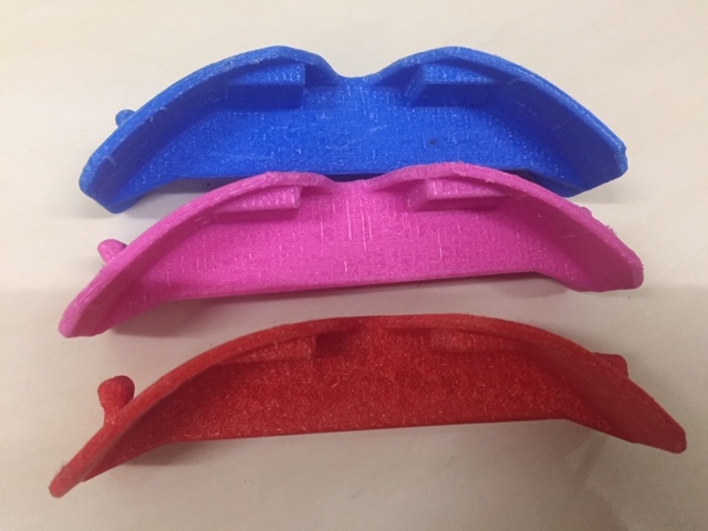

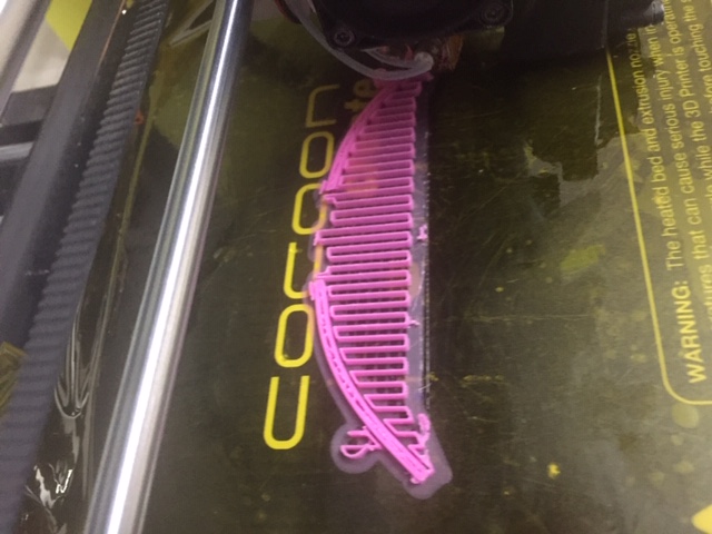

My initial problem was I could not slow down the Support speed in the old Cura and it came out all broken up. Someone mentioned that in Cura 4 you can slow down the support speed and that is where the fun started.
I needed to select a printer so the Cocoon Create Modelmaker did not work and there was nothing just for a Cocoon Create printer.then I got one I named Cocoon Create from somewhere and the Start G-code did not work properly. This is where you all helped and nearly got it to work good but after watching some more youtube videos I actually found the Add a Printer then Other.
I recently found in Other Wanhao Duplicator i3 which my printer is apparently copied from. After loading that all is working great.
So now my Supports are printing great for the first time in three years, as in the photo. Guess you call that progress. 🙂

Looks like I had the Support in the above post was too thick.
All of my underside of the prints where the Support stops have been rough but is it possible to print it so it comes out nice and smooth?
Posts: 4065
Re: Cocoon Create Profile for Cura V4
I can't recall what it's called in Cura...maybe Support Top Distance...or roof....support interface? But you can set how the support "touches" the layer it is supporting for a smoother surface upon removal
