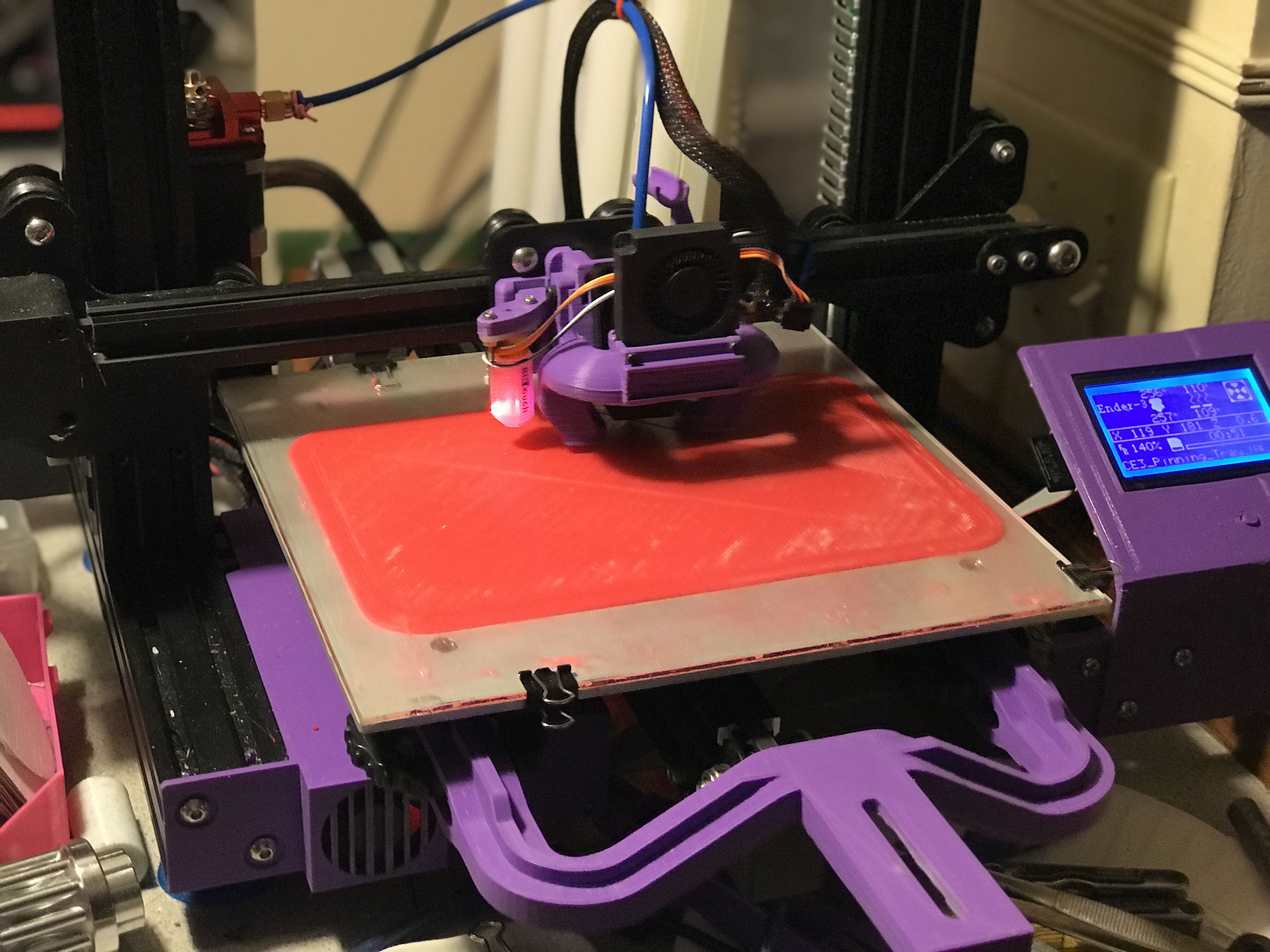

So then...I am printing the BosnianBill brand new LockLab lock pinning tray that he just designed. It covers more of the print bed than any other print I have tried. I used my ABS juice I made, and went for broke. As you can see, I am on the second layer and probably out of the "It's not gonna stick" red zone. I'm now really tossed between PETG and ABS. This is with NO enclosure BTW.
Layers, man!
Layers, man!
Re: Defeating the ABS curse.
Tech Gorilla wrote: March 22nd, 2019, 9:16 pm As you can see, I am on the second layer and probably out of the "It's not gonna stick" red zone.
Shhh, don't jinx it. I've had prints come up 40 layers into the print, and that's with PLA (the easy stuff).

I'm astounded how well the ABS juice sticks, and how a 20 degree drop in bed temp pulls the whole mess of clean as a whistle!
PS, I got a 1mm sheet of 12"x12" PEI sheet in for the Hictop today. I plan to hook the level sensor up to 24vdc on Sunday so I can level through the PEI. it's going right on the aluminum.
