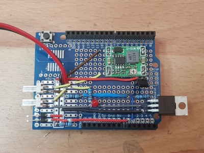

I finally managed to convert the ideas that I had collected over (too many) months into an Arduino shield to drive the filament fuser!
The shield has a 12V input, an optional 12V to 5V step-down converter to drive the 5V part without the need of an USB connection and the necessary parts to drive the fan, the heater and measure the temperature of the hotend with the 100K PTC.
Now I need to work on the software. I have a LCD shield with buttons that I want to use as "user interface". Currently the code can already measure and display the temperature. Next step is to develop the PID code that will control the heater based on the temp sensor readings. Once that is done, I need to code a menu to select and maybe store the target temperature(s).
