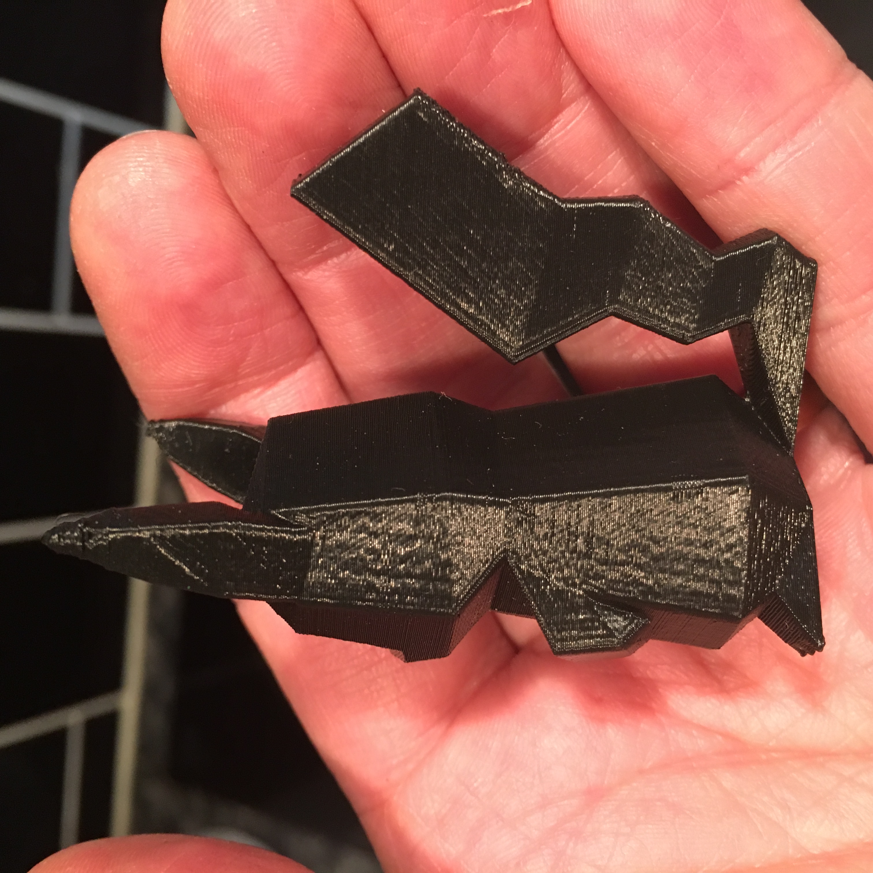

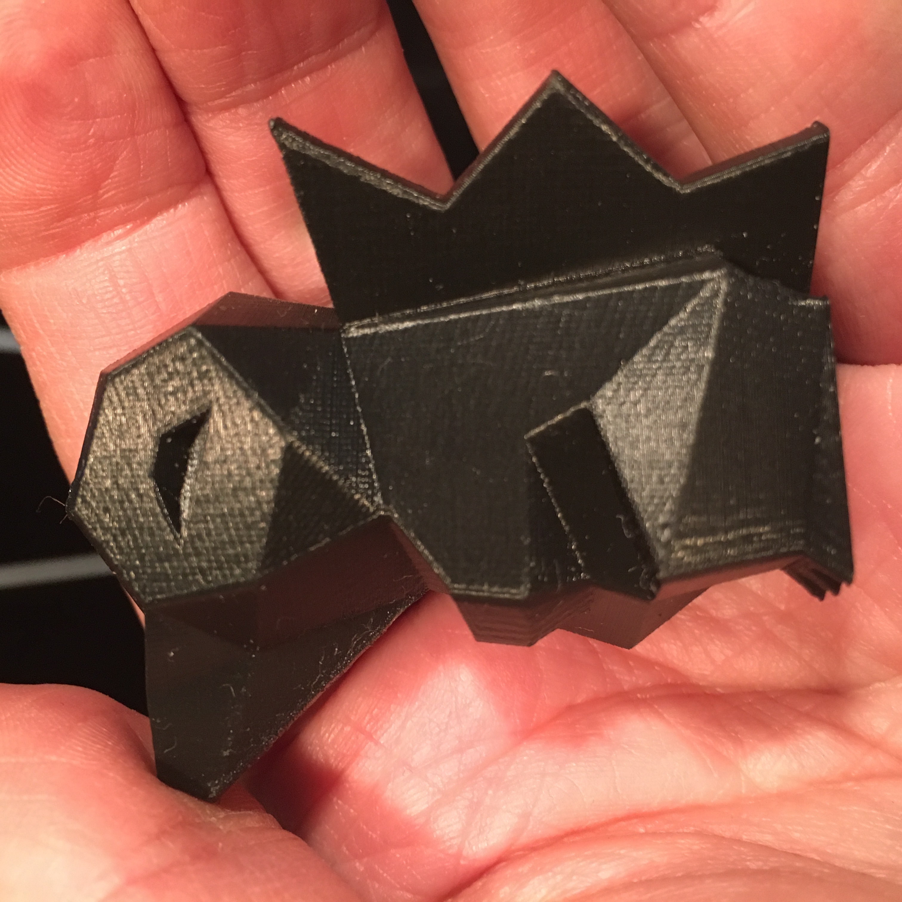

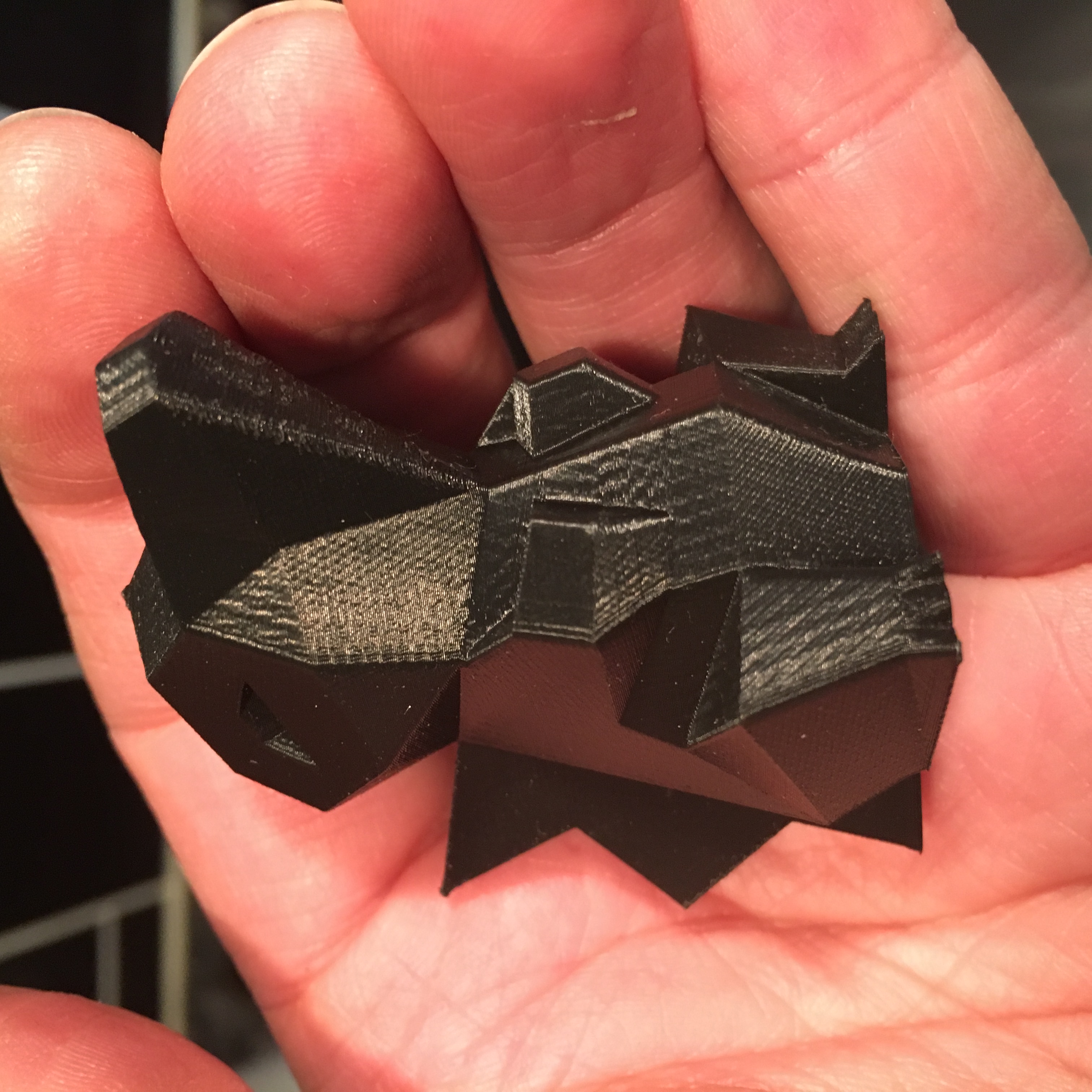

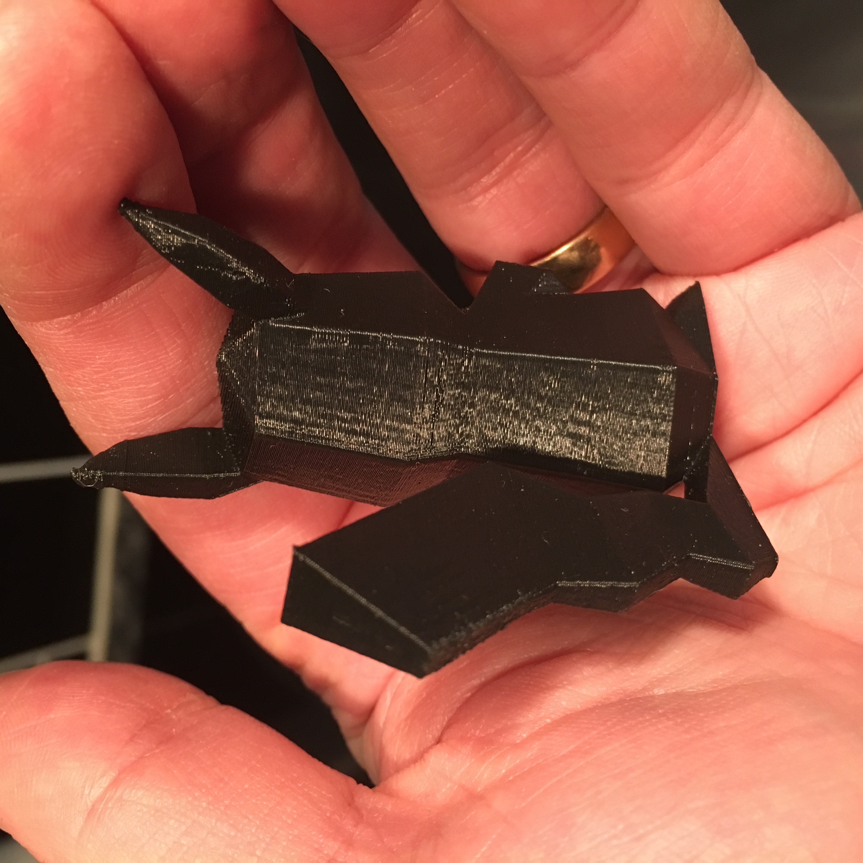

Here are two Pokémon figures that I have printed for my kids. No post-processing and the tail of Pikachu is still there :)
Printed on a stock UMO+.
And if I were to play with Acetone a bit they would be even smoother :)
(and yes, the images were not taken in that orientation... :roll: )

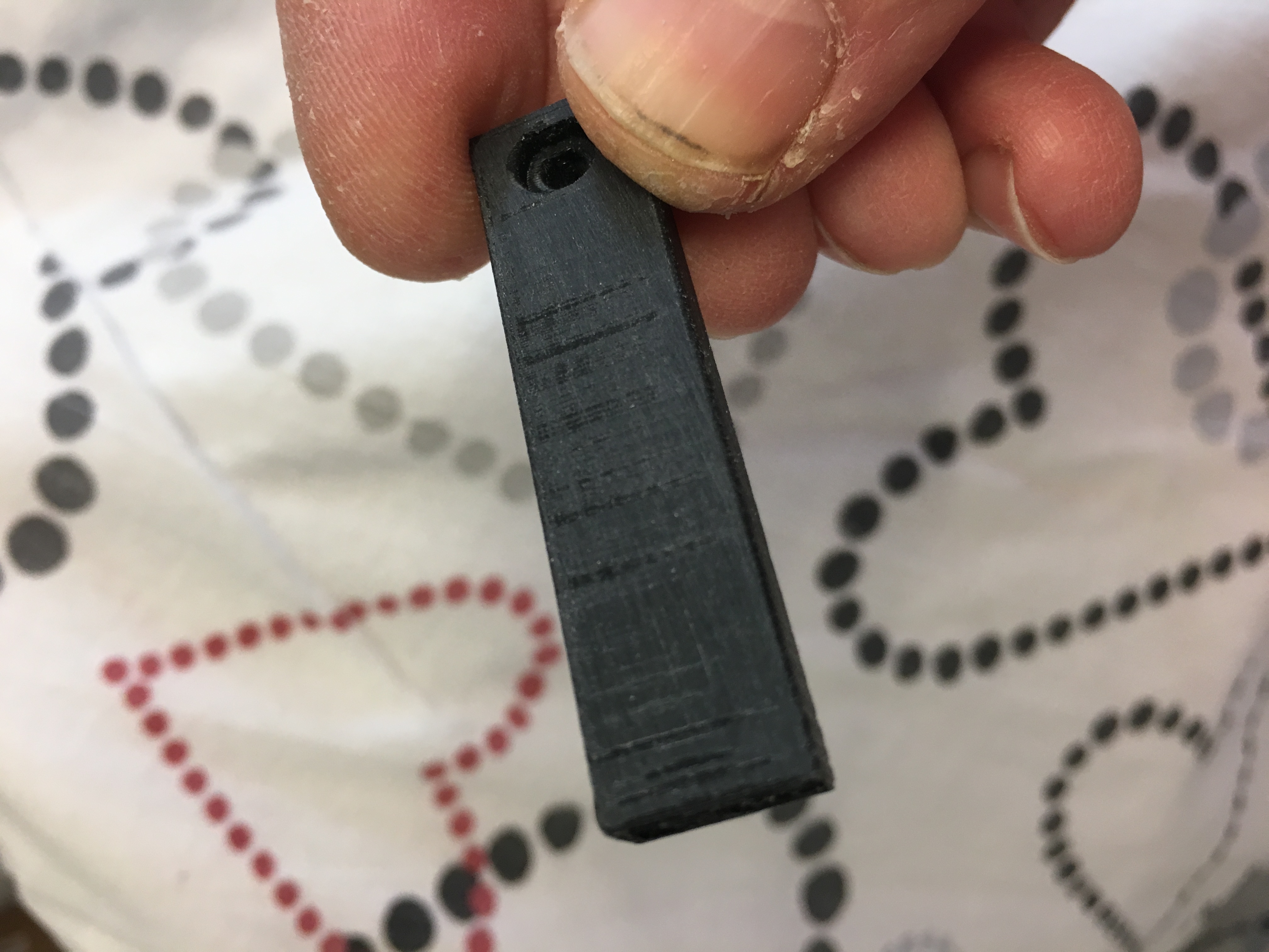

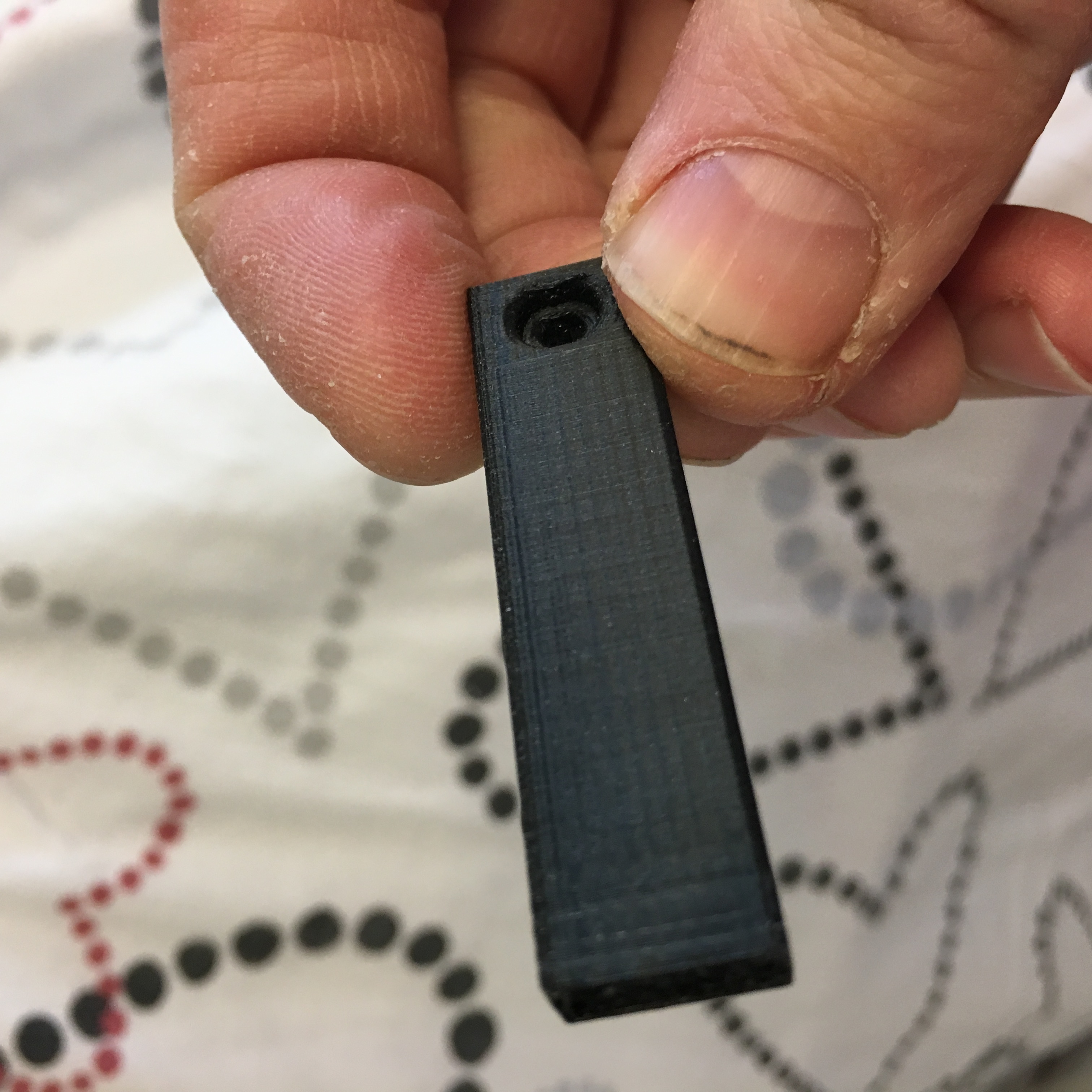

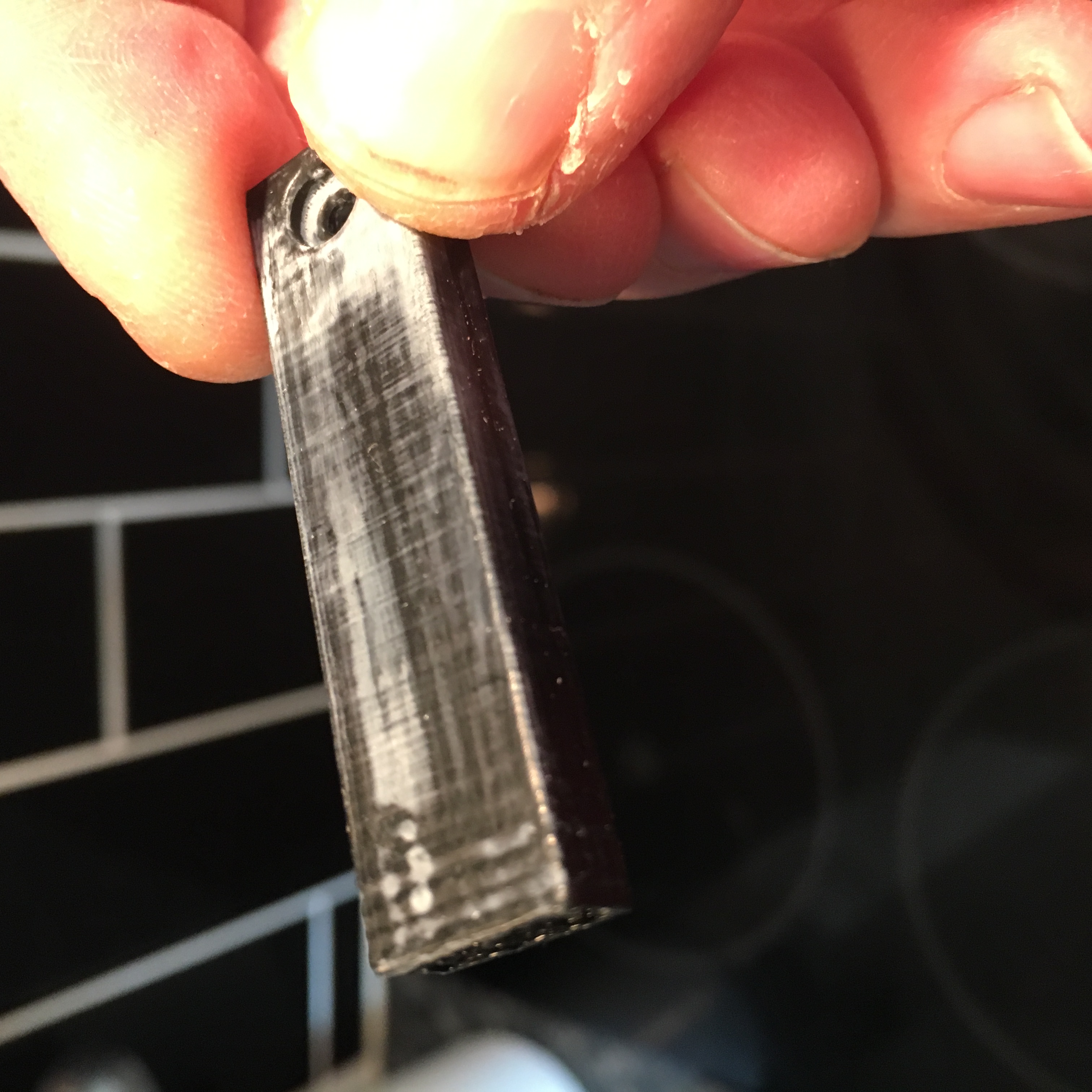

Not the most scientific test...but here is a quick and dirty one. The pieces were printed with 0.1 or 0.15 mm layers (can't remember exactly) and bad bearings so the surface is not the smoothest.
This is straight out of the printer:
This one is sanded lightly:
And this one was brushed with acetone:
So this filament is very easy to post-process both with sandpaper and acetone. And imo very easy to print with.

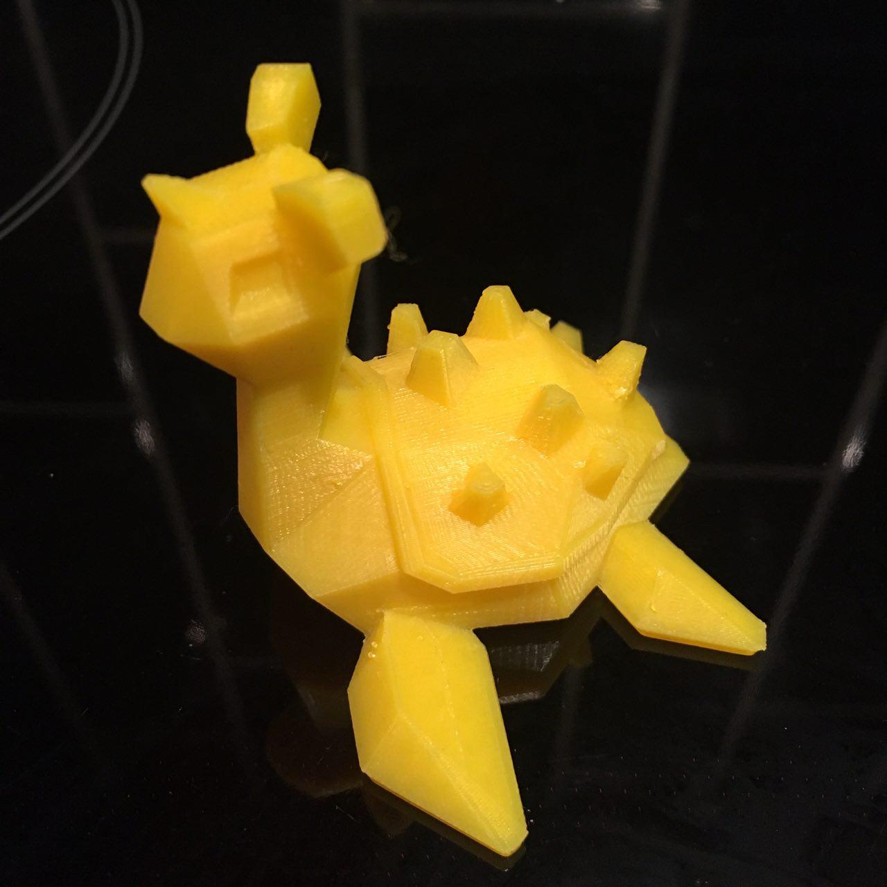

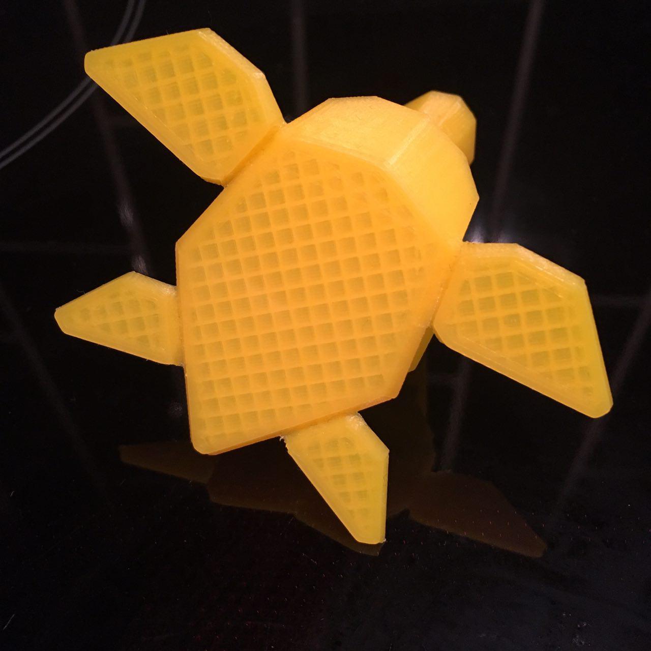

Switched to my yellow roll of Polymax to print a Pokémon figure for my son...turns out that the yellow color is somewhat translucent :)
The bottom is 4 layers thick...layer height is 0.12 mm...so the bottom is ~0.5 mm thick...yet you can easily see the support structure.
