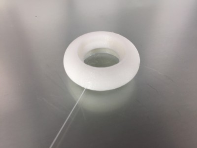

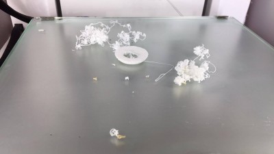

Well this stuff is fussy

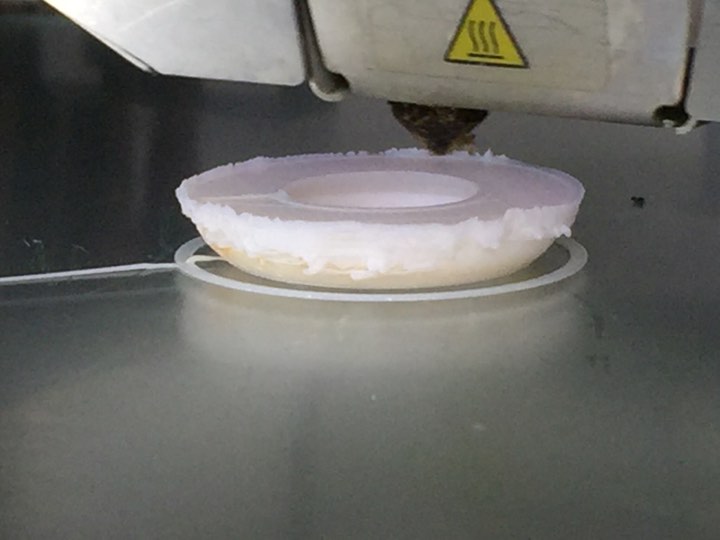

My first try I got this "seam" (maybe bad overhang?) along the wheel...looks like some of my previous orange filament is seen in the bottom layer :)
Try two was a lot slower but it came off the bed. Maybe bed to 50? 60? Like PLA? I had it at 40
It looks really good until it hits this point...

Okay, so the key is two things (in addition to what I posted earlier)
Nozzle Temp: 235
Speed: 10 mm/s
Oh..and bed to 45C
