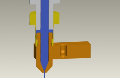

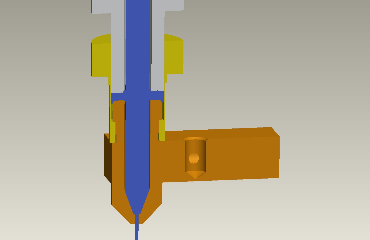

Regarding the rigid spacer, the original spring-design has a flaw that causes trouble in the event if a leak between the coupler and the block.
If this happens while you are extruding with high force, the hydraulic pressure in the molten plastic can overcome the force from the spring, lifting the whole spacer the same way a hydraulic cylinder works.
Here is a very old picture, from the time before the Olsson block :-) , of what happens:
The adjustable spacer was a little design challenge to enable dual printing experiments on the UM2.
I recently made a fixed printable spacer with a slot were you can see the bowden tube, I think it is the best compromise for single extruder printers, haven't had time to refine the design or to upload it yet though.
