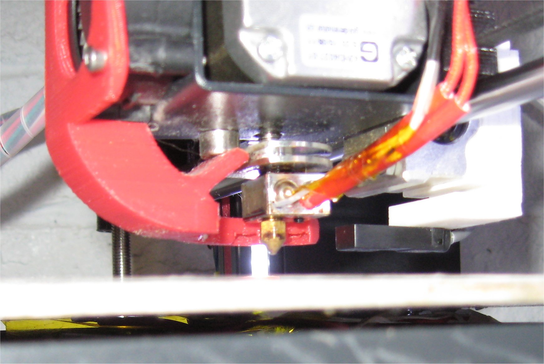

Hello I have a solution that has been proven My me.TheOrvinator wrote: ↑July 23rd, 2017, 11:02 pm Hey guys,
My Hictop 3DP12 i3 Prusa was working great for several months, and I've enjoyed it. Just for a week now, it continues to jam after 10-30 minutes into a print. The nozzle will clog, nothing will come out, and the machine will go on without pushing any filament out. I've looked through many forums and tried all their suggestions, but none have worked so far. I have replaced the jet fan, throat, and nozzle.
Matt
I took one of these heat sinks Cut it in Half between the Fins, making 2 half height Heat sinks.
As Shown.
Remake of Hictop Part cooling Duct
Modified because extruder leaking filament, could not easyily be remove with full circle around Nozzle.
