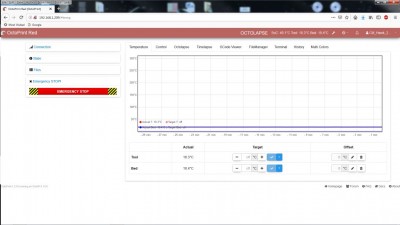

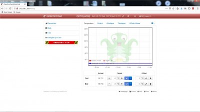

Can't get the Large Emergency Stop button, just a little triangle on the top menu line.
https://github.com/ntoff/OctoPrint-Estop
Am I not doing something right. I loaded from OctoPrint plugin-manager.
Some plugin do not work is this because of my Pi Zero.

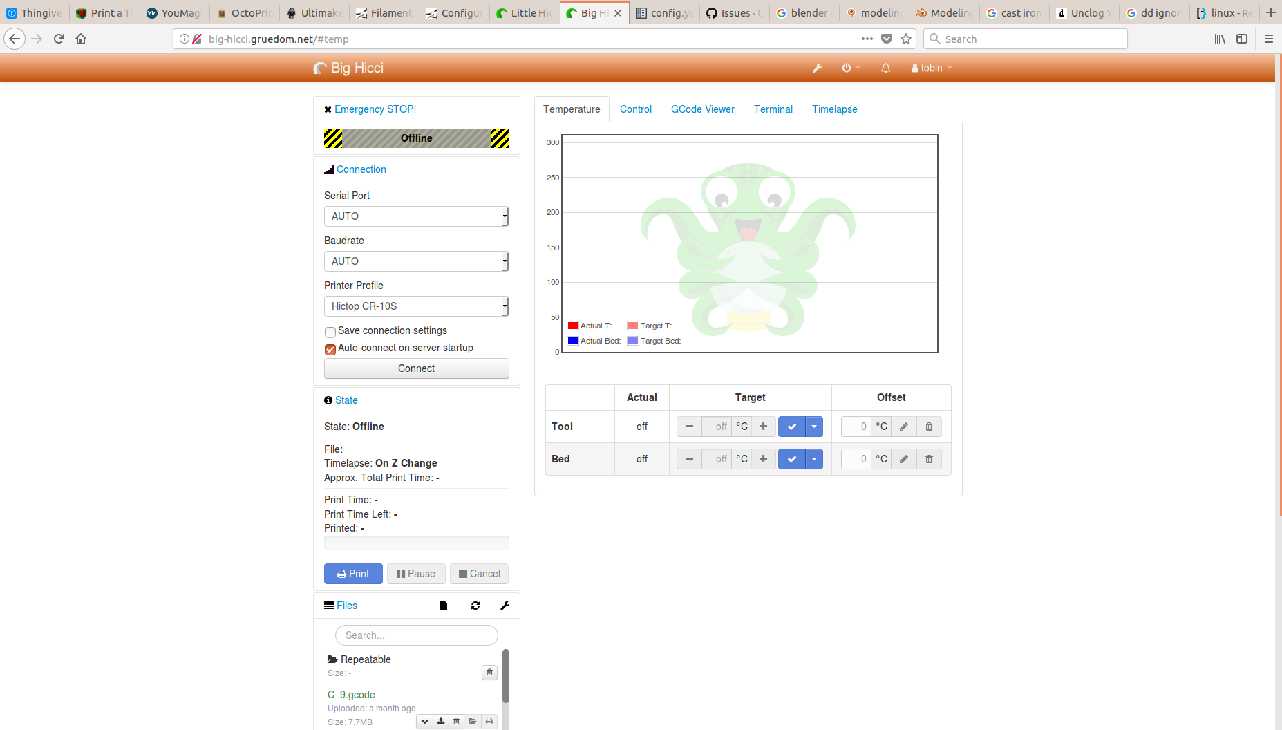

Re: OctoPrint
I have the Emergency Stop button working just fine. It may take a little to tweak the config to your liking.

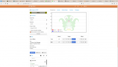

Here is the default after installing and restarting Octoprint:
Note how it is at the bottom of the sidebar, below the files and not very convenient.
After editing the config.yaml file on my pi (ssh to the pi, and edit ~/.octoprint/config.yaml) from this:

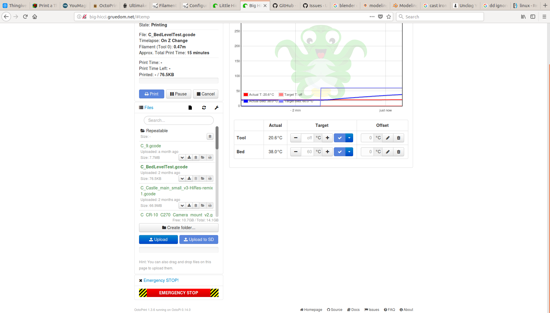

Save and restart Octoprint from the web interface. It will now look like this:
