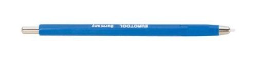

The connections on your card became oxidized an needed to be cleaned,
Solution use a Fiberglass Cleaning Brush ( "and" Extra Thin Fiberglass Scratch Brush). Can be purchased thru many sources E-Bay or many online stores, it is a product of Germany and work wonders in cleaning electronic connection free of oxidation.
