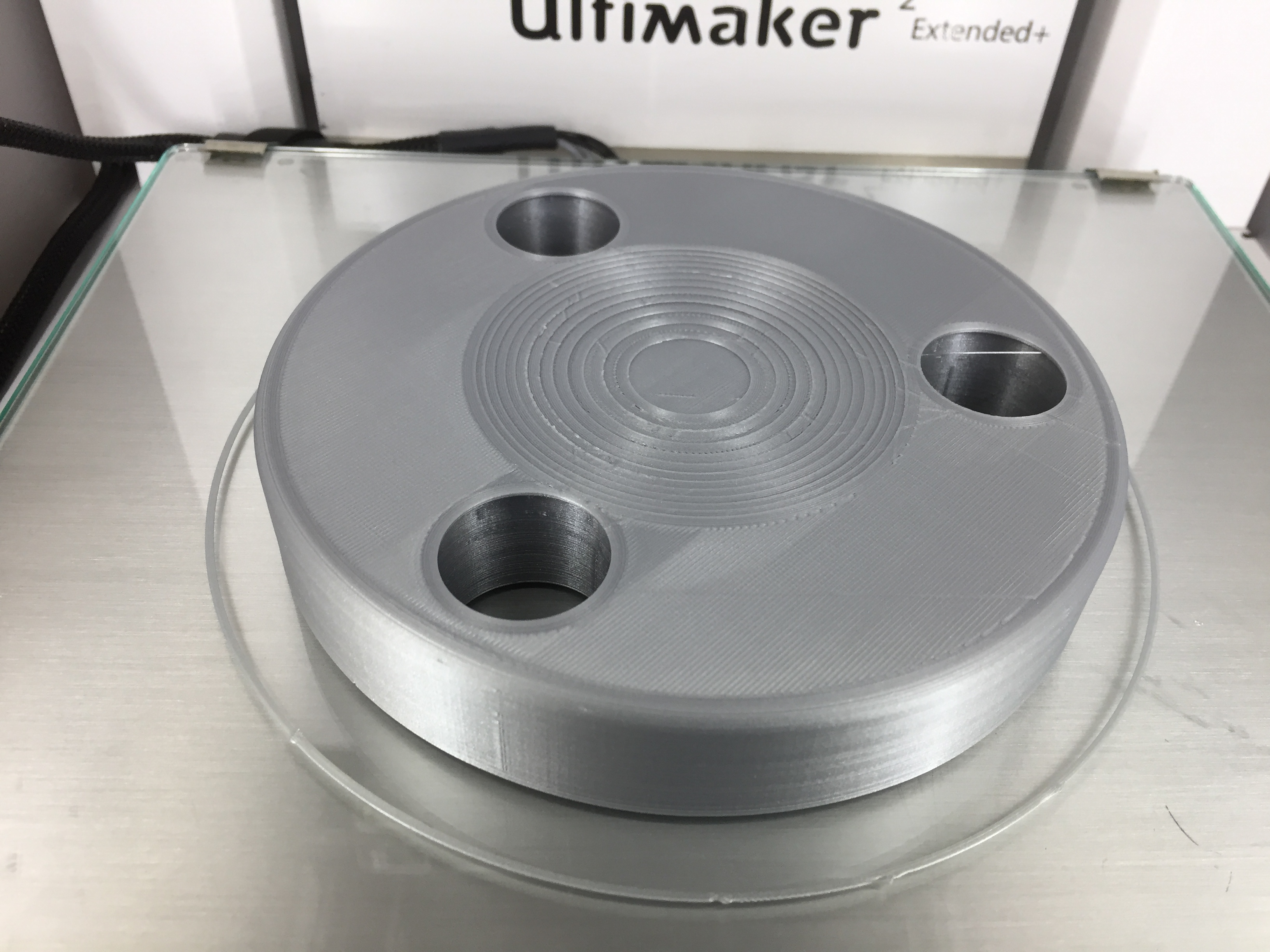

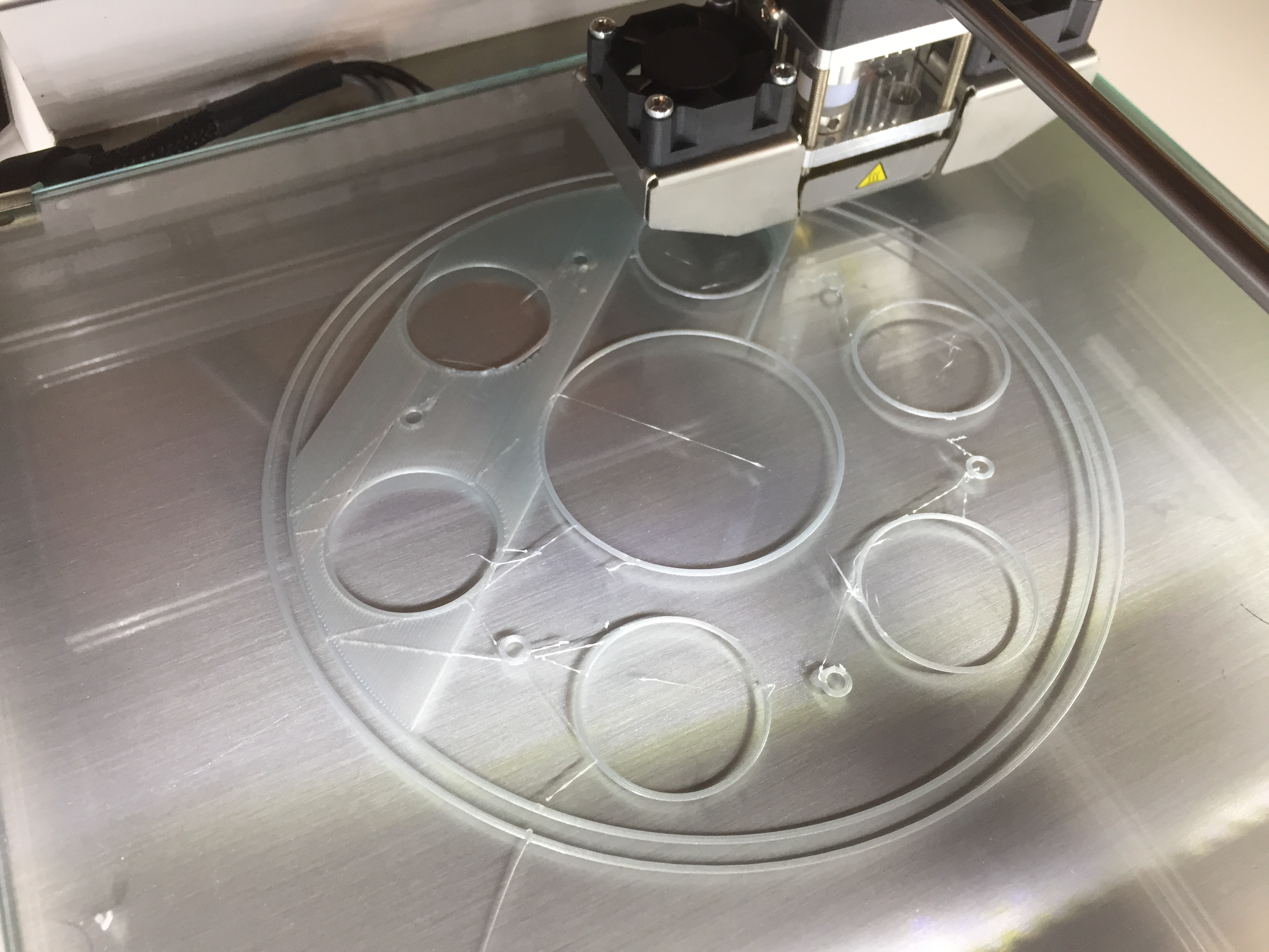

Pretty much default settings for Ultimaker 2+ Extended. Set to Fast Print and 0.2 layer.

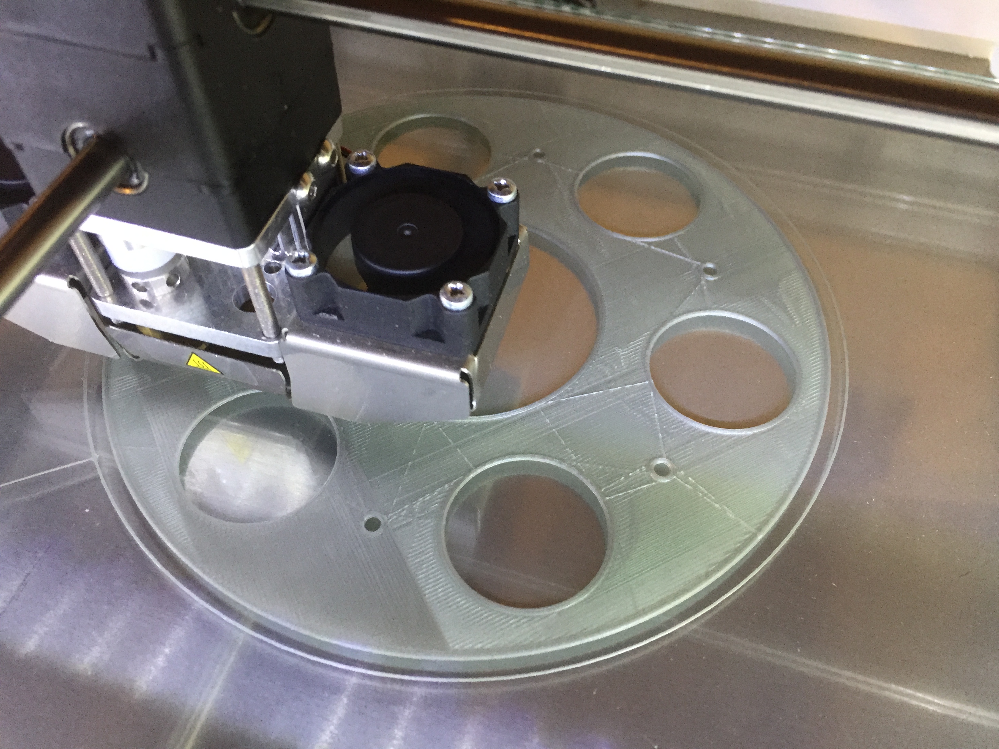

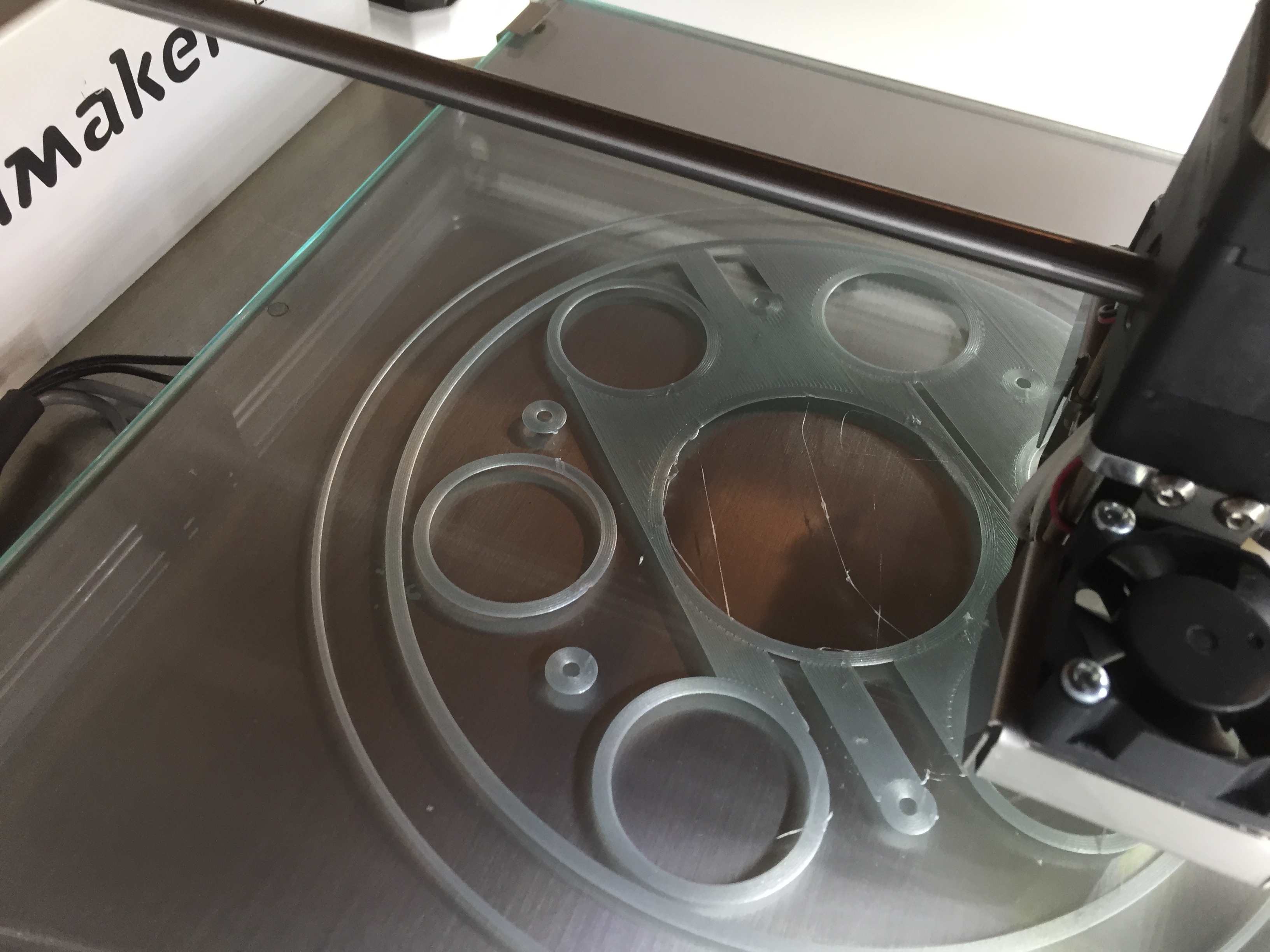

First layer looks kind of ugly
Trying to be the "lazy" customer. Just using Ultimaker filament and all. I have no idea why this is coming out so awful

It's done all the outer edges first but haven't z lifted between movements, does look just a little messy, how did it look in S3D?

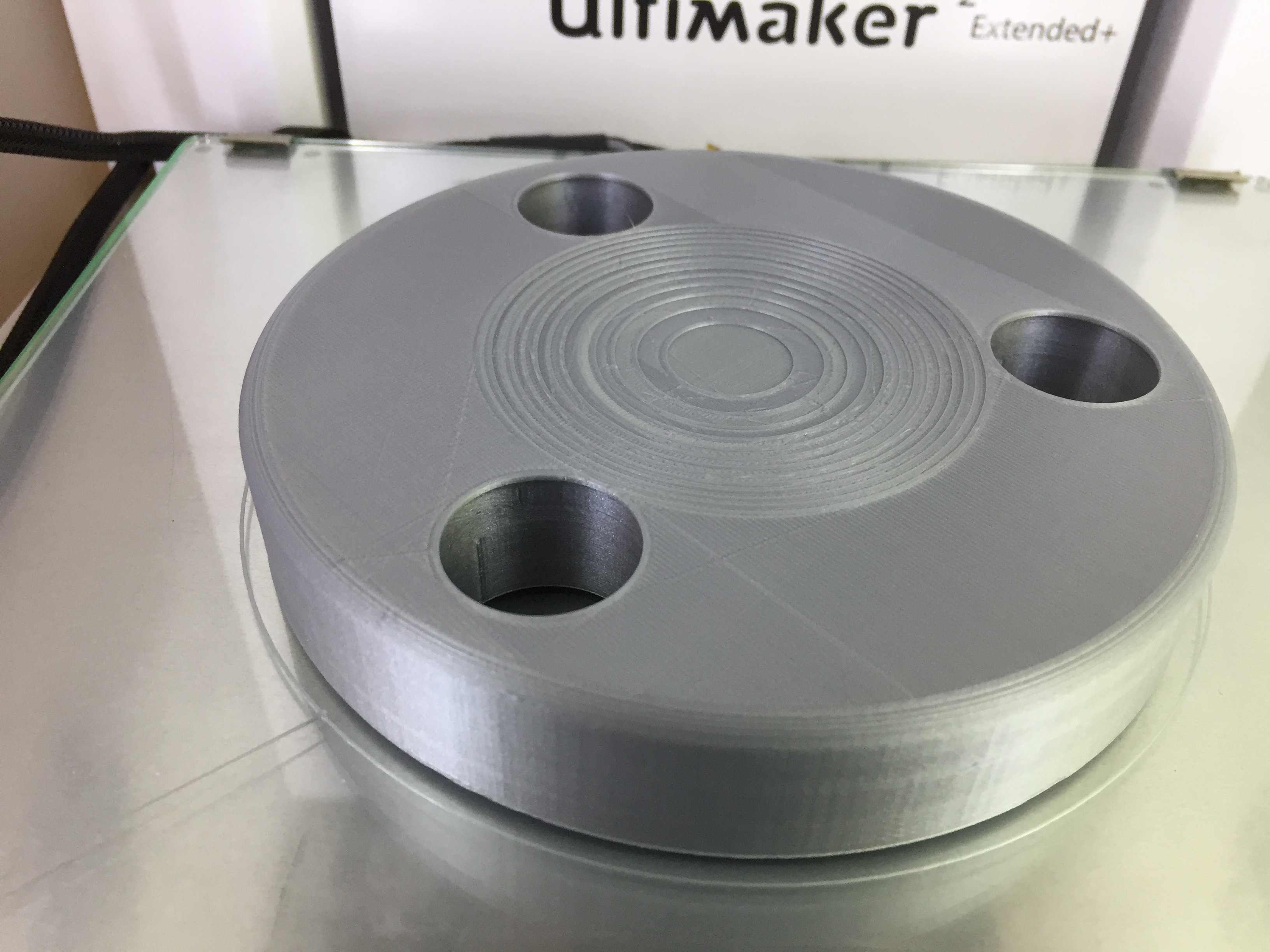

Cura
Cleaner
I have two printers making the part now. One from Cura. One from S3D. It'll be interesting to compare
Cleaner

Cura does all sorts of tricks to save printing time. What you see in your print is one of them which I think is not justified, since it saves very little time and the result is rather messy.
It is called combing in old Cura and means that when the head has to move without printing, it moves over surfaces that is (or is going to be) a part of the object without retracting or Z-lifting.
It does cause ugly surfaces and underextrusion after long moves (since material leaks from the nozzle during the combing), I am a bit surprised Ultimaker still uses this function by default.

Re: Cura 2.5. Why so messy?
Cura
S3D
S3D
I think the most concerning issue I see is that the Cura version shows polygons where s3d stays more true to the file without simplifying it. That ofc, if you print too fast means that the um2 board can stutter the buffer by sending too much moves/sec.
I think s3d great thing is that it actually let's you decide what improve and how. Cura has way too many automagic options to deliver something precise. For me repetition and speed (because I can tune everything to speed up the print without loosing quality).
Cura (old) is a great starting point to understand how this printers work, but to 'extrude' more of them you need to have as many parts under control as possible. And indeed s3d is more complex (specifically the parts the options that affect one to the other).
Just a week ago I found out how to effectively remove the blobs of any print (with calibration) at high speeds. Thanks to an option on s3d and ofc the zge (because directdrive shows everything that happens on the extrusion). Without this tricks printing flexible for my shop would be just impossible (because the speed I need).
