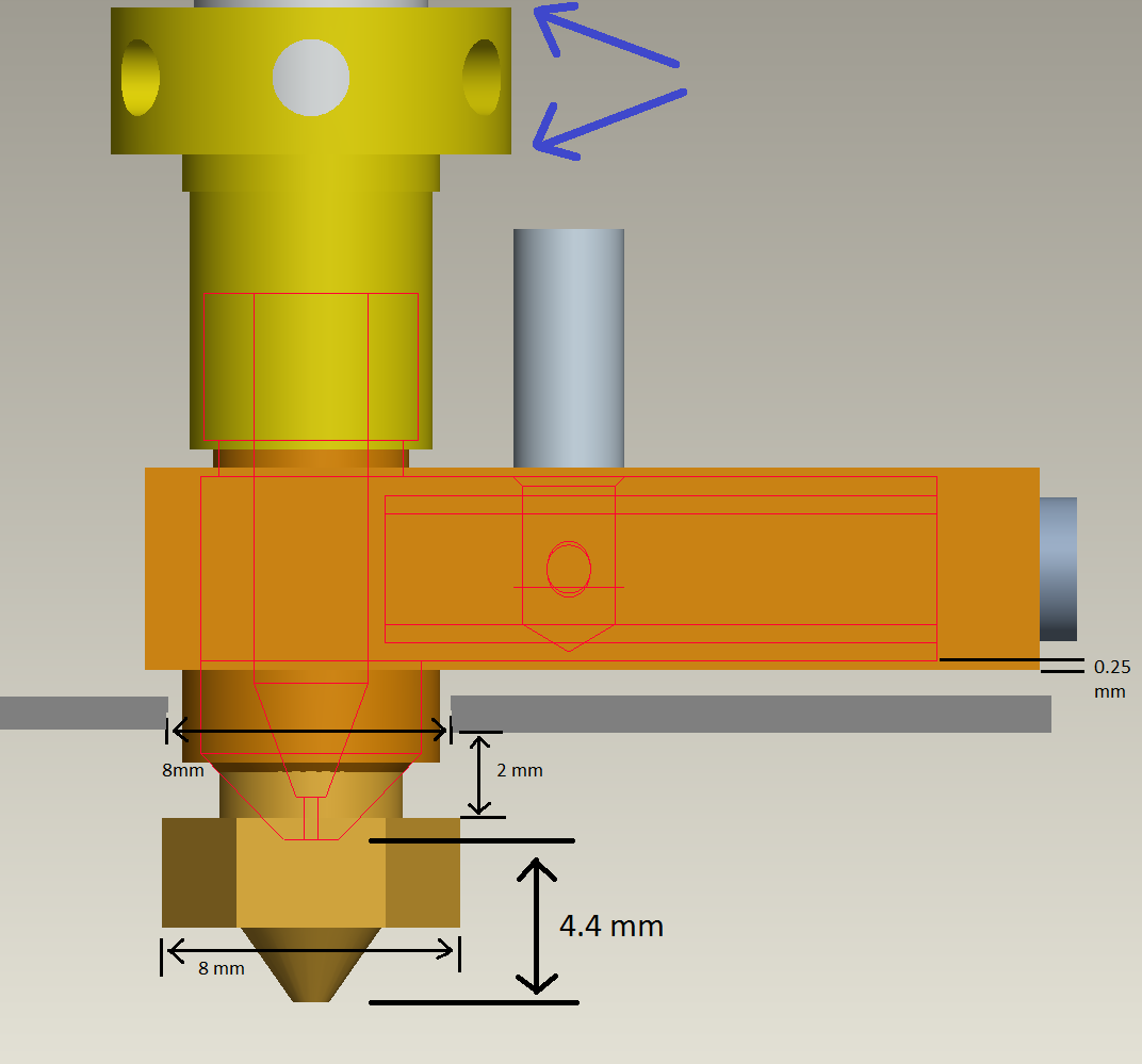

In fact, I was not aware at the time when I designed the Olsson block that that the STEP-files were public, so I measured up and made my own drawings of all components :-)
You can see that in my picture that you posted earlier, the heat break for example is missing the chamfers that you will find in the UM-drawing:
And if you would make a section of the original UM2 block STEP-file from Ultimaker it most likely would not be identical with the one in the picture (red lines).

I was thinking of a printable alignment tool that clamps around the heat sink and aligns the heater block with the rest of the components when tightening the guide tube. Preferably in a way that one does not put stress on the heat break if the tool is slipping.
