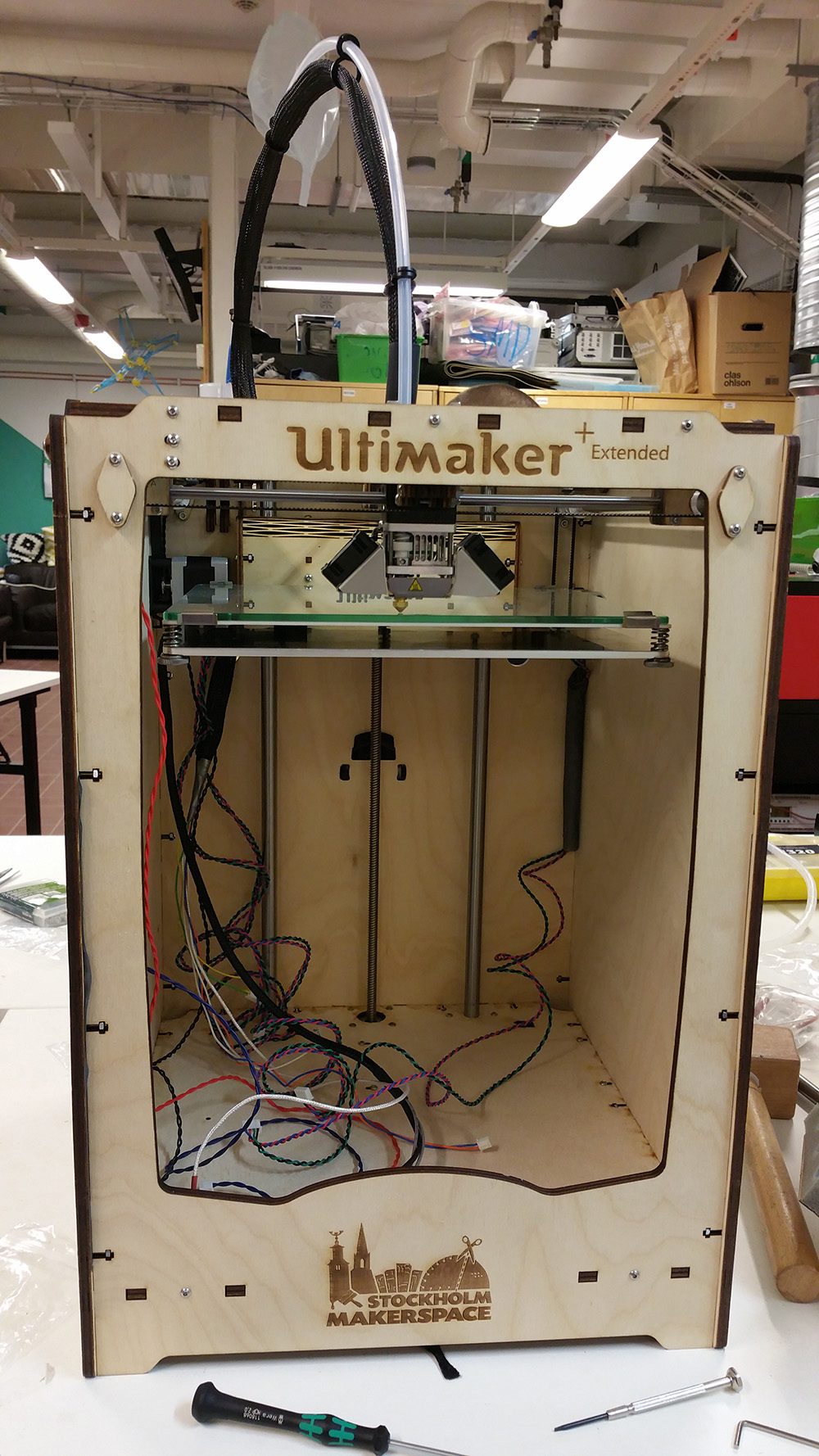

@Anders-Olsson already showed this picture in another thread, but we are right now building a custom Ultimaker Original+ Extended at Stockholm Makerspace, it is built from a official UMO+ kit with some custom mods.
The height is 100mm higher than the standard model, we lasercut the sides ourselves out of 6mm birch plywood and opted to close the sides to reduce draft problems. The spool holder used is the stock UM2 one instead of the lasercut one since it looks so much cleaner.
The print head is a UM2 one instead of the standard print head, mainly because i had one extra laying around so we could do it, but also because of the dual fans and the fact that i like the Olsson Block better when changing nozzles than the UMO block. Or you could just say that it is for the fancy looks

The fans set the opposite. This is a bug or a feature?

A bug caused of being too tired when mounting it, i saw and fixed it after the picture was taken
