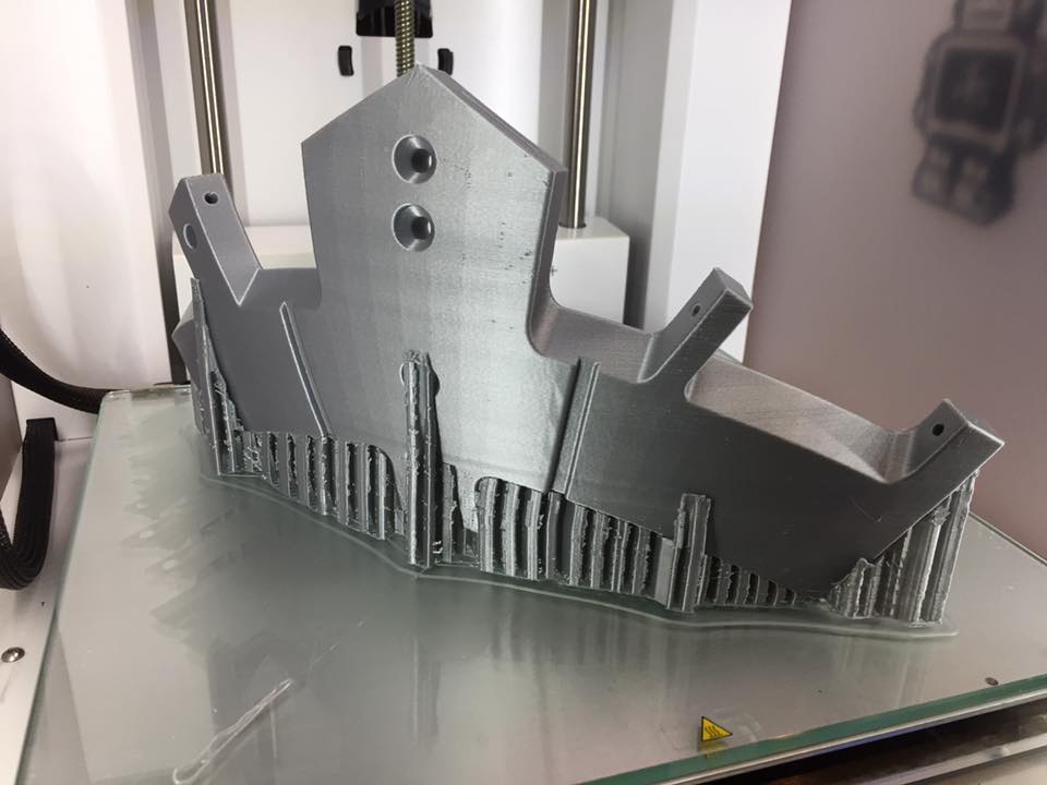

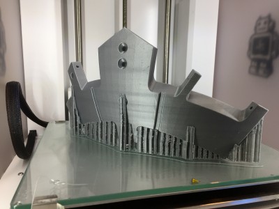

Post by LePaul » October 29th, 2016, 7:02 pm
14.5 hour print, first one on the Ultimaker 2+
Used glue stick and bed temp of 65 (first print flew apart 1 hour in)
Cura 2.3.0
I think I should try the 0.8 nozzle and cut the print time in half!

Looks nice! How much more prints do you need before it's finished?

This one was done with the ruby nozzle

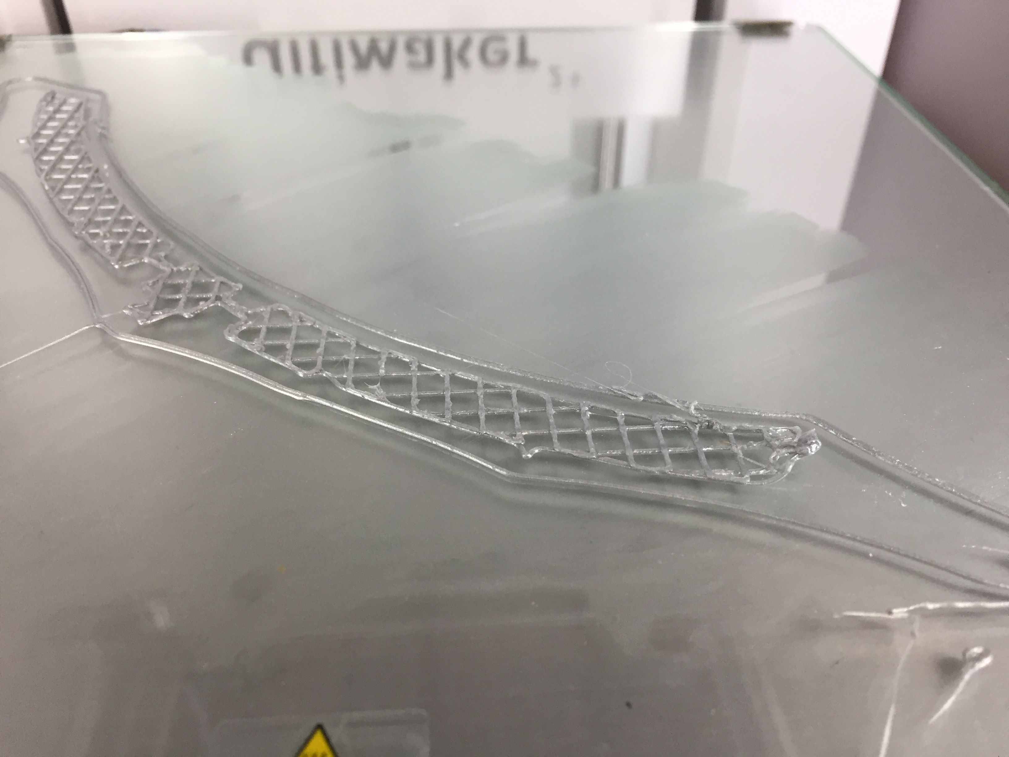

We'll 0.8 is a fail. It seems to keep clogging itself up
Posts: 138
Location: Netherlands
Re: BB-8 Frame print
Post by MTVDNA » October 30th, 2016, 4:41 pm
Maybe you need to increase the temperature a bit. If you print at the same speed and layer height, your flow is now twice as high.

Went back to the 0.4 nozzle (non ruby) and similar problems.
