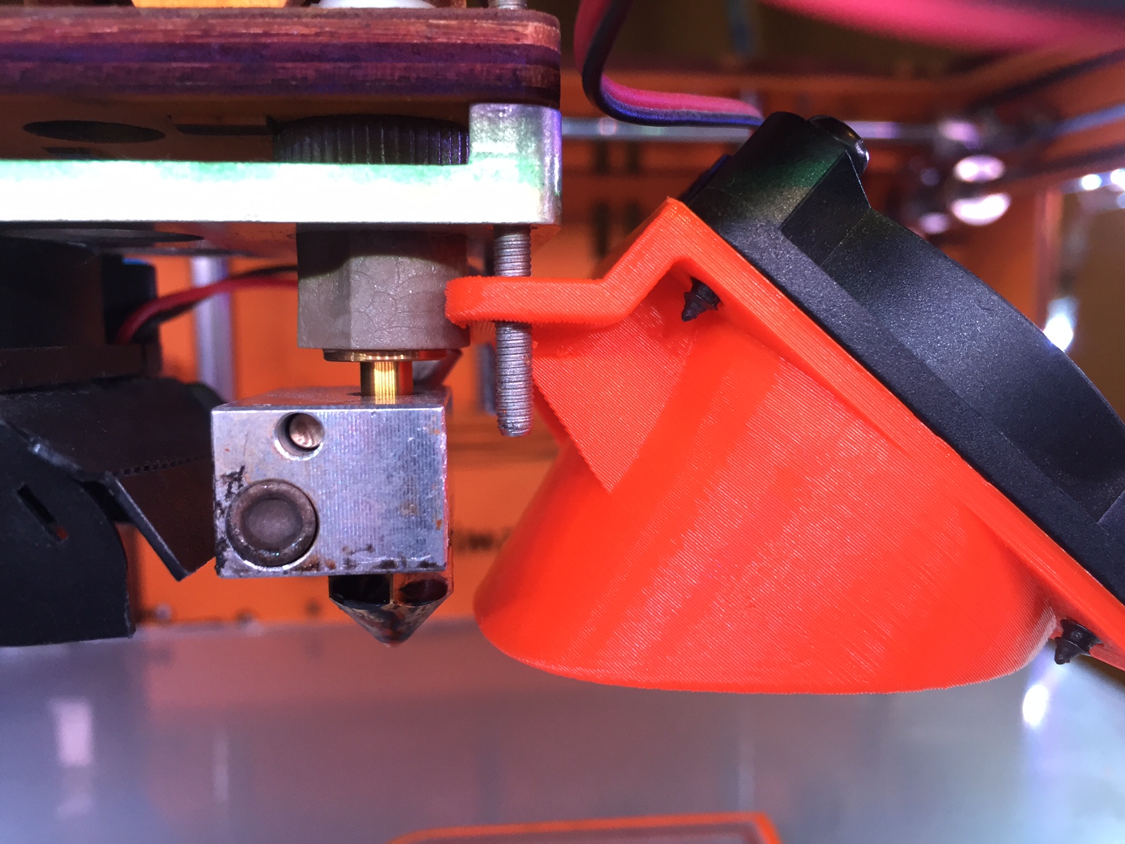

TALK TO ME ABOUT YOUR SHROUDS!
Since I installed the heated bed, overhands are suffering on the side without a fan.
I have printed some shrouds in ColorFabb PLA/PHA but wonder how well it will survive the radiant heat of the print head.
Here's what I made...test fit..
It looks like the ceramic piece above the head needs to rotate a bit...but I am afraid doing so moves the print head out of alignment
I just ordered a hardened nozzle and some Colorfabb XTCF20 Carbon Fiber Filament. That has a "High Glass Temp. (Tg = 80C)" and wonder if this might be a better choice is the PLA is not?

- I have printed a lot of different fan shrouds, I started with PLA, but printing with ABS temp they went soft,
so next was ABS shrouds, then XT, and XT seems to be the winner till now, but the latest XT has a higher temp to print, so the old ones are softening again
as long as the fans are running they won't melt

That was my thought...airflow helps. Maybe some thin alu shield...I have a ton left over from R2's skins lol
I am going to use those wire wire snap locks to splice the second fan into the existing one. Any troubles there? Identical fan...
