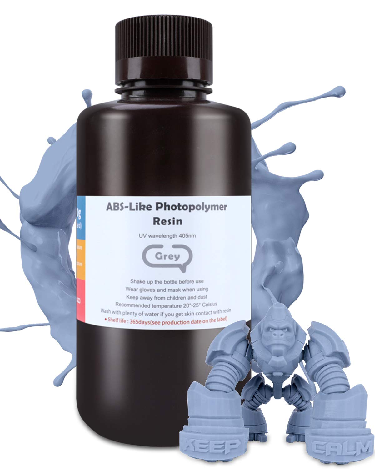

I'm beginning to think the resin I've been using may be the issue. Tried a large surface area print with a different brand of resin and it came out great when printed flat on the build plate.
Now for a question just as heated as which is better, Coke or Pepsi. What brand of resin do people have the most luck with? Nothing fancy, just standard resin. Maybe a better question would be "is there a brand to avoid?"

I use standard Elegoo ABS like, not 3.0 but the original one, I've had no problems with this, been using it for years.
