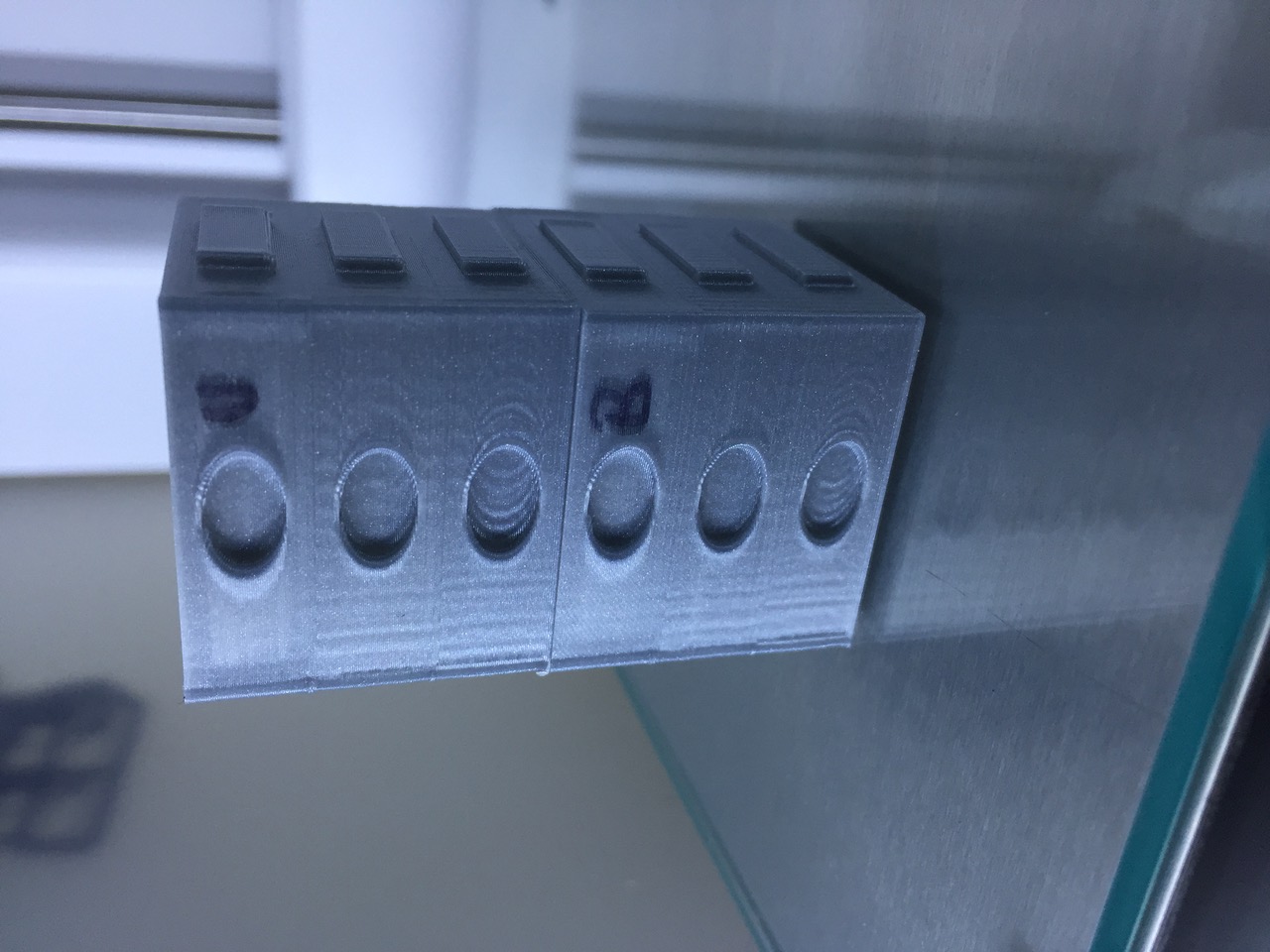

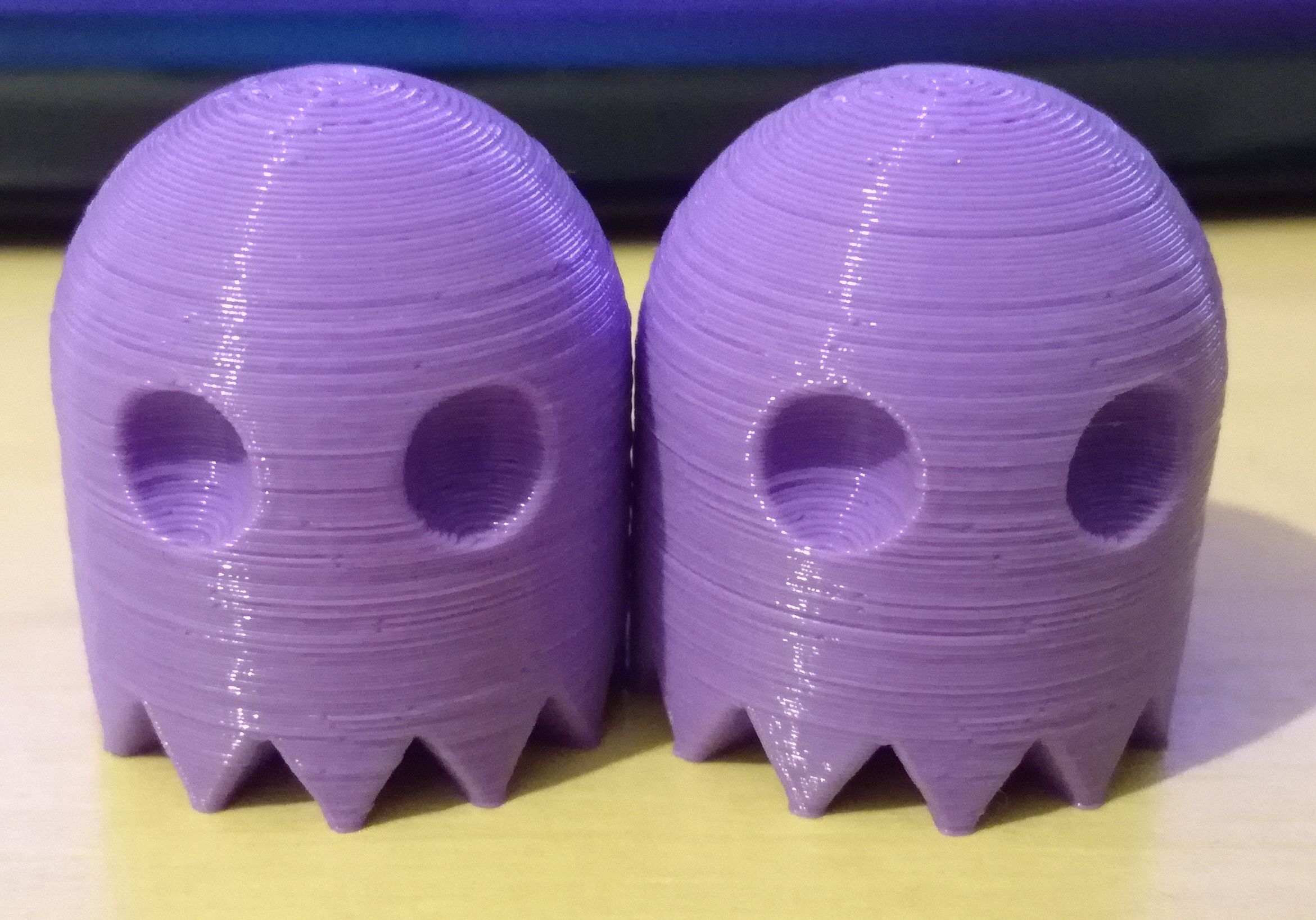

Well...for the sake of science I'll test this out and add here a picture of the results :)
antiklesys
Posts: 183
Re: UMO motion settings
Post by antiklesys »

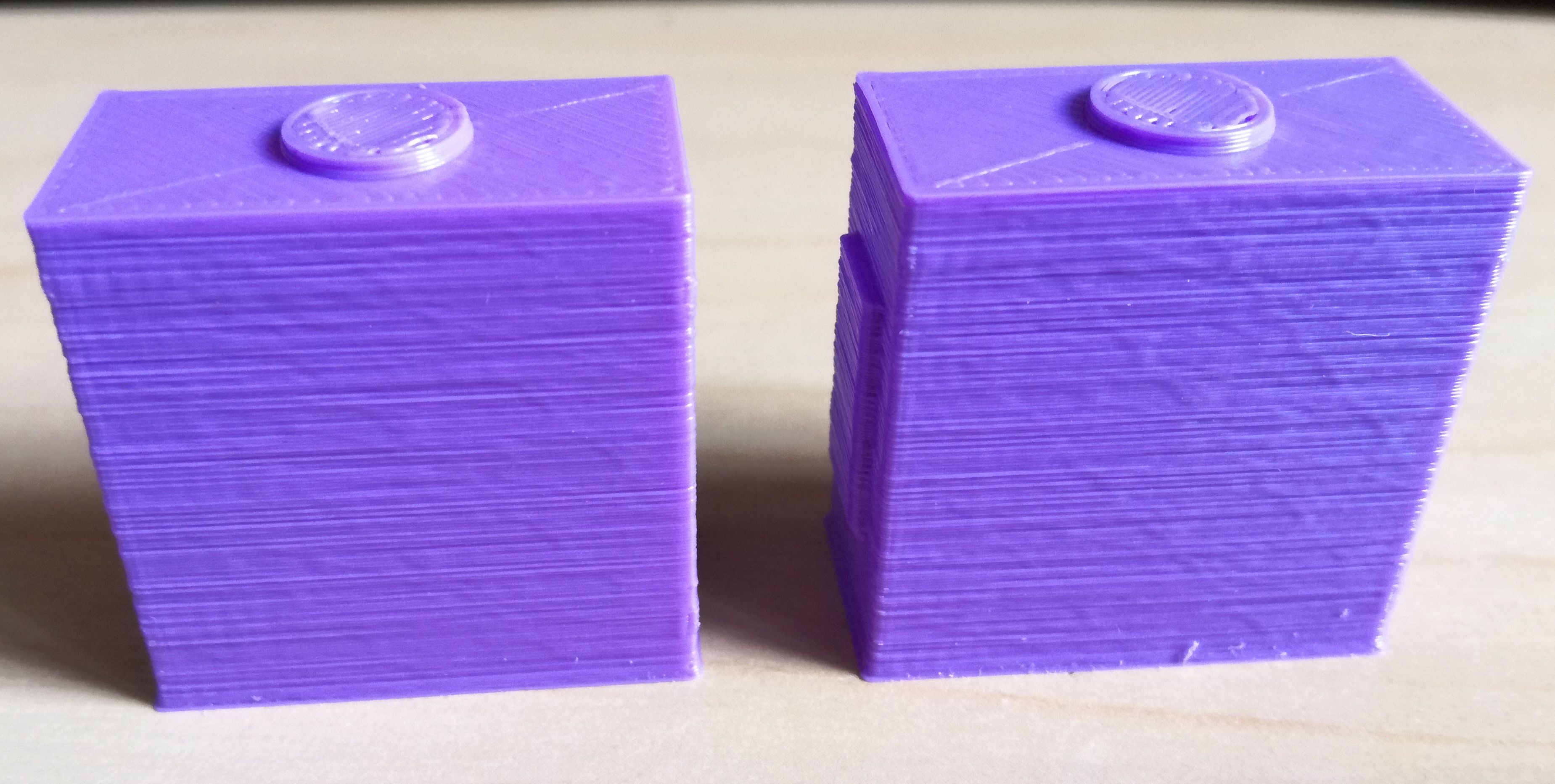

Tested!
Here's the visual result.
On the left the BEFORE (so original motion settings: Accel: 4000 & Vxy-jerk: 20) on the right the AFTER (Accel: 3000 & Vxy-jerk: 12)
Just me or it's more or less the same?

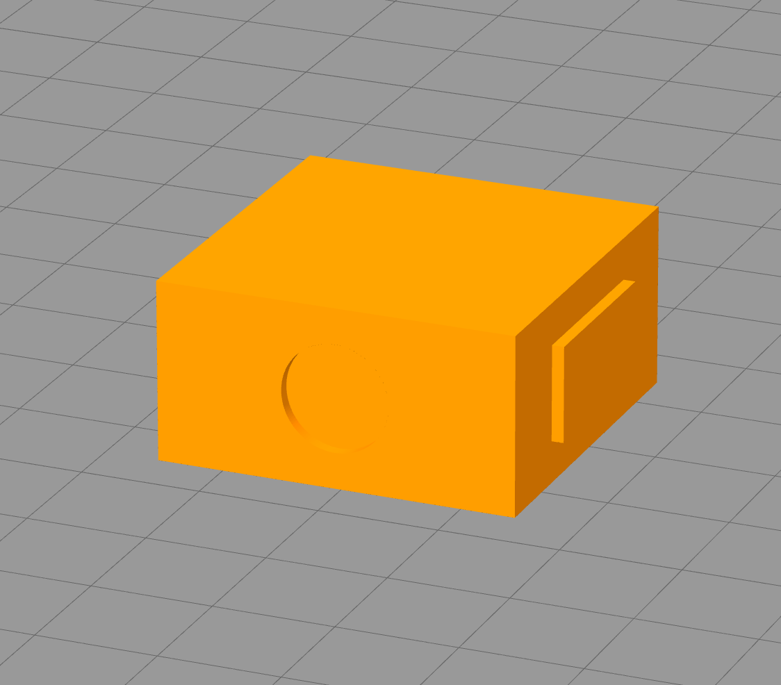

I have one that @IRobertI made. I'll link in a few
https://www.dropbox.com/s/qr1edksfve18u ... t.STL?dl=0
A quick file made by
I Robert I wrote:IRobertI
Some test photos made on the um3 with various test, fixes, experiments and etc etc. Ofc print without top/bottom and 2-3 perimeters. 0.2 layer height somewhere between 0.1-0.2 should show a good debug I think.
Upss sorry I did delete all my photos of ringing tests... Anyhow, is a good test.
At 500 acceleration + 5 jerk the ringing should disappear completely but on the corners you will see a slight deformation of the change of vector, making the square corners a bit rounder than normal (ofc you can't do a perfect 90 degree change).
The part that this test doesn't cover is the top layer small areas with zigzag. The lower the acceleration/jerk the more troubles the feeder will have to make them perfect, leaving gaps (due delay from pressure going to the extruder from the bowden pressure/relax delay). So when the speed goes down too much (too low jerk) artifacts can appear (more visible on top layer).
etc etc etc. Have fun testing!

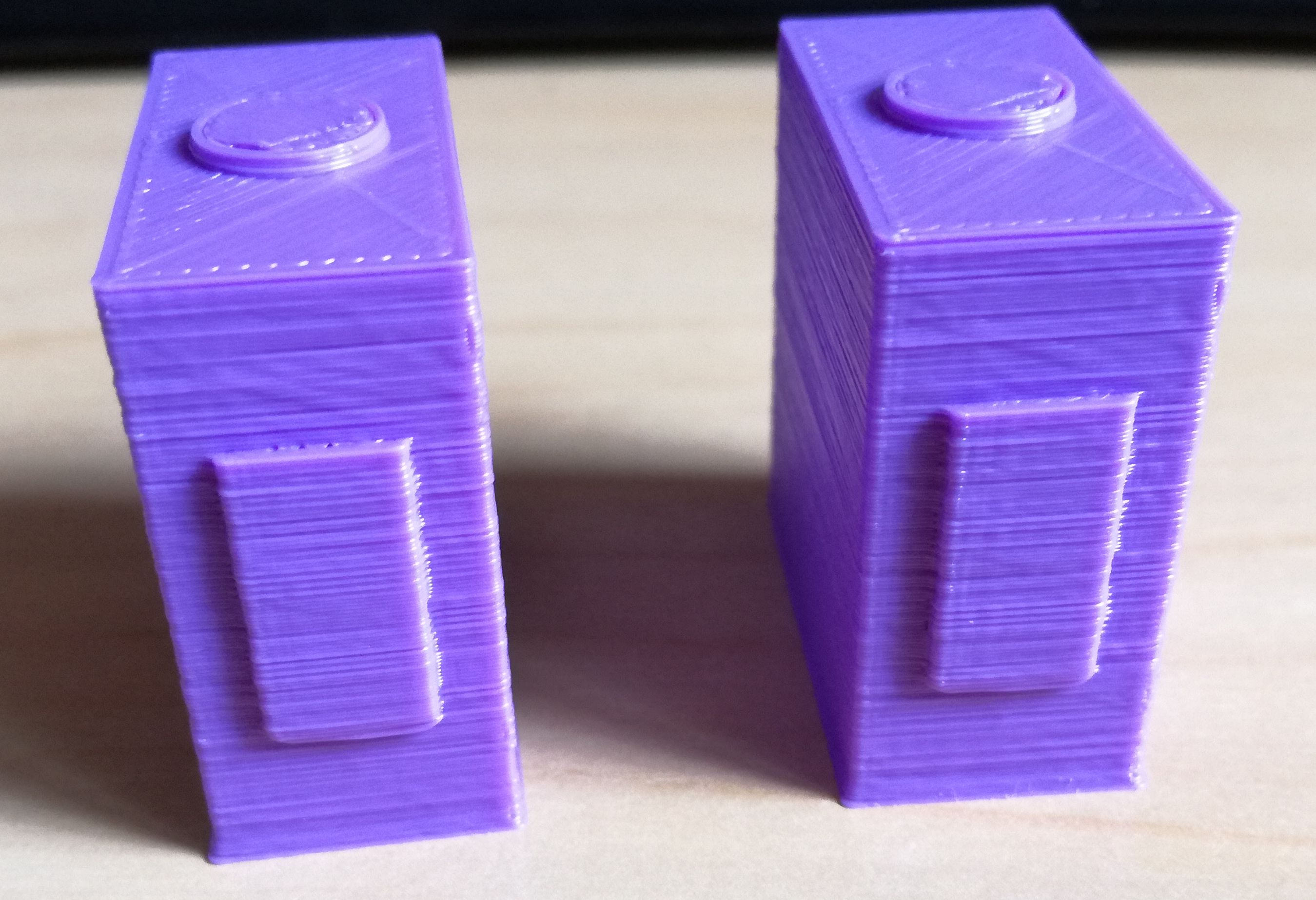

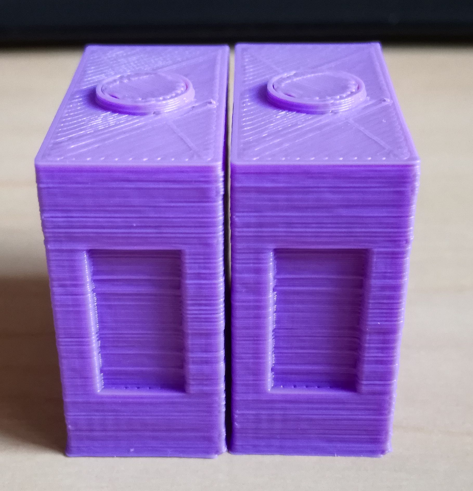

Ok,
Here's the result with the test model provided from Neotko.
Again on the left is the one with the UMO original settings and on the right the one with the modified settings.
Left--> Accel: 4000 & Vxy-jerk: 20
Right --> Accel: 3000 & Vxy-jerk: 12
To me they still look identical. Am I missing something?

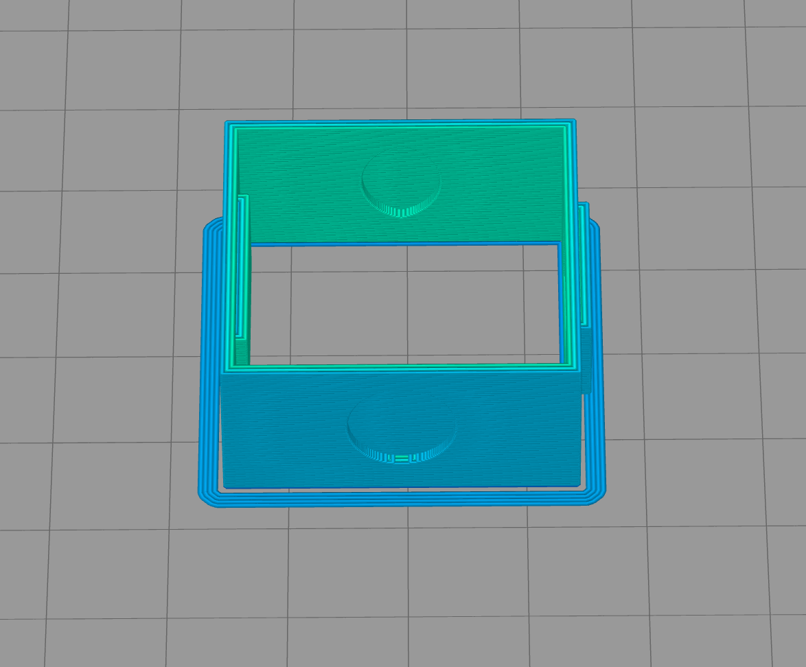

Umm it should print rotated... I'll search photos of the um3 tests

Hi antiklesys !
Seeing the photos, it seems you have also a Z problem !?
here it's done with the UM2 , the under print shows the improve by lowering the acceleration and jerk settings
I think with UMO you can get something close to that, Neotko would confirm ?
Ummm I should have explained how to print it... Give me 1h guys =)
I'm curious why the top of each of his prints look like combing issues?
