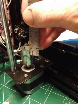

1) measured top depth of shaft that will go into the flex-coupler, insert threaded rod just down to the first 'cut' in the coupling and torque set screws
measuring rod depth into coupling

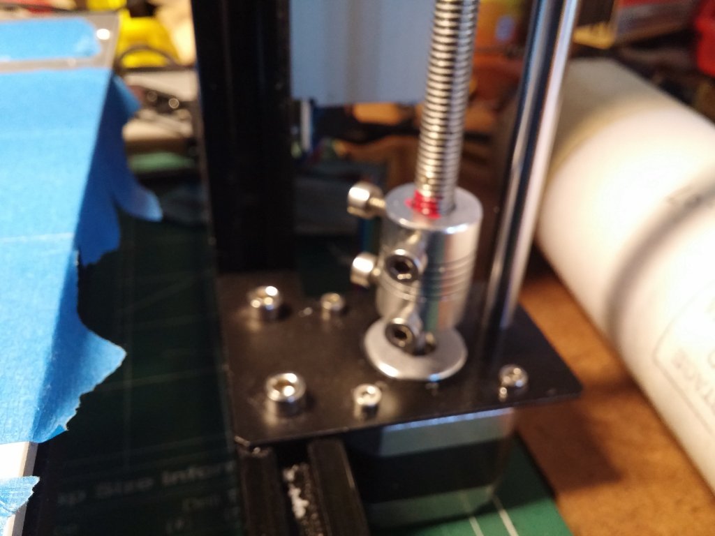

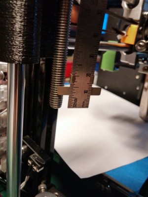

2) Mark the shaft depth:
mark rod depth
mark rod depth
Done:
Z-axis rod properly inserted into motor coupling

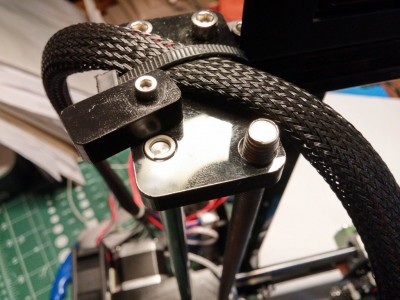

4) took a split washer and inserted it as a pre-load/shim to put pressure on the smooth rod under the top bracket plastic retainer to keep pressure on the smooth Z-axis shaft, this 'should' maintain shaft position and it has so far. You will also see now the Z-axis threaded rod is extended PAST the top part of the upper rod holders. Do not like the design of the upper shaft retainer's, the will wallow out over time in the threaded rod hole. Some install bearings. However, proper procedure would to get perfectly standard M8 straight threaded rods (or real lead screws) and install modified top rod holders with a bearing to retain the threaded rod/lead screw.
Top view of rod holder
So far, this has worked well. Again, will be updating the z-axis assembly to a true leads screw and bearing setup in the near future.
