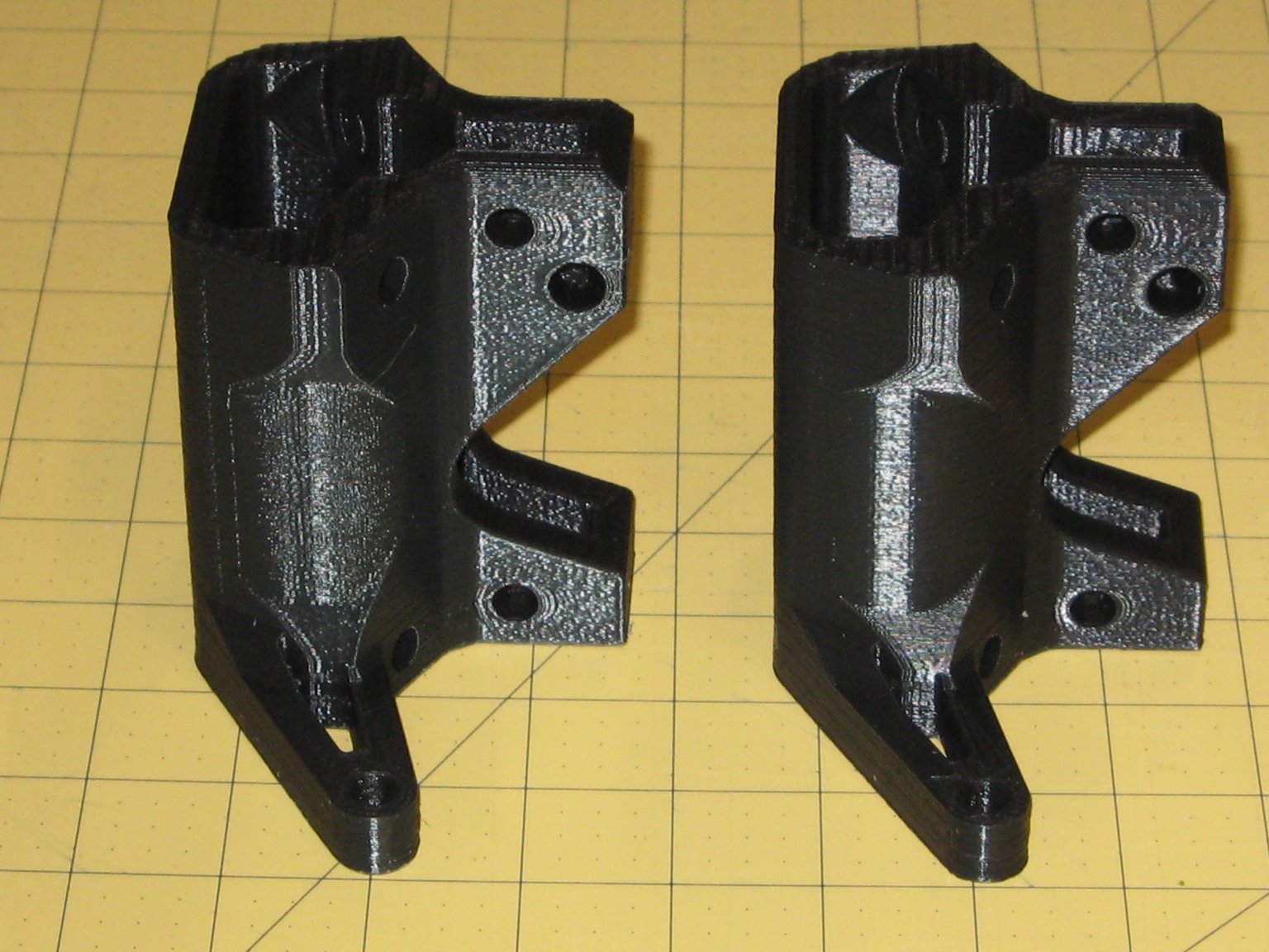

Oh yes I have posted a texture difference when using Octoprint > Octolapse recording feature results below
The above image shows a part printed using Octoprint > Octolapse Part on left that, the print on the right was 3D Printed without octolapse > Octoprint.

Yeah I wonder if some of that is the board is getting over flowed with data in the USB uart too

Re: Have a problem, need some ideas on how to fix
I use 3B+ boards on my printers and have found that if I move to a designated location when using octolapse, that I get increased stringing. I print in petg and it is enough of a problem as it is. So when using octolapse, I just do the snap at layer change with no move. It helps.
