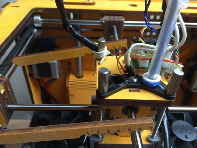

Looks like I found a calibration issue

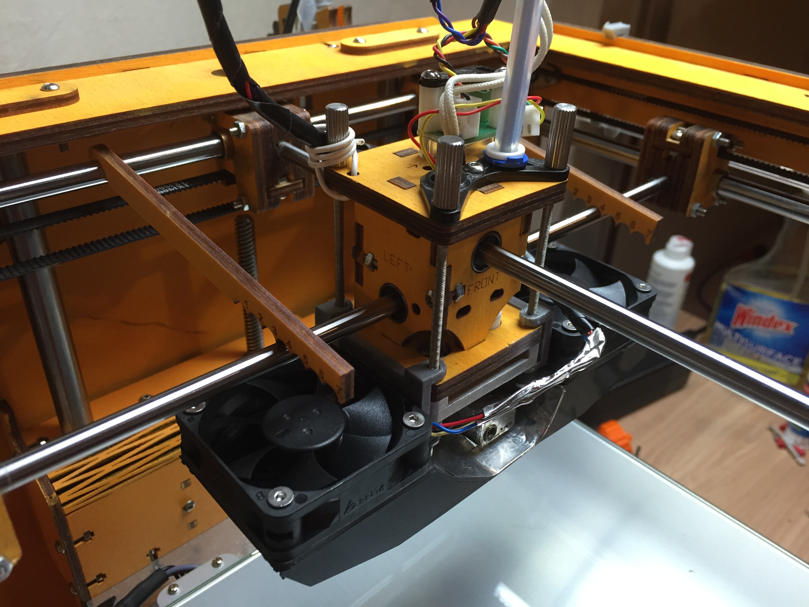

I figured I would pull out the alignment pieces for the pulleys to see if I am way out of calibration on X and Y
Looks like I am!
This ever happen to other UMO owners? I wonder if a set screw got a tad loose? Seems easy enough to fix from the assembly guide tips

Re: Looks like I found a calibration issue
Should the number on the guide used to calibrate one axis be used the calibrate the next? I think so
There is no other purpose for the numbering than facilitating the alignment...
Okay, but i thought i saw in a video...maybe Neo had linked it in from his upgrade, that the same number should be used for each axis?
Doesn't matter, you just want them to be square.
Yes! Now watch the video, they say (in TWO languages) to use the same marking!
I hate to admit this...I don't remember doing this when I built the printer!
No no no, you get it wrong
They just say "the same notch on both sticks" when you do a side (obviously, if you don't take the same notch it will be completely screwed
Okay....perhaps i can make my printer happy again
