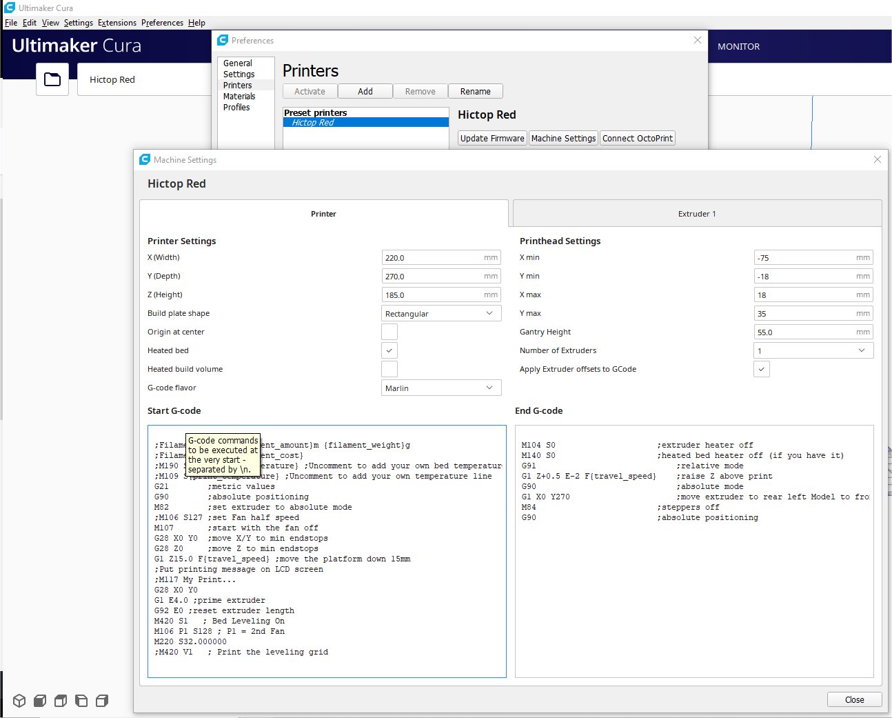

In Cura Click on Preferences select Printers
Select Machine Settings.
You will see the settings used in my Hictop 3D Printers
Below is the code line you want.
Code: Select all
G1 X0 Y270 ;move extruder to rear left, Model to front.
