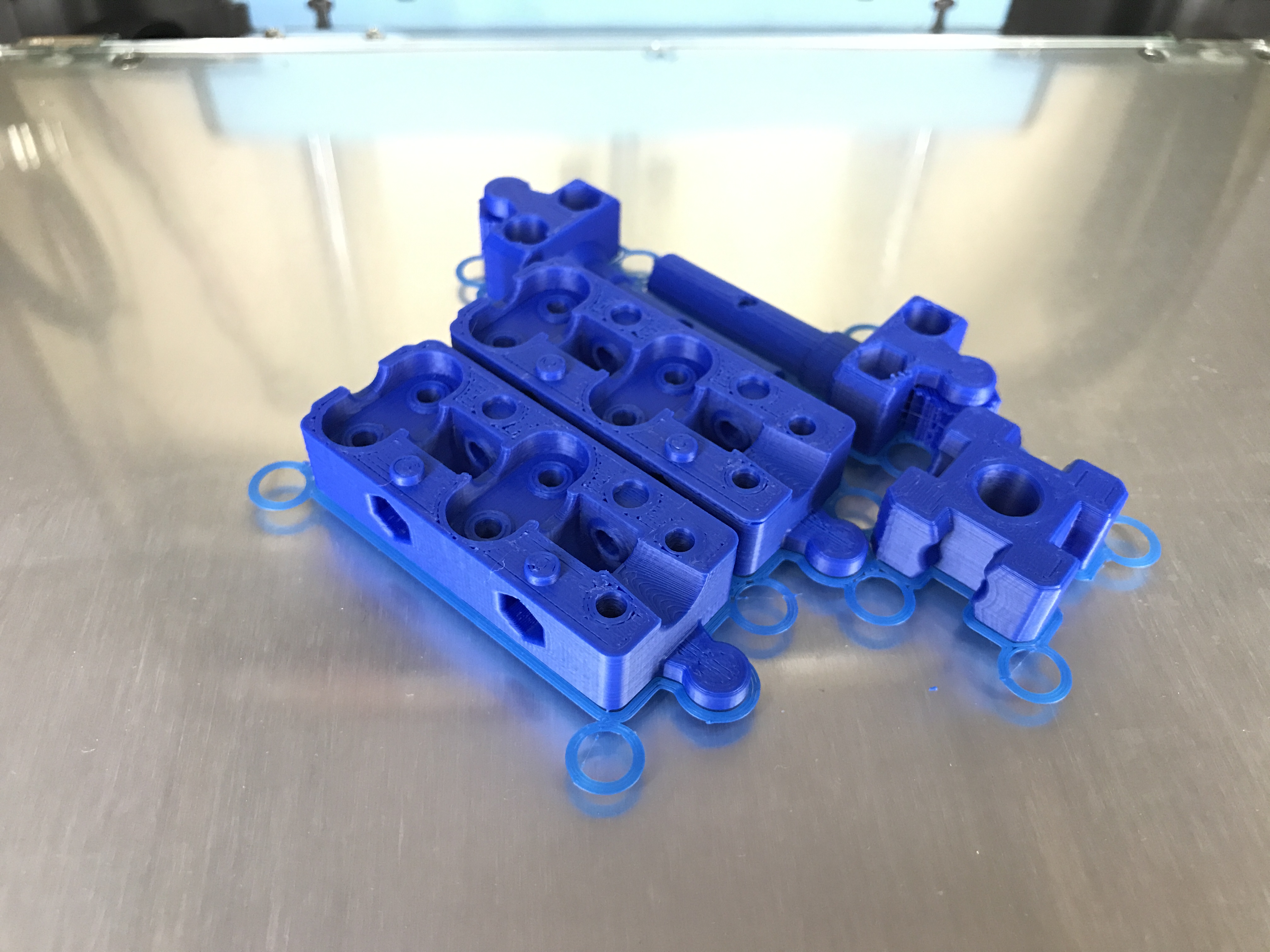

Use skirt with 0.20-0.30 separation and use my Skirt trick to reinforce the corners. It will leave a perfect print.
https://ultimaker.com/en/community/3931 ... it-on-cura
Also remove some fan power for slow printa that need highlayer quality. I mean, platec/greentec prints better overhangs since it has a higher glass temp so it cools faster since is easier to move something from 200 to 100C than 200 to 50C (normal pla). So it can do much better overhangs with much less fan.
Like this:
The print shows gaps and under extrusion because I was playing with a s3d option to remove blobs. So yeah, it looks weird. But is a good img of what I mean by brims and custom brim reinforced.
