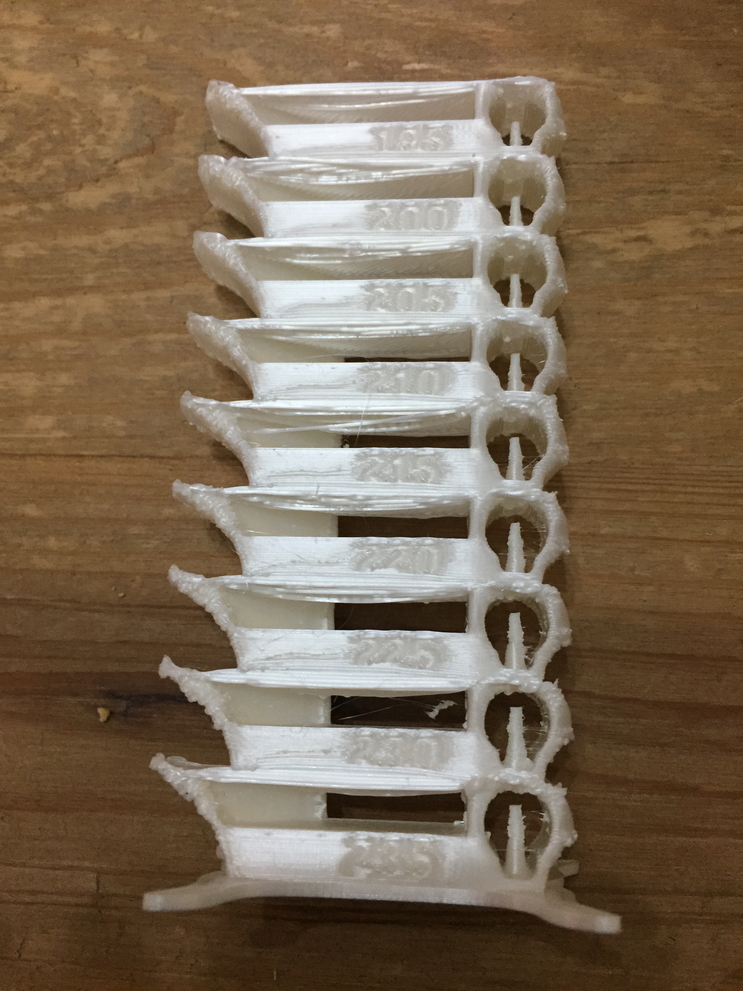

I've printed a temp tower, 235-195.
I think about 215 seems to be the best, but there isn't much to choose from any of them.
Lez
Posts: 3970
Re: Print quality suddenly gets worse
Wow the bridging is really bad. Is the part cooling fan working?
The edges are very blobby. Is the esteps right? Tension good?
What about a different PLA?
