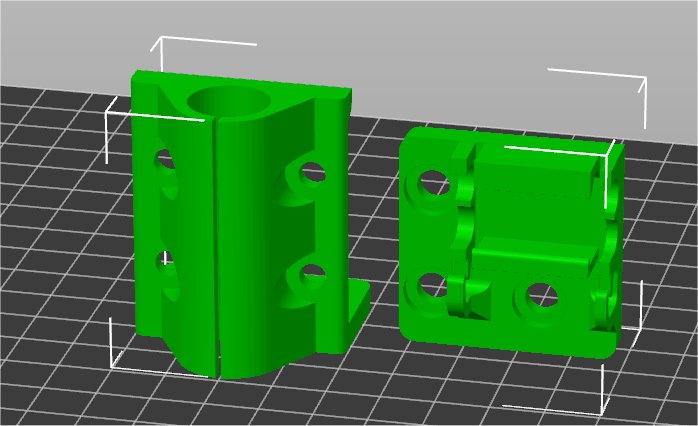

Not too bad learned how to use Design Spark Mechanical Program in a few hours.
Learned how to export the STL files no more problem.
May be slow but there is nothing I cannot self teach myself.
I now have access to a Complete set of 3D Printed Parts

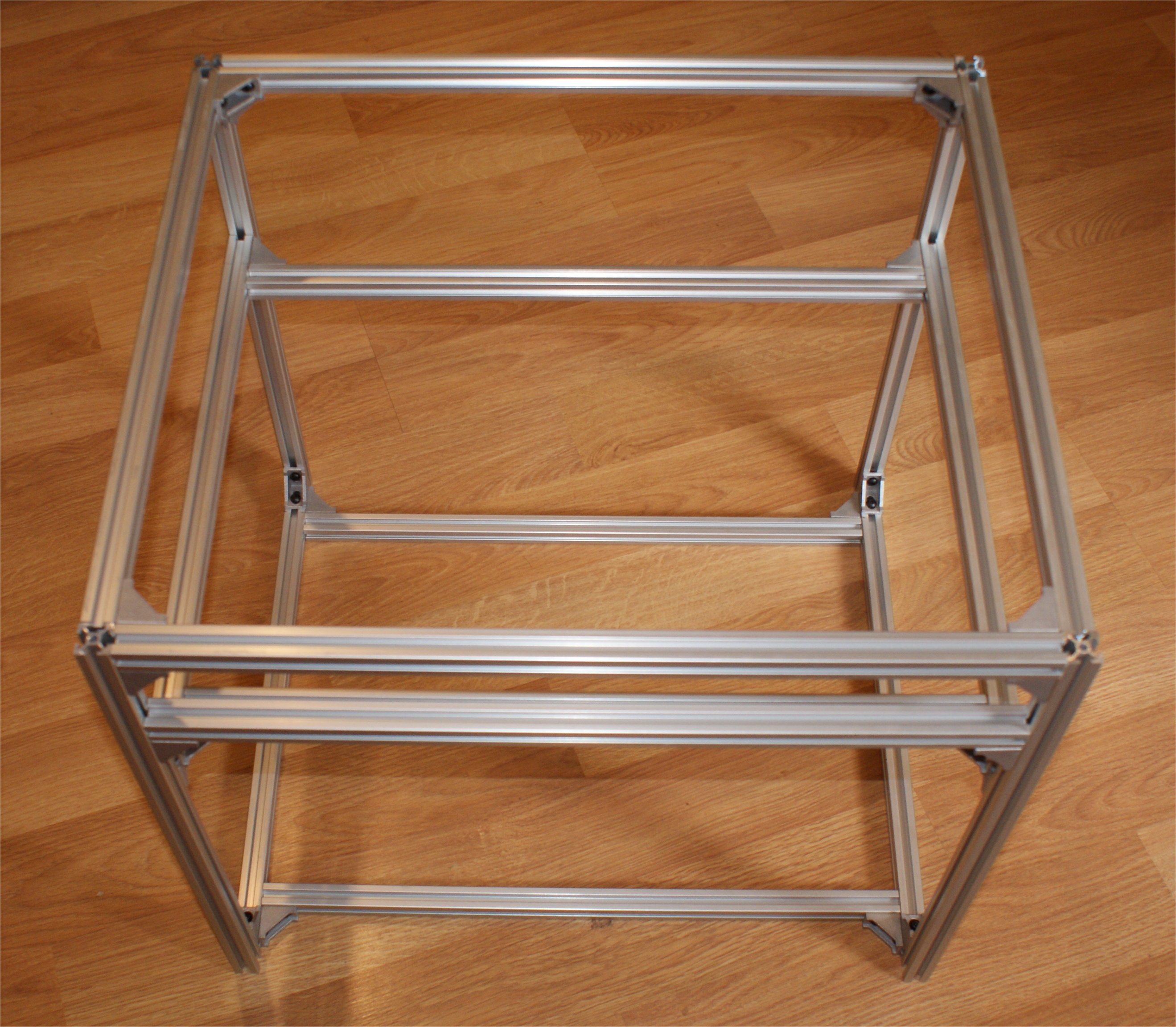

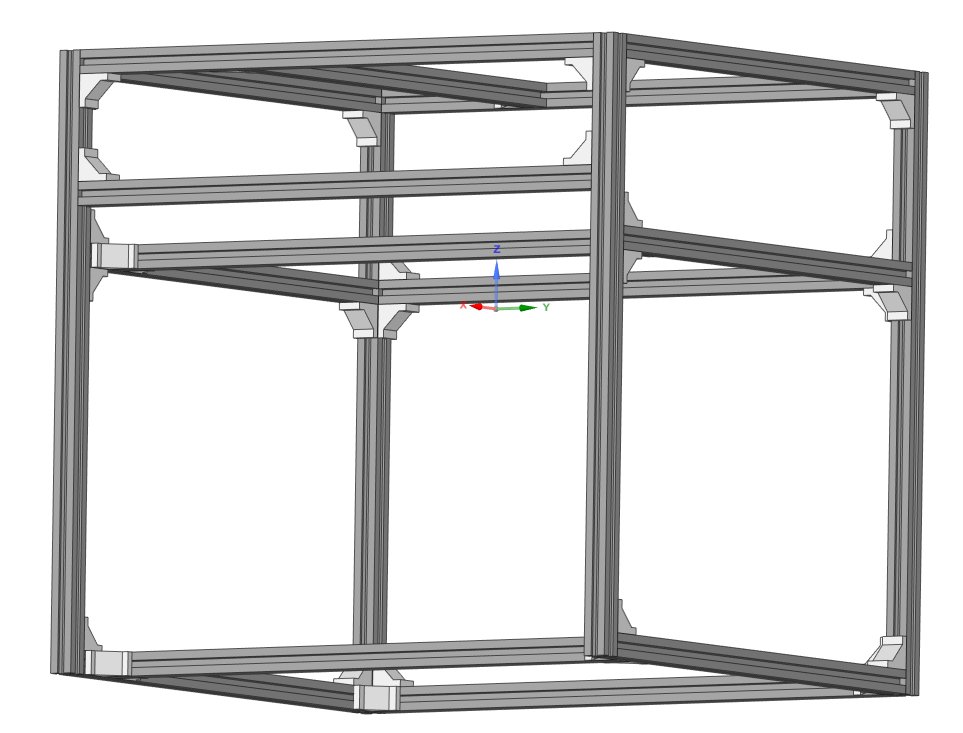

Frame parts arrived, could not wait I assembled the basic frame.
Posting both the original and mine with changes.
I will need to fine tune design it looks very good though will need to 3D Print models to see how every thing will fit before posting any measurements.
Decided on having dual Z-Axis stepper motor to eliminate the cantilever effect.
