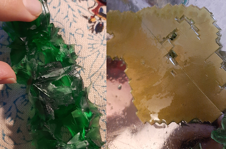

1- from my first Print I have a Line, seems like the model is cut on Y axis, in some prints, it's really noticeable and seperated,
2- in my last experiments, the right half of the model was dispart platform during the print, just wanted to know any way to avoid it and keep the model keep connected to the top platform? and as I hear, when the platform wants to go a step up, it sounds like the model is stick hardly to the glass and making a sound to separate,

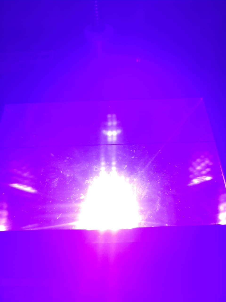

My first thought about the line across the part is that the LCD screen has a fault. I don't know your printer but is there a way to test it without the tray in position?

You're totally right! last night I turned on the LCD and look at it, there was a line still in black!
I have Creality LD-002H and had this issue since my first print, Already contacted the seller, waiting for their response.
