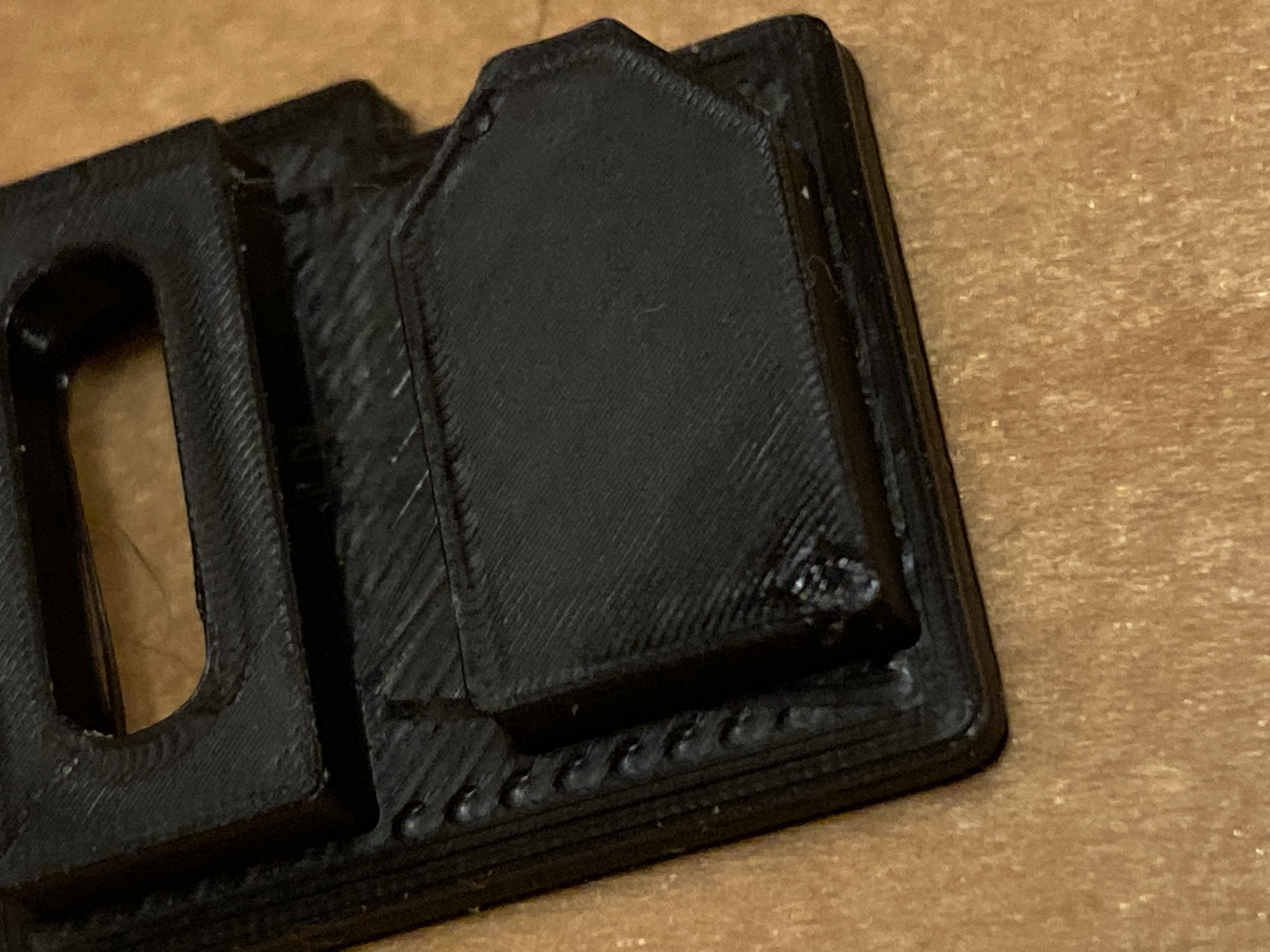

Hello and Happy New Year everybody.
I’m using Cura and ironing which is giving a great surface finish except for the finishing corner where the pla is forming a slight lump which appears to be more shiny than the rest of the surface.
Anyone have any suggestions to help me achieve a uniform ironed surface?
Printer is a Voxel Monoprice.
Thank you.
Cura ironing blob at finish point

Re: Cura ironing blob at finish point
Thank you Sir.
I did add a similar piece of end G-Code which moves the nozzle away from the model as soon as the print completes.
Looking at the model, it does appear that the nozzle converging on the corner would likely concentrate the heat in that area causing the shine and blister.
I took a closer look at the G-Code to see if I might speed up the nozzle towards the end, maybe I could even reduce the temperature but I’m not sure if the printer would wait until the nozzle cooled before proceeding thereby spoiling the ironing in a different manner. Anyhow, this route would doubtless be steeped in trial and error - good job I’m the most tenacious person I know
I’ll get back on it tomorrow!

- Posts: 3981
Oooh that's a ugly burn / melt spot. I'm betting Clif's suggestion fixes you
