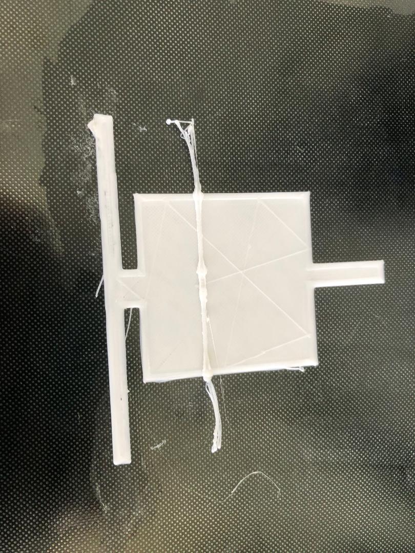

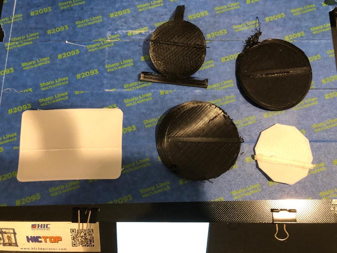

Hi all, Have 2 Hictop dual extrusion printer. They have been printing simply beautiful prints until recently and have completely gone off the rails
Attached are pics of one of the great prints and the others are of what has been happening lately
Lays bottom layer and next 3-4 layers no problem, no adhesion problems, then they start either printing layers off skew or, and this now happens all the time, starts printing a horizontal line across the middle of the print (as per pic)
Has anybody got any ideas as to why this is happening and how I can fix it - PLEASE
Hictop Printer gone off the rails
