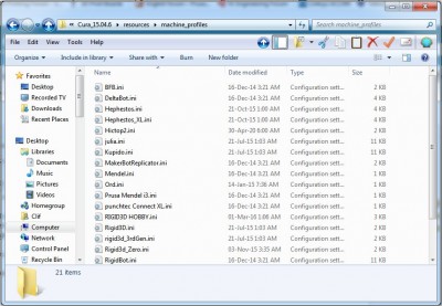

I was using the oldest Cura 15.04.6 and after creating the Profile I simply added it to the list
C:\Program Files (x86)\Cura_15.04.6\resources\machine_profiles
