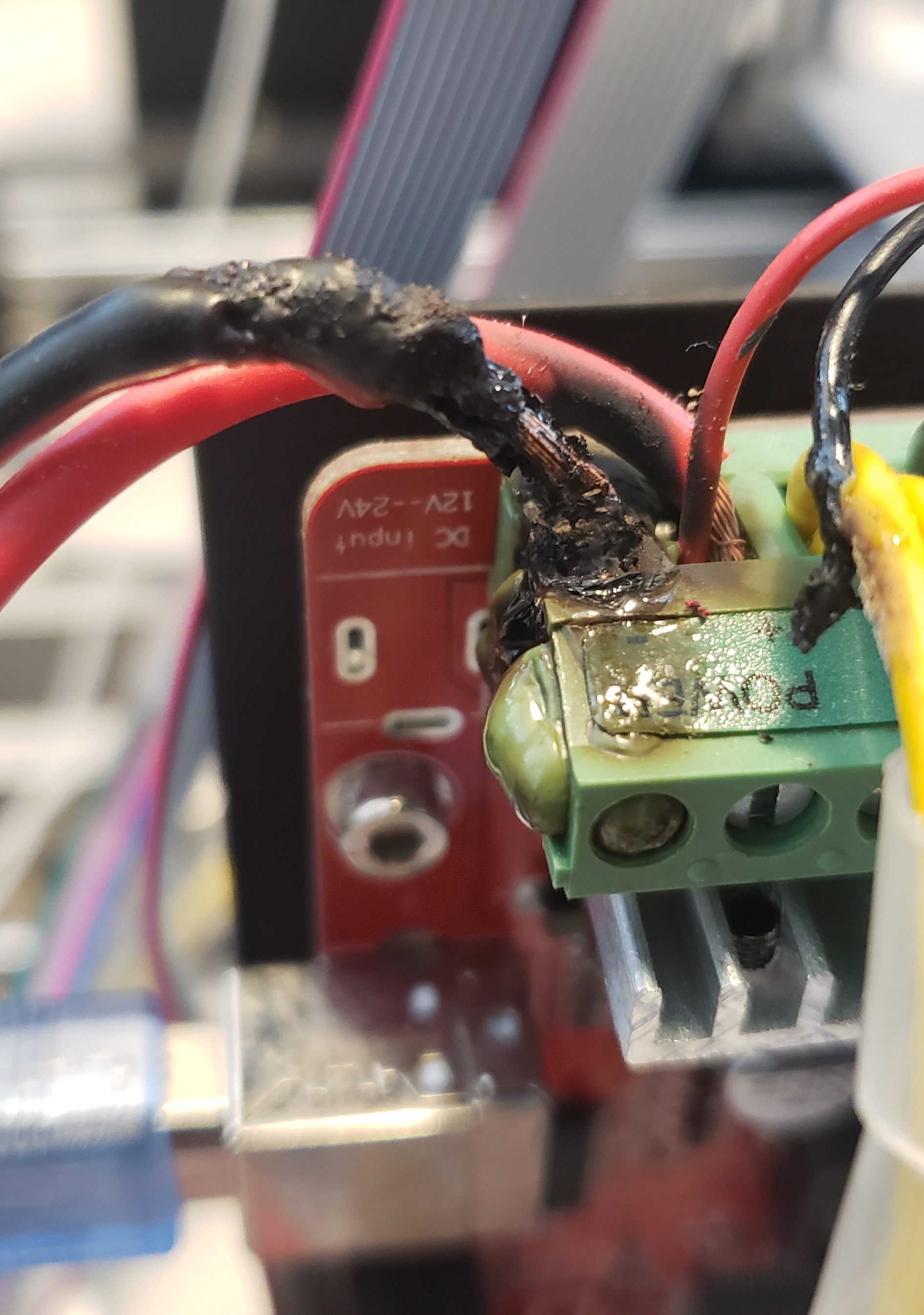

My trusty 3DP-12 finally had a meltdown on the control board. I hit a thermal runaway error, and while diagnosing why the hotend fan was dead, I found that the power supply wire into the control board was completely melted through (see the picture).
Everything is original(!) and it's been running fine for like 5 years now. So the decision I need to make is:

My vote it to get an SKR V1.4 (turbo) as they are relatively cheap, have a more memory than my original, can be configured either 12 or 24V and it is very easy to use VSCode to make changes in the firmware to add features etc.
If the rest of your mechanics are good, replace the board and the necessary wiring between the power supply and the board. NOTE: This probably happened because of a loose connection or possibly undersized wire. The wires on my printer when new were undersized and got quite warm to touch so they were upgraded in size and we check all the power connections semi regularly. Also, it would be a good idea to pick up a ferrule kit that can be found in the usual suspect places.

Your .03 cents is exactly what I believe. Never had the problem myself upgraded all wiring from day one.Country_Bubba wrote: ↑June 12th, 2021, 9:26 am My vote it to get an SKR V1.4 (turbo) as they are relatively cheap, have a more memory than my original, can be configured either 12 or 24V and it is very easy to use VSCode to make changes in the firmware to add features etc.

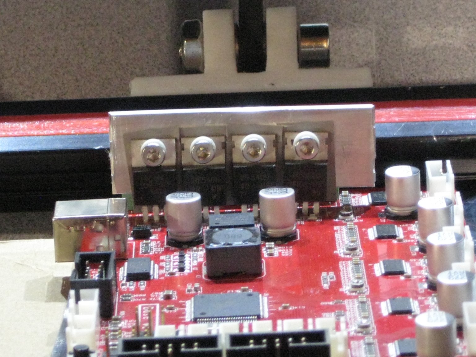

My problem was wiring a stepper motor incorrectly and blowing the stepper motor drivers on two boards.
Second I installed a bar heat sink for cooling on Mosfets plus a cooling fan.
